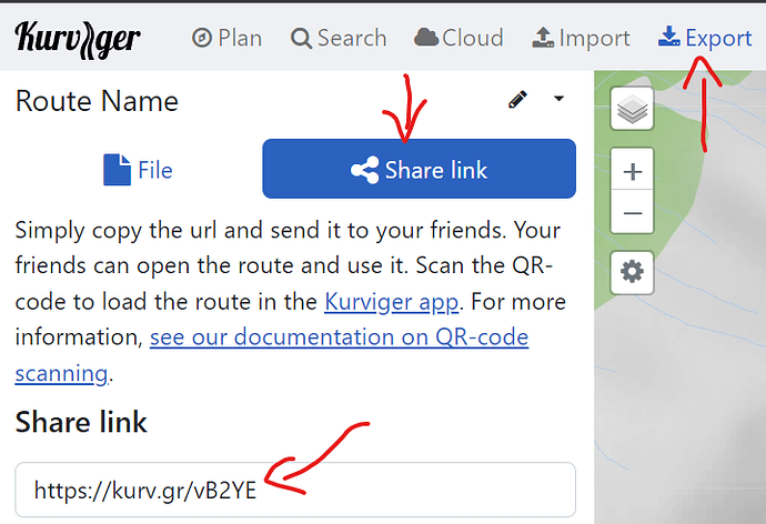

Please share a route link - without that analyzing is impossible.
https://kurv.gr/PZW4u

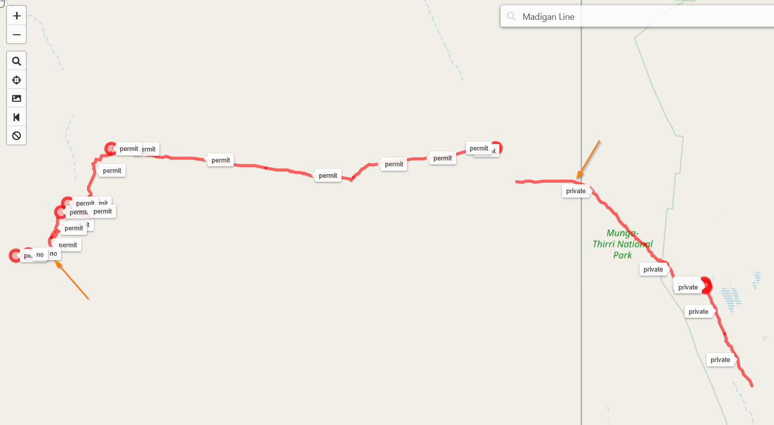

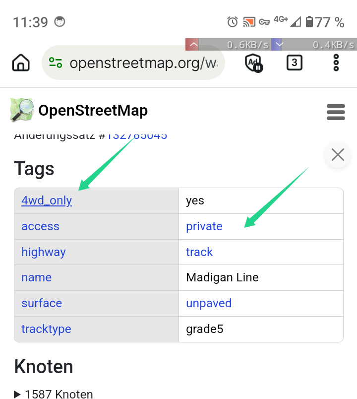

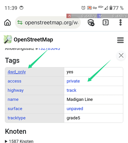

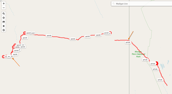

I have checked with OpenstreetMap - Overpass. The picture shows segments of highways mit name “Madigan Line”. The little label shows the tagged access property. In the west there are some minor parts tagged with “no”, most with “permit”. In the east all is tagged with “private”.
Defintion for access = permit: Open only to persons who have received authorisation granting them access. This permission is typically granted. (Kurviger can use)
Defintion for access = no: The object is not accessible to the public or its use is prohibited
Defintion for access = private: The object is not accessible to the public.
I do not know if you are familiar with OSM. in case you think this is wrong, or there is also a part missing between west and east - it is probably the best way to contact the involved mappers, as local knowledge is required.
Or: the openstreetmap-forum oceania might be able to help.
