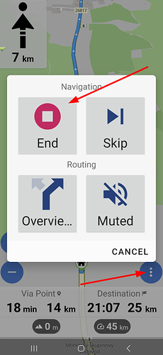

In such a case you may stop the navigation - “3 Dots Menu” and the “End” button
[details=““3 Dots Menu” and the “End” button”]

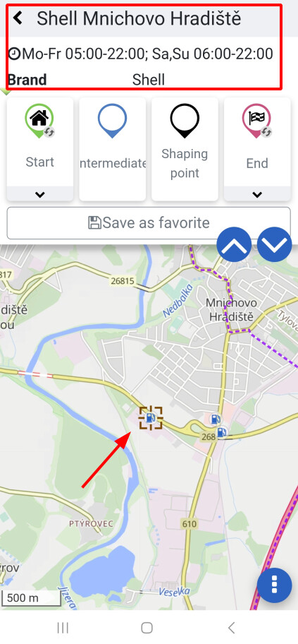

Yes, adding waypoint directly from the navigation is not possible yet, but you may stop the navigation and add the gas station in the planning mode and then restart the navigation.
When clicking on the gas station POI symbol in the planning mode, you can see some information about it and if you add it into the route, you will see the coordinates as well, which may be used for further queries e.g. with Google Maps.
Gas station detail

Il est bien sûr possible d’arrêter la navigation, appuie sur le bouton avec les 3 points dans la partie inférieure droite pendant la navigation et sélectionne ‘Quitter’.

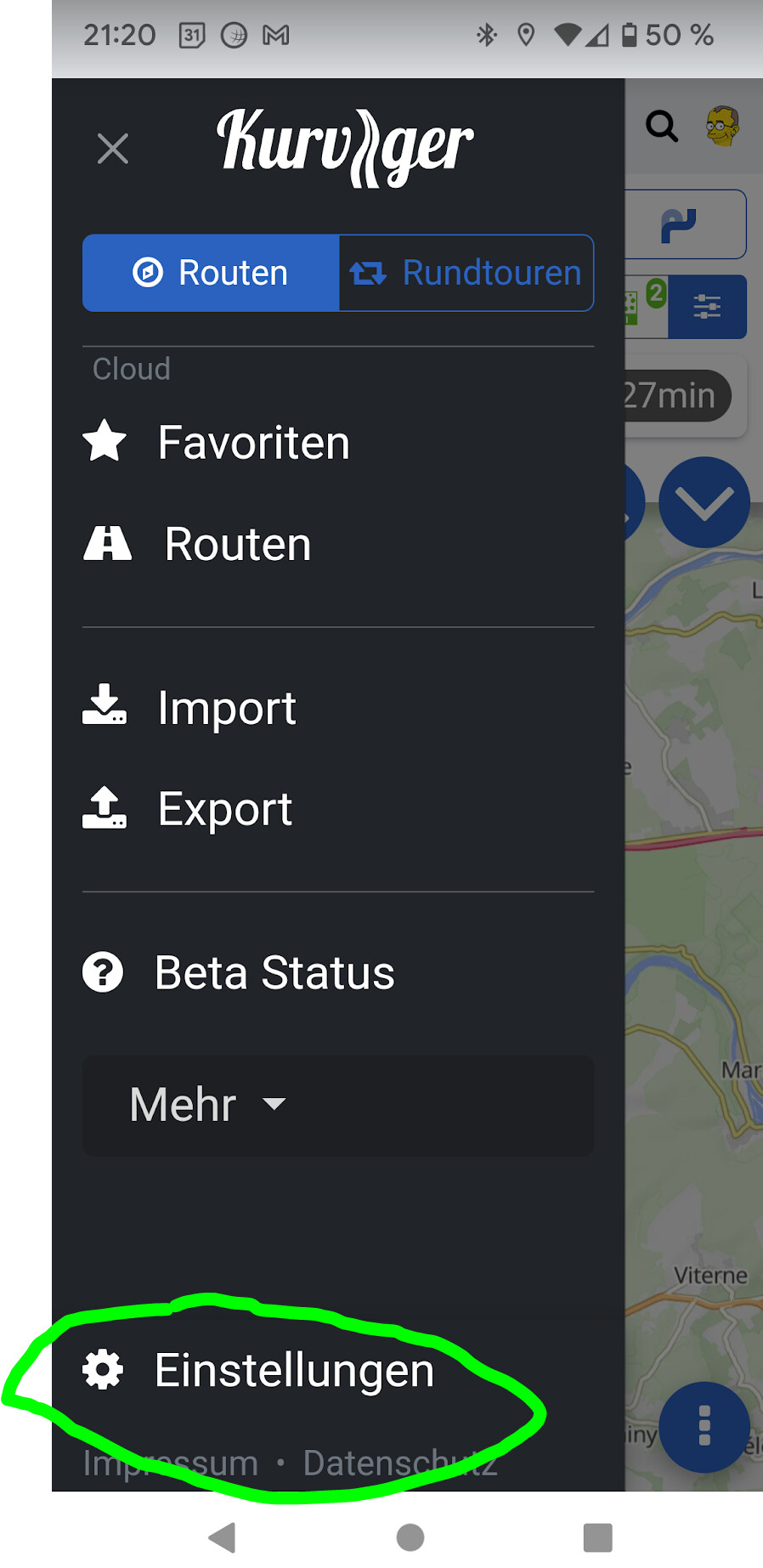

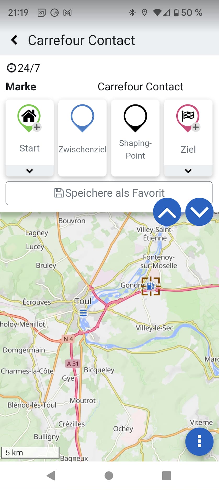

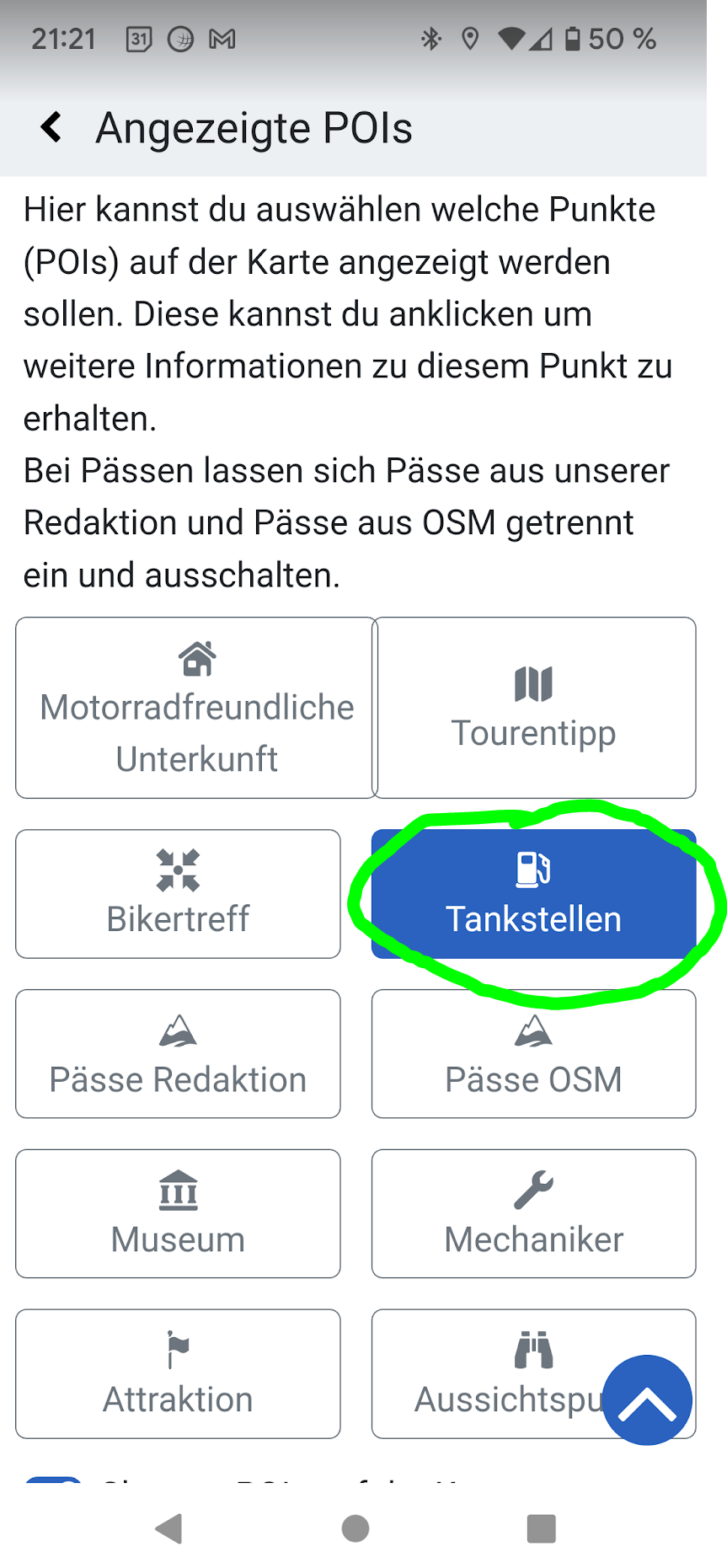

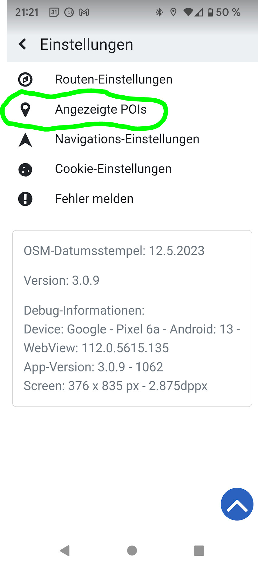

pour trouver des stations-service, il suffit de le sélectionner dans les paramètres :
Si tu tapes ensuite sur la station-service dans l’application Kurviger (important : terminer la navigation avant !), tu obtiens une indication sur le type de station-service

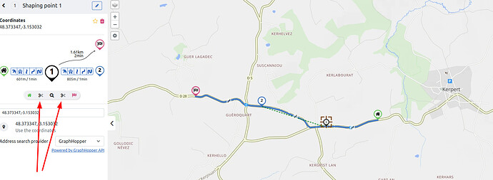

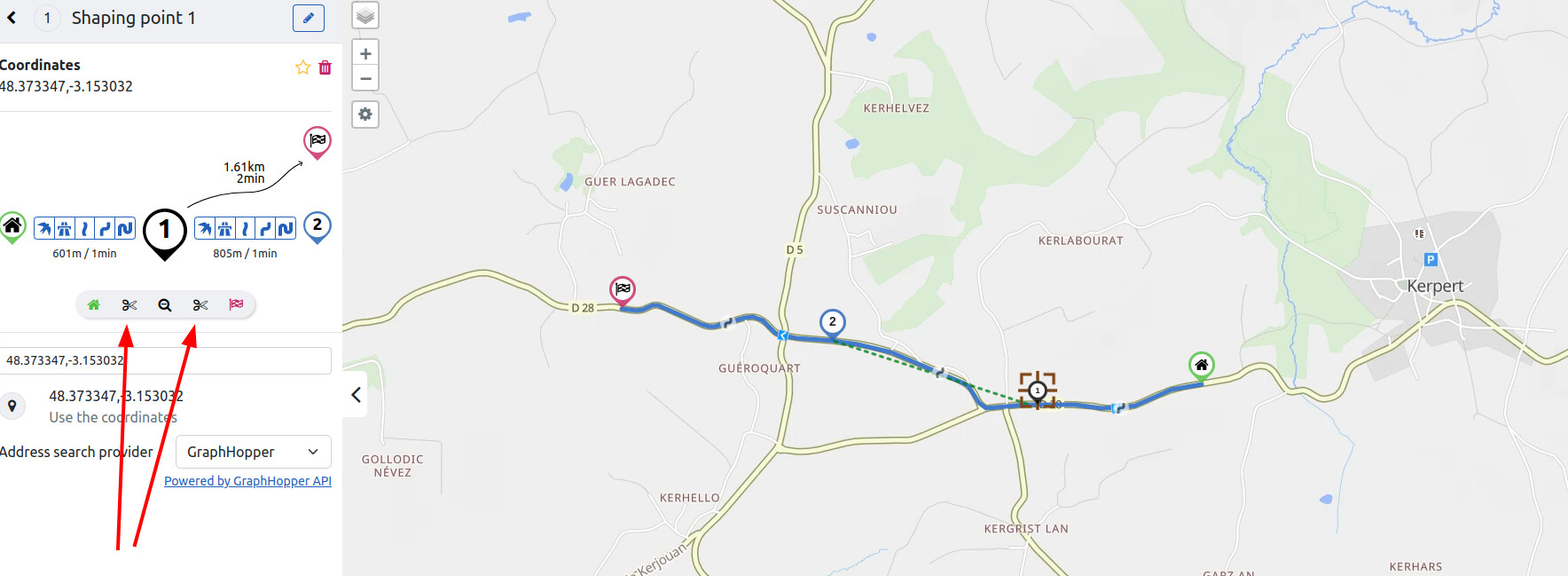

I cannot see much from the .gpx . If you have the (full) original route, you may cut a part from it using the scissors at points, after clicking at point (if you hoover over the scissor with mouse pointer, short explanation occurs)

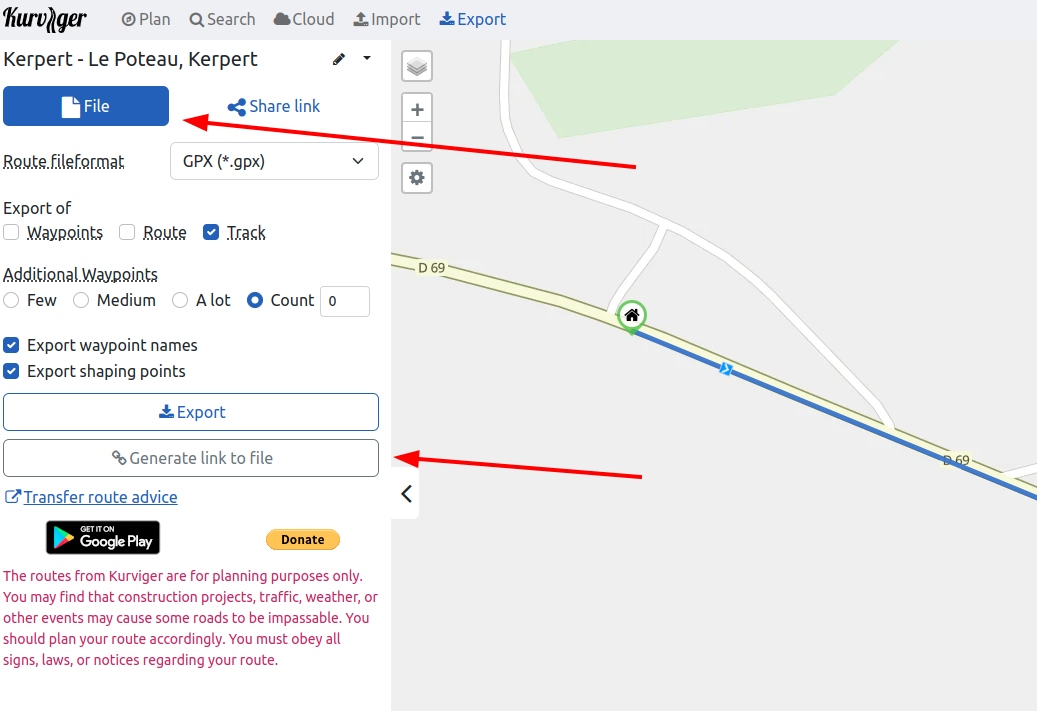

The best way how to share the route ist “Export” and “Share Link”
Export & Share
It is possible from the App as well and it is share altogether with exact route settings, so the possible reasons are easier to identify.

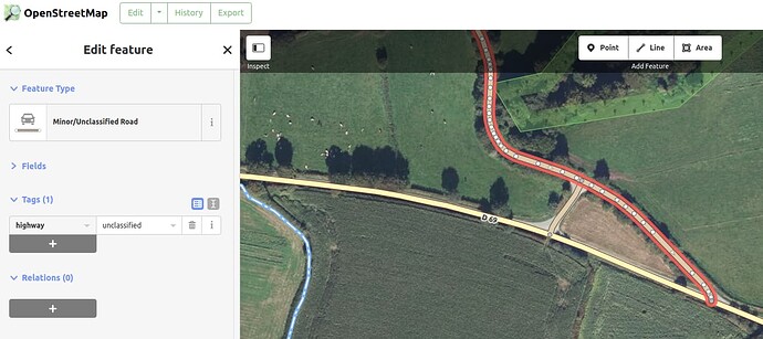

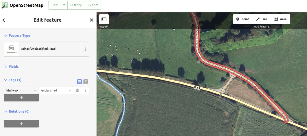

That looks quite weird, that exactly the avoidance of narrow roads forces the routing to do this.
My guess would be, it is something in OSM data, but regretably I am not an OSM expert to find it out.
What can I see is the “straight road” is marked as “tertiary” with no other information in “Fields” except not being one/way:
straight road
The “unpaved detour” is marked as minor road, in my understanding it is “below tertiary”
unpaved detour
I can change the surface into “unpaved”, which is true, if this changes something in the routing (within 2-3 days).
The next street is tagged the same, but is not taken as detour (possibly due to the junction?) even with highest narrow streets avoidance strength.
