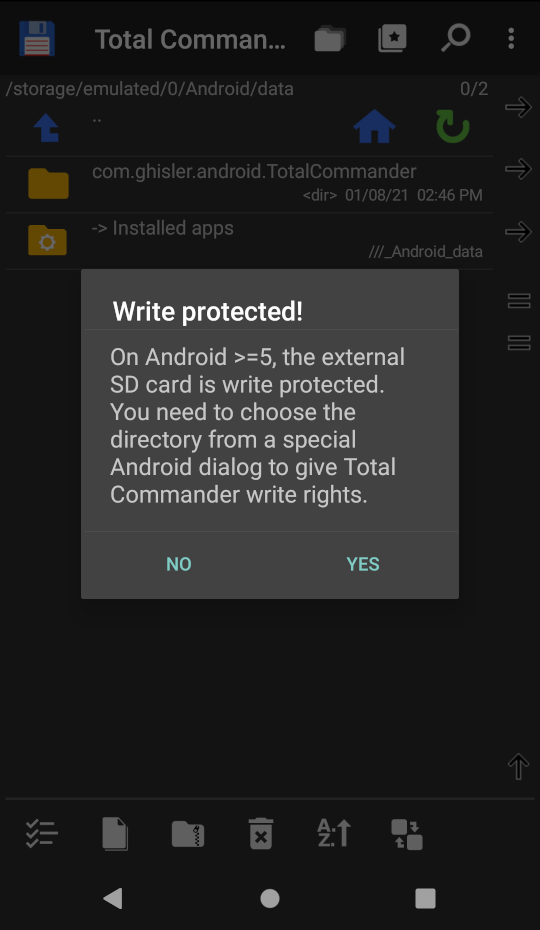

What device and Android do you use?
On a newer Android the application folders are no longer accessible to other applications.
Though Total Commander usually asks user for a permission and then can access them.
Samsung S20+ / Android 11
Newer Android does not allow the apps to access other app folders.
If you tap the “Installed apps” then Total Commander asks for permission.
If you grant it then you can find the app folders under the “Installed apps”:

Okay, wie bekomme ich die kurviger-smallroads denn rein in den BRouter? Der Total Commander zeigt mir einfach nicht alles an mit meinem Android 11 auf dem Samsung S20+

I wrote the solution for Total Commander above.
Or use Google Files app which should work everywhere.
