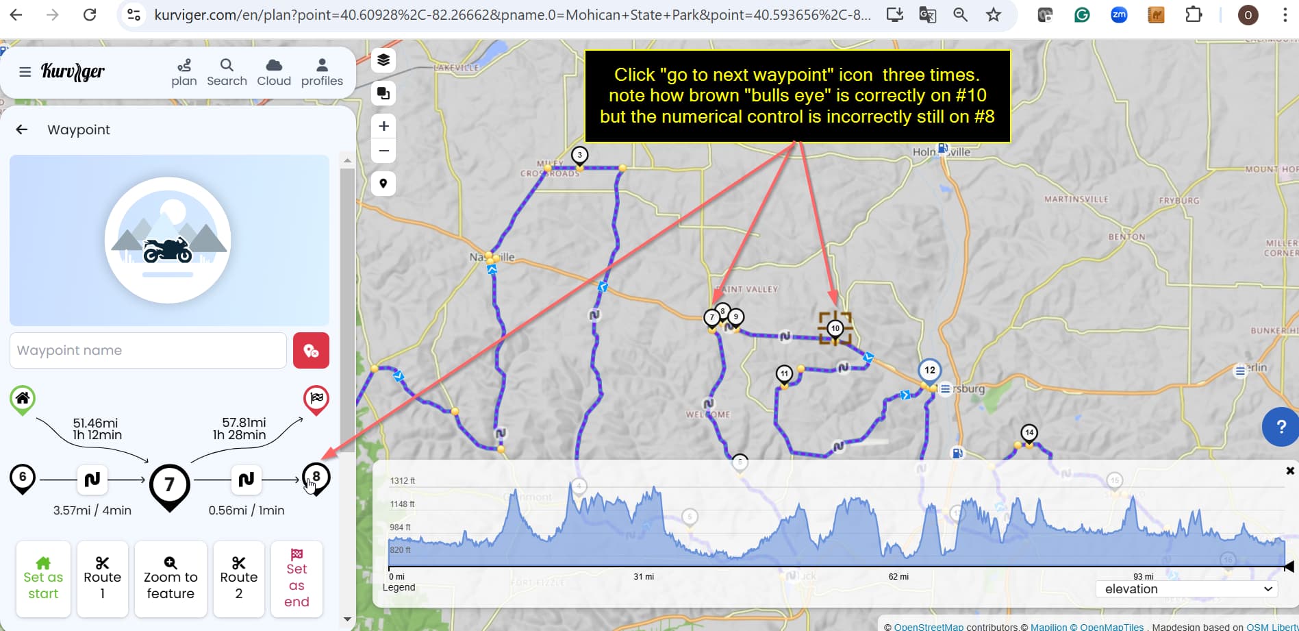

Bug report: "go to next waypoint" is incorrectly not advancing the number set
to demo the bug on your end.
pull up this ride.
expand the waypoint list then click on waypoint #7
you will get this screen (see image) click on the “go to next waypoint” icon three times.
you have reproduced the bug if the brown “bulls eye” is correctly on #10
but the numerical control is incorrectly still on #8

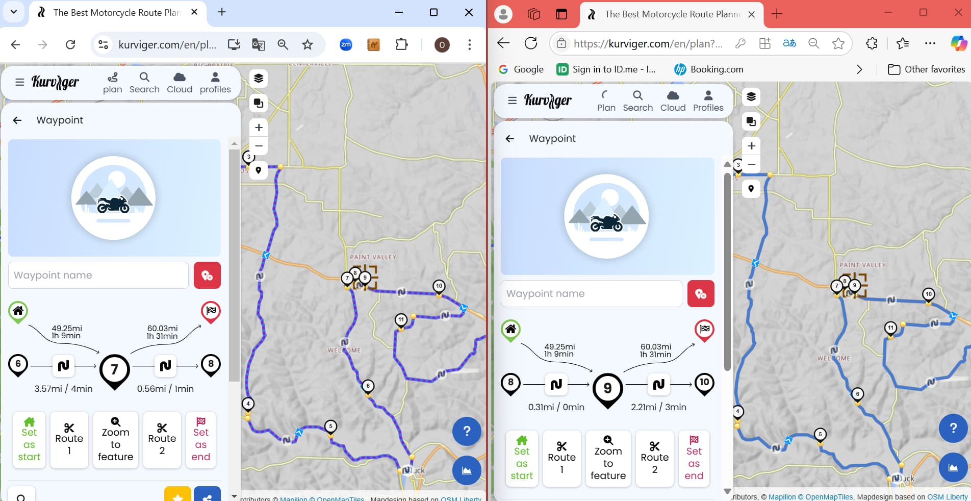

In the screen print below, the left side is the chrome browser, the right side is the edge browser.
for both I pulled the route for short code PQFcN
I then expanded the waypoint list on left side of screen as to find #7 and click it.
I positioned the map so that the brown bullseye was both visible and well as the area around 7,8,9
in each window I clicked the right most black circle twice (the control with the mouse over hint reading: “go to the next waypoint”).
In EDGE the brown bulls eye correctly advanced to “9” on the map and the control being clicked correctly advanced from 8 as to become 10.
however in chrome the brown bullseye correctly advanced with each mouse click. but the control being clicked incorrectly remained on its original number (8).
