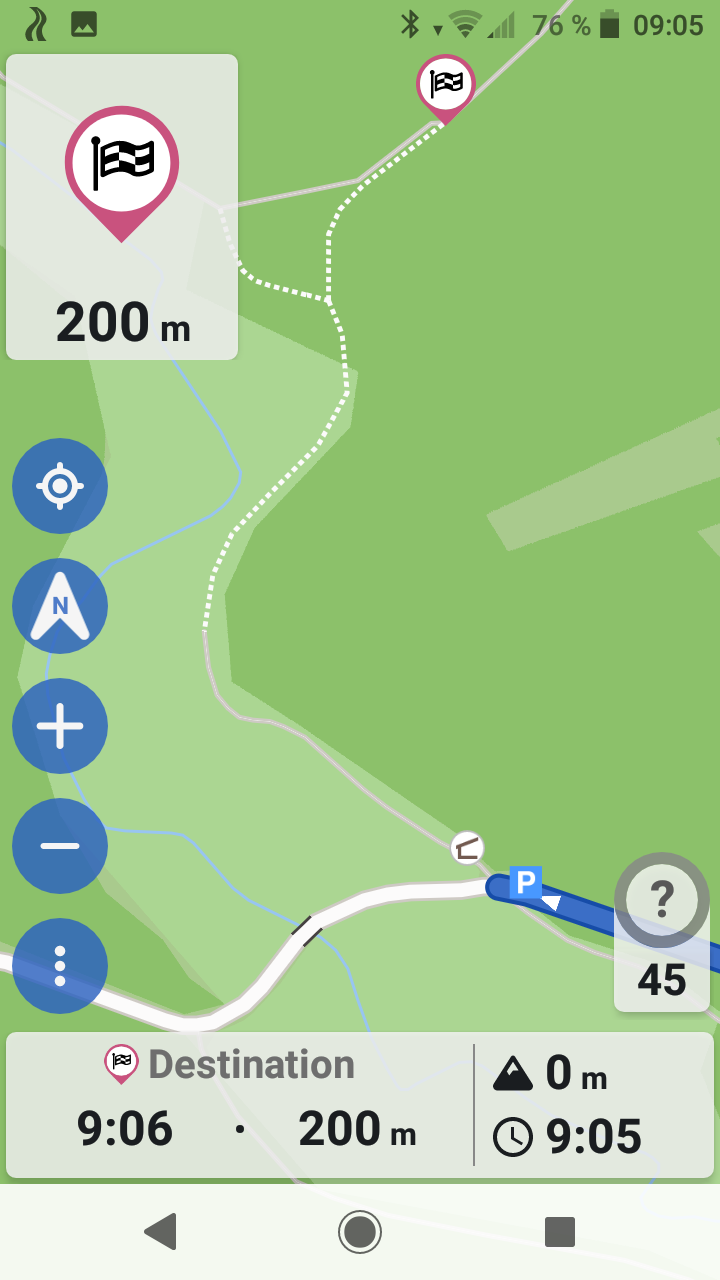

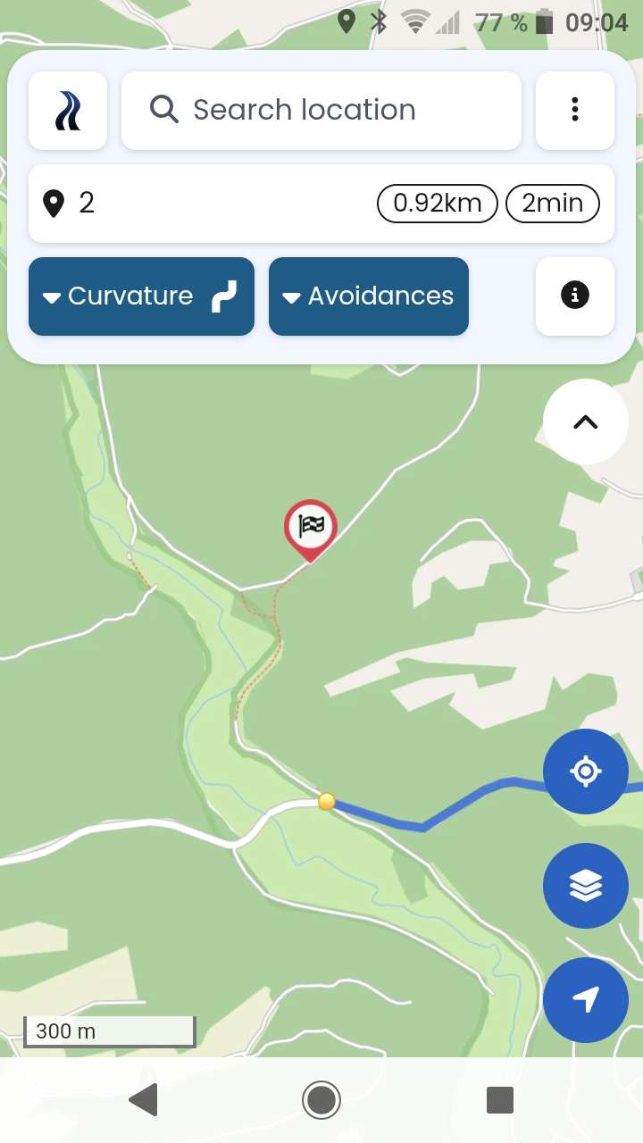

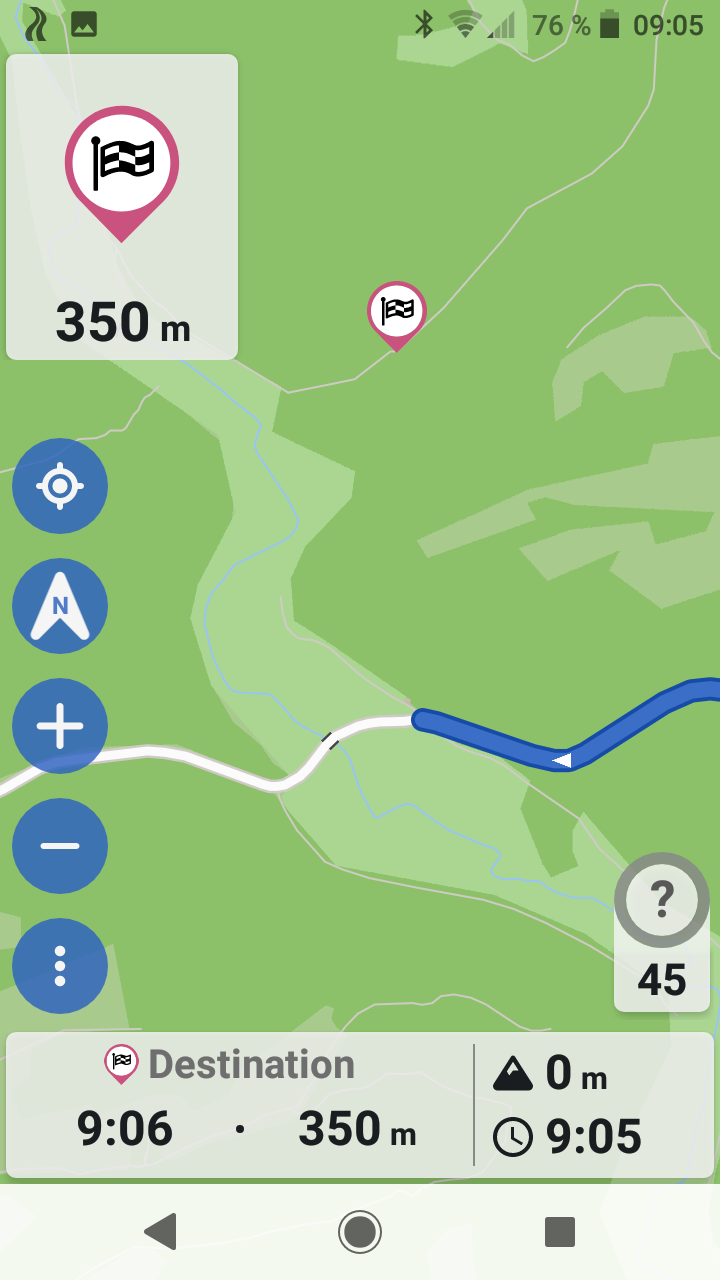

If you compare screenshots below, you will notice that the narrow track/path leading to the destination is visible but not routable in planning mode. On standard navigation zoom level, they are not visible, but if you zoom in - you can see them, just not so good.
What is not logical to me - the one track that in planning mode looks wider and is better visible, - in navigation mode is grey on green, which I can barely distinguish, even in ideal light conditions (with sun glare - forget it). The one that is in planning very thin with red-brownish dots (where I would likely not ride a motorbike) is much better visible in navigation as white dotted line.
Question for @boldtrn and @Kira - is it possible to make a different choice if colors for narrow roads and legally navigable off-road tracks (e. g., brown or dotted white might be better than grey). I just realized that I may have a better example with a navigable piece of track then those in the screenshots. I may post it later if you need another example.
I think the idea would be to make a clear and visible distinction on the map between roads where you could legally go with a GS and those you would want to stay on with a S1000RR. I think all the information is already there, just the visibility needs to be optimized..
