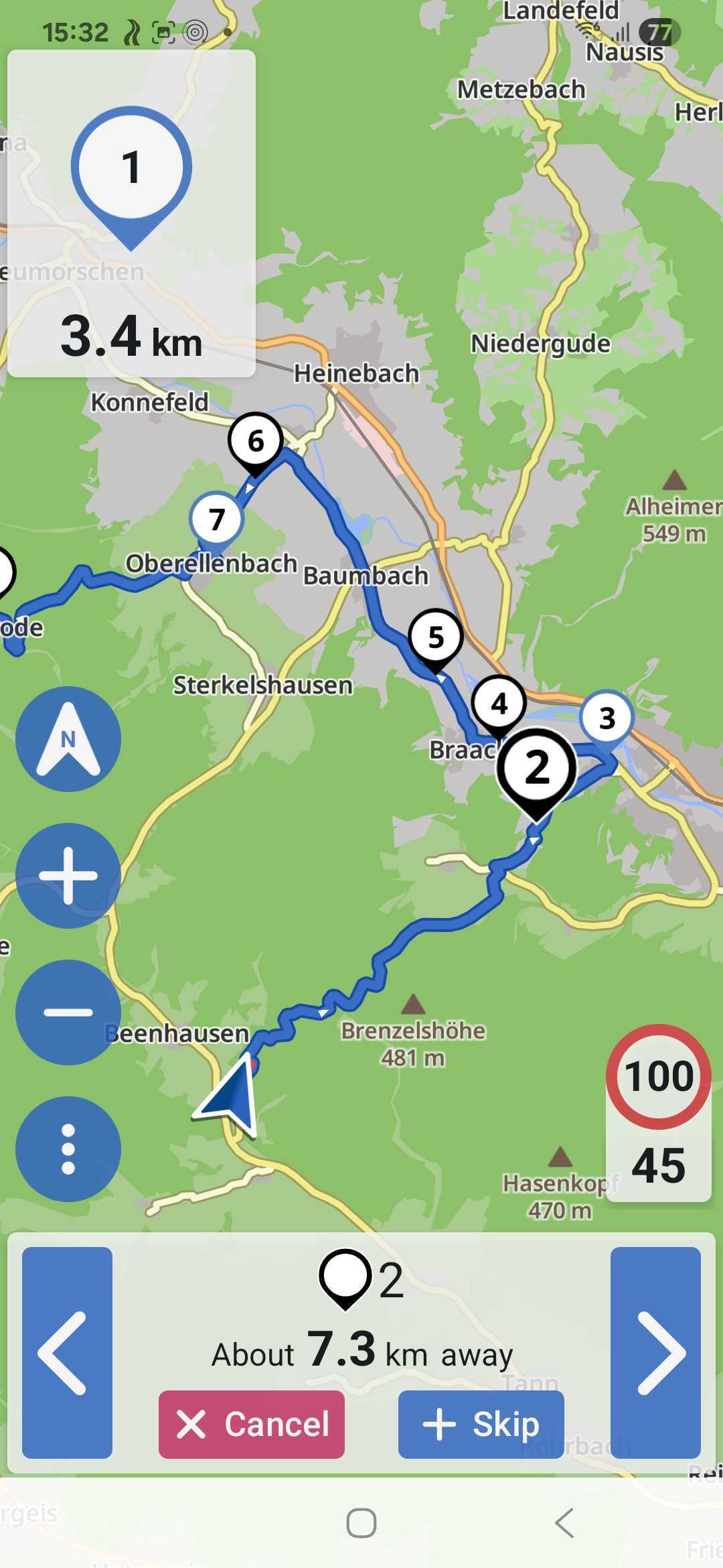

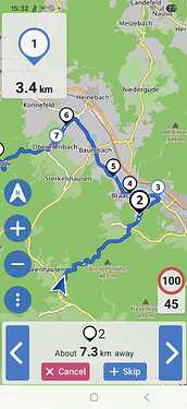

I’m unable to reproduce the issue. When I add a fuel station while in navigation mode, Kurviger treats it as a regular via point. For example, in the screenshot, waypoints 3 and 7 are fuel stations. I can skip them simply by selecting a later waypoint on the route.
It’s possible there’s a misunderstanding: Kurviger doesn’t let you select what to skip, but rather where you want to skip to.
If you accidentally added a fuel station and want to remove it, you can do so by pausing navigation, tapping the fuel station on the map, and then deleting it.

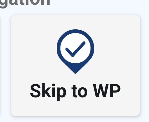

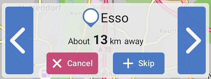

This is my misunderstanding. My confusion is over the button labeled ‘skip’. This makes it sound like you want to skip the waypoint. Maybe a better button label would be ‘Go To’ or ‘Skip To’ makes more sense to me.
This is true. Although it says “Skip to WP” here:
There is no notion of “skip to” here:
