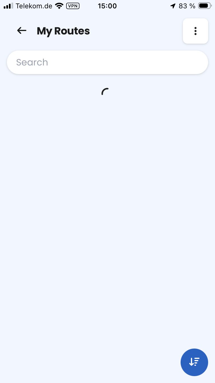

Really? I could reproduce it on Android last post and now on iPhone as well.
procedure:
  1. load route from cloud
  2. start the navigation
  3. switch to another app (e.g. Spotify or Browser)
  4. switch back to Kurviger (that is still navigating)
  5. stop the navigation
  6. try to open another route from the cloud
this is what I got on iPhone:
OSM date stamp: 5/4/2026
Version: 3.6.3
Device: Apple - iPhone12,8 - iOS: 26.4.2 - WebView: 26.4.2
App-Version: 3.6.3 - 10948
Screen: 375 x 667 px - 2dppx

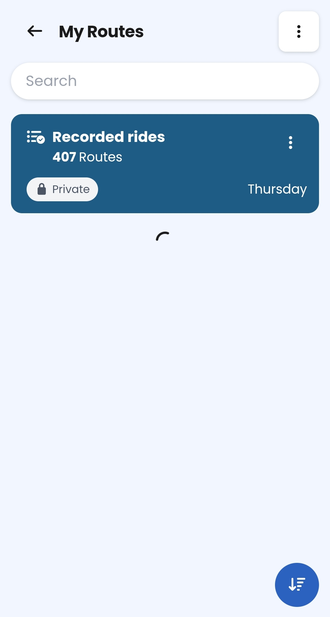

I saw this image for just under a second, then the cloud content was back as it should be.
OSM-Datumsstempel: 4.5.2026
Version: 3.6.2
Device: HUAWEI - LYA-L29 - Android: 10 - WebView: 147.0.7727.111
App-Version: 3.6.2 - 7093
Screen: 360 x 780 px - 3dppx
