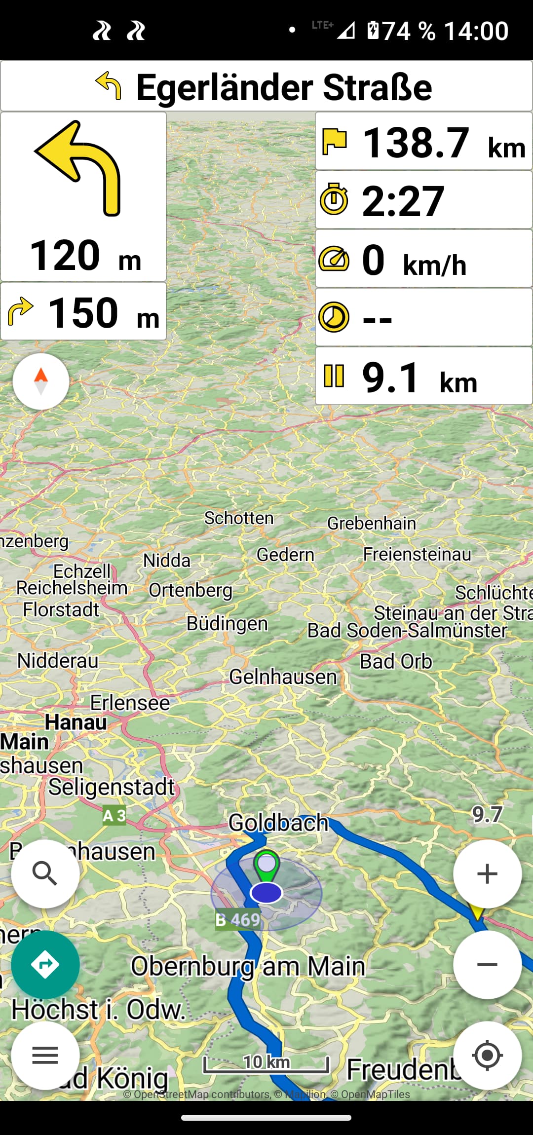

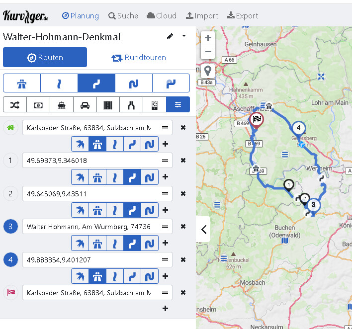

The Highway-Option is ignored between Start and Point 1?

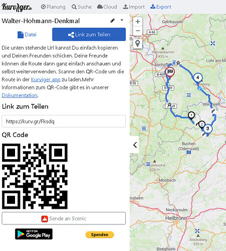

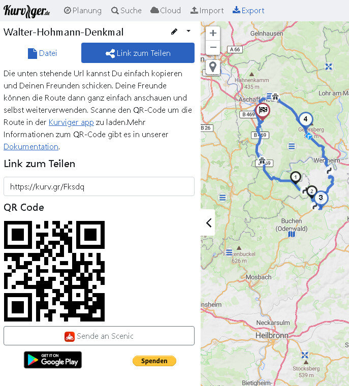

The Transfer: about Code https://kurv.gr/Fksdq (for Testing maybe)

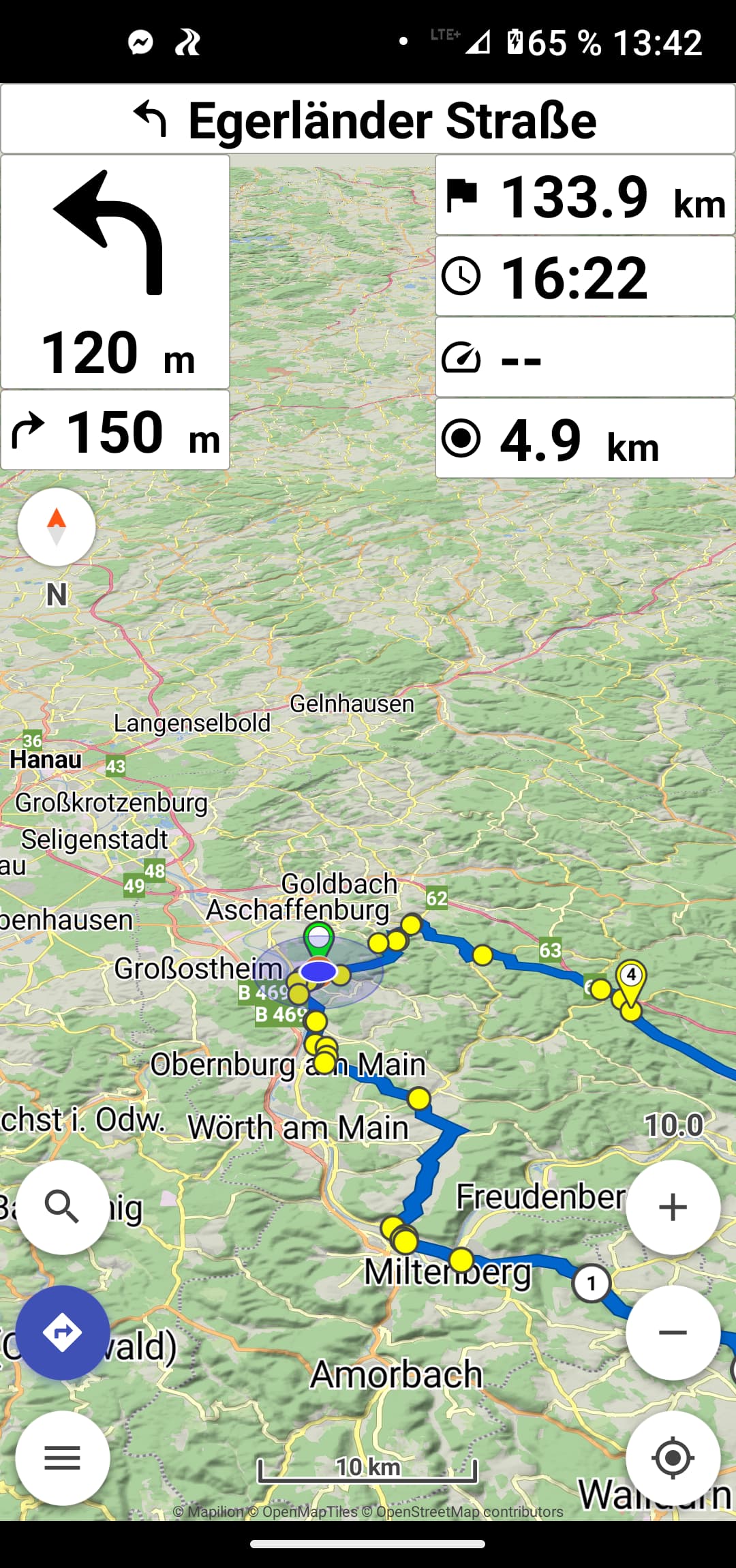

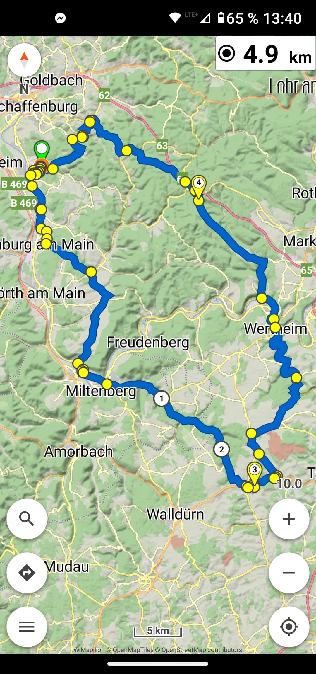

i transferd Walter-Hohmann-Denkmal.kurviger from PC to Android. This Transfer works 1:1
what´s my Problem?
Hello,
what´s my Problem?
Opening the link on the website, it displays the message:
“Your route contains exclusive Kurviger Tourer features”
Such features are available in Kurviger 2 app
(with Pro subscription).
If you still use the old Kurviger 1 app
you can transfer the routes as .kurviger files (and avoid route calculation).
More details exist in the documentation:
Kurviger Features Webseite und App [Kurviger Knowledgebase]
