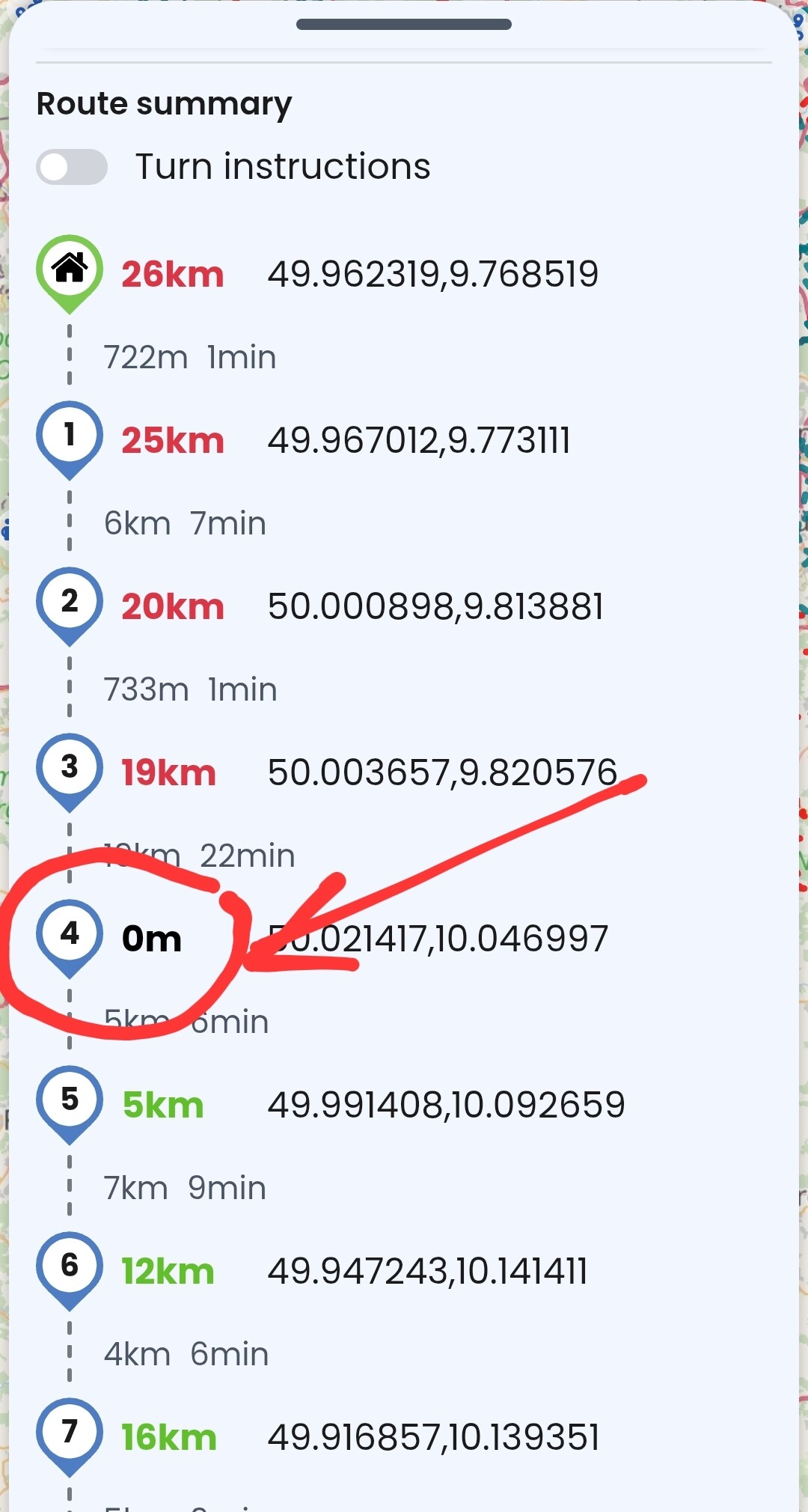

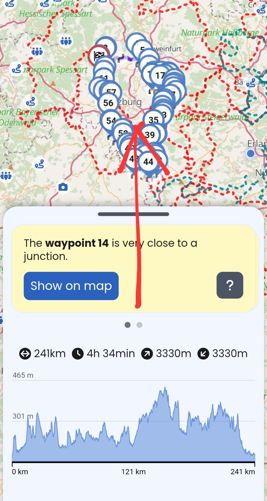

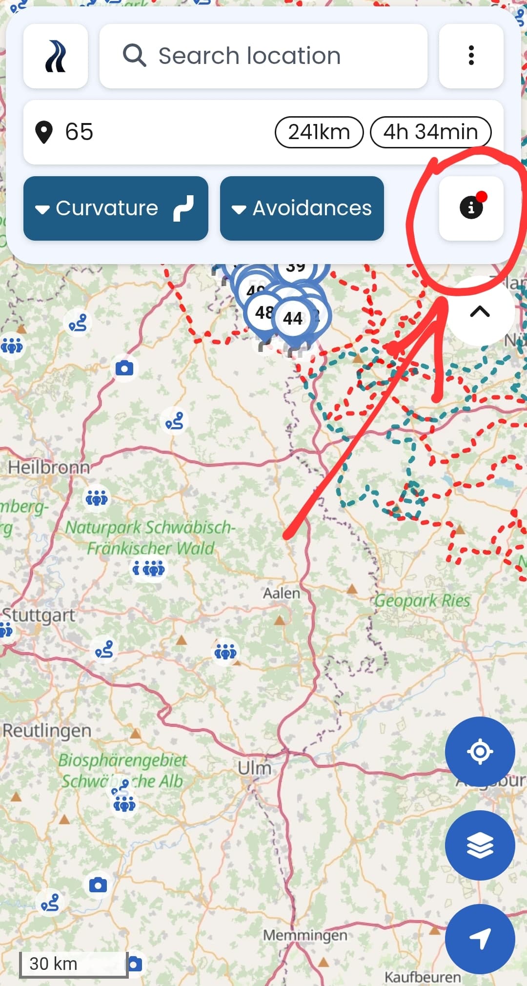

Press the “i” Button:
Swipe the area up:
Press and hold the Via-Point that is you reference:
Perfect. Thank you very much!!! :+1:

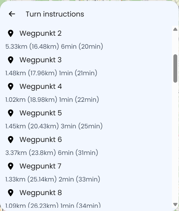

Ok. I was able to resolve my issue on the Android app. I can’t seem to resolve it on the computer version. Is that possible too?
In the menu “…” you can select “Turn instructions” and there you get a similar looking list with the distances, however, I am not aware that an equivalent of “press and hold” is available here, so some basic subtraction skills may be necessary.
Ok. I also think that that function is not yet possible to do in the computer version. I hope that the app developers pay attention and decide to develop that function. Once again, thank you very much for your help.
