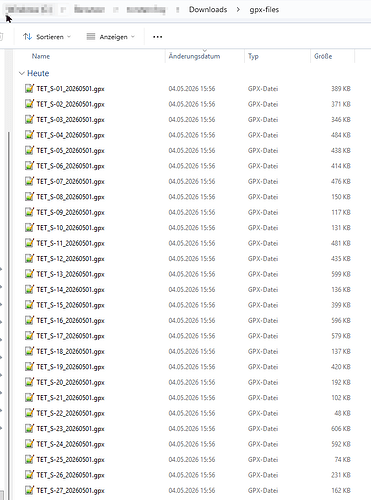

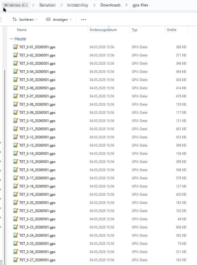

- open the file
- Mark all by CTRL-A
- In left menu choose Split
- Press “Extraxt”
- File is splitted into 27 files
- Export “all”
- First Donate
then download the zip-file. Works without donate, but worth to do so.
- You have a zip in your Downlods - unzip to separate folder. Wow!
These files can now be imported as tracks.

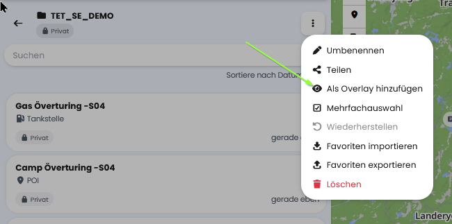

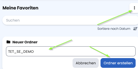

As we have about 903 waypoints, we can import it as favorites. As one folder can contain only 300 favorites, we must create 4 folders.I guess all waypoints can be mixed, as it seems, the poinmts are hints all over the country.
- Cloud - Create 4 folders (I create only one as demo)

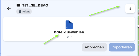

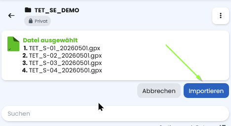

- Go into the empty folder, use 3-dot and choose *Import"
- Choose a bunch of files - you can select more than one - or you import one by one until the limit of 300 is reached
- Now import

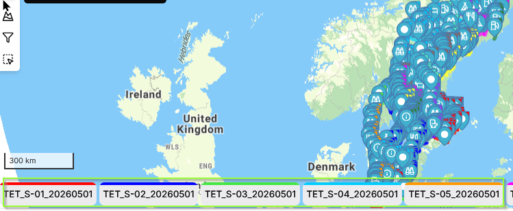

- Add folder(s) as Overlay

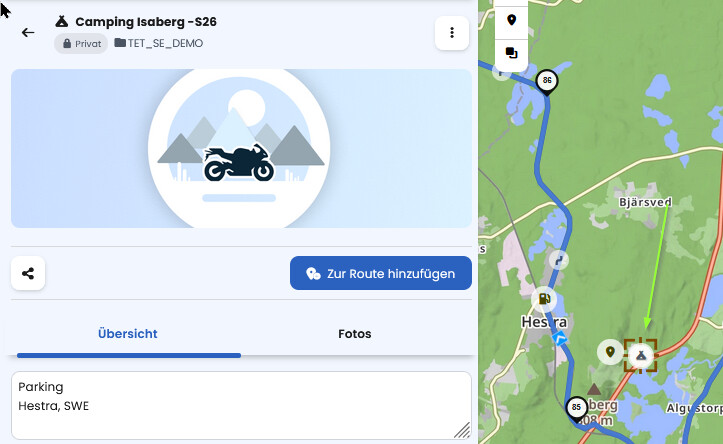

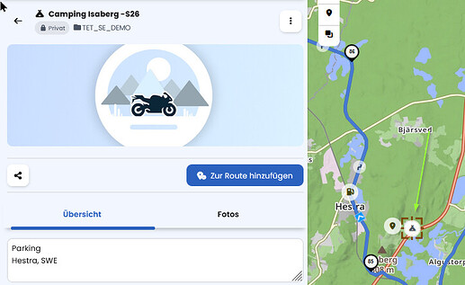

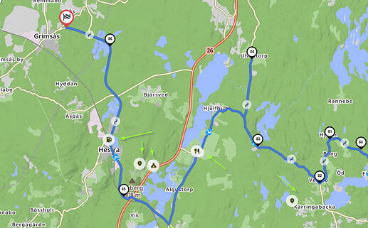

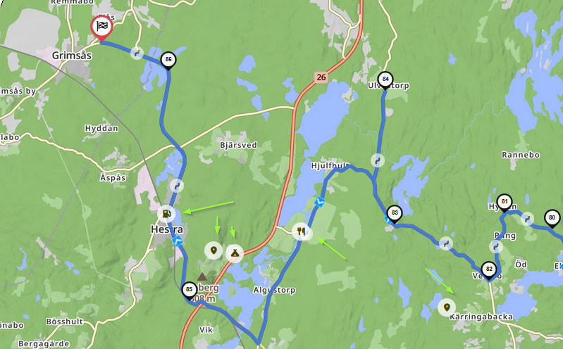

I think, it looks fine with the first route.
