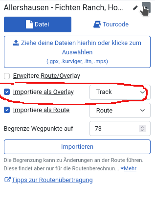

There is information about route transfer in the documentation:
When importing a GPX-file from somewhere, I would always try to import the the track as overlay additionally to the route. Than you can easily add a few extra waypoints to match the original track if necessary.
And use as few avoidances as reasonable.
See also:
Importing a GPX Track into Kurviger [Kurviger Knowledgebase]

I take such .gpx files and reduce them to the track data (delete routes and waypoints - with RouteConverter). Then imported into kurviger.de with enough waypoints already gives a reasonable route guidance. This in a few minutes by moving and inserting waypoints then exactly align to the track and the result is perfect: https://kurv.gr/K2RWL
