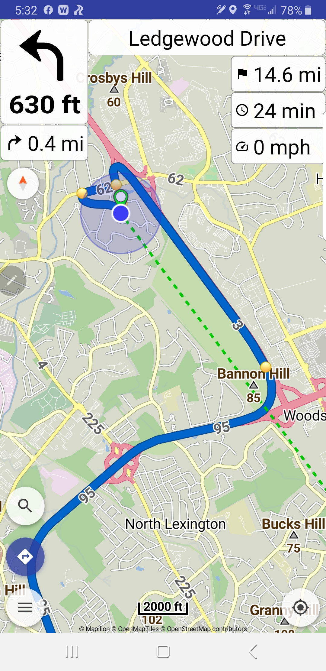

I am importing a GPX file that I created in Basecamp. Initially when imported the route shown is the same as in Basecamp.
But when I initiate the turn by turn instructions, Kurviger changes the route to a different one.

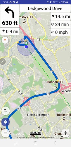

can’t get second shot
The route ignores the waypoints I have in the gpx file. It doesn’t seem to matter what options I choose for overlay and routing.
The only situation I can imagine, where Kurviger could skip waypoints, is when you are off the route. But then, you should get a question when starting navigation.
Something like “Route calculation to start | standard?”
In the screenshot I am missing the “location arrow”.
Do you have GPS reception?
Are you ouside or are you inside a building?
Could you post what the app is displaying in
settings | about | info
There should be some info about Kurviger version, Android version location service etc.

(not related to navigation - image does not have any waypoints)
