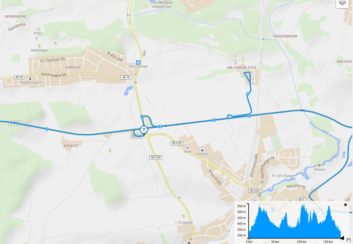

Looking at your route, I can see 2 “suboptimal” placed waypoints:
1. Waypoint 2 is off the road:
2. The route around waypoint 7 seems to be strange too:

But route between way oint 6 and way point 7 was placed by the APP and also the strange way forward and backwards again.
So if that’s the problem I will check my routing better before I start.
Hard when you are on the road and ask for a route at the mobile.
Could you tell me what could be the reason for the strange routing between way point 6 and 7?

> [@Nellimaster](#):
The problem is the placement of waypoint 7 at the intersection area.
Don’t place waypoints close to intersections and other streets!
The automatic round trip generation is a nice feature, but I wouldn’t trust it blindly.
I consider it as a suggestion and _always_ check the waypoints by myself and adjust them to my wishes.
