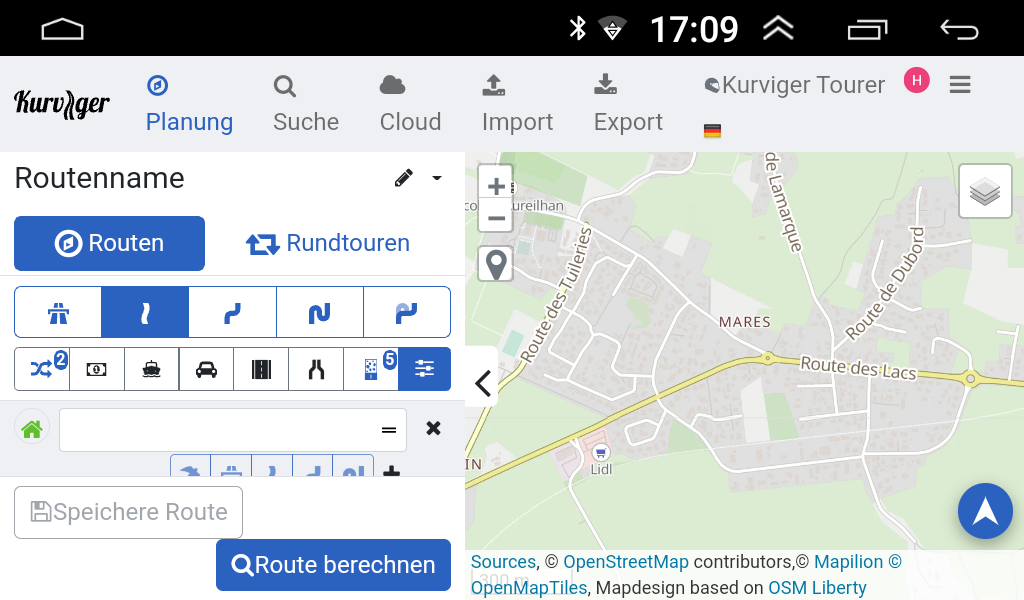

Routing from current position. position not inserted into start field for planning. Turning clock continues forever. Google pos is ok
Device: alps - F9212B - Android: 9.1 - WebView: 107.0.5304.141
App-Version: 3.0.0 - 249

Yes, GPS fix was present. Google had the position immediately. Kurviger still not. I realised that the map besides the planning section did not show any position during planning. I also realised that there is no “follow mode” where you can see your position w/out route active.
Its a Chineese Android Car radio; old Kurviger was working OK, so do other nav APPs.
WRT. permissions, I can’t exactly remember, but it was working, navigating through a route, created and downloaded from PC/cloud. I 1st ran this navigation w/out any probs. Then on the way home, I wanted to start from current position, where I ran into this prob.
It appears 2b a TAB issue. I can’t reproduce the prob on my Huawei FIG_LX1 under Android 9.1.0.
But I have the same behavior on my Levono Tab TB-X304F Android 8.1.0. Please note from the screenshot (Alps) that there’s no “Standort” icon visible. Same on my Levono, where I see All Europe on the planning with no position.
I checked the APP permissions under Android settings, they are granted!
1 more little thing: On tablets you can’t wipe out the left part of the screen. The bracket “<” is w/out any effect.
Hi Ive, thanks for the detailed description and the screenshot. It appears I got some width-measurements wrong in the code. Can you please try to use your tablet in portrait mode (upright so to speak, like a smartphone) and see if the “locate me” button re-appears / if the “<” bracket gives way to the mobile layout? I will use your devices as reference models in testing in the future, these seem to be some interesting screen densities, thank you again

For my Levono Tab, no change, no cure in Portrait. (No wipe out, No Standort Icon)

I think the problem comes from copying code HTML from your web site. On cold start, I have the same behavior there. When you start your web application, it appears to me that you do NO position request at the beginning. This is OK, because most PCs do not provide location services, so there is no point asking for a position. The case “start from my current position” is a specific mobile/tab use case, but not for PC. On the PC I have to click “locate me” which unfortunately is currently not available on Android tabs. In nav mode, the app connects properly to the Android location service, but back in planning mode, this connection seems 2b lost and hence, “start from current location” does not work, because the app does not re-connect to the location service.

The button will be available with the next update. In the meantime you can use the input to select your current location.

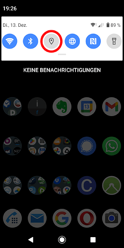

Thats the behavior on my smartphone if “Location” is not activated:
