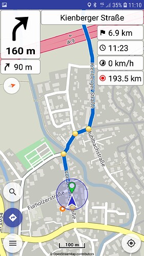

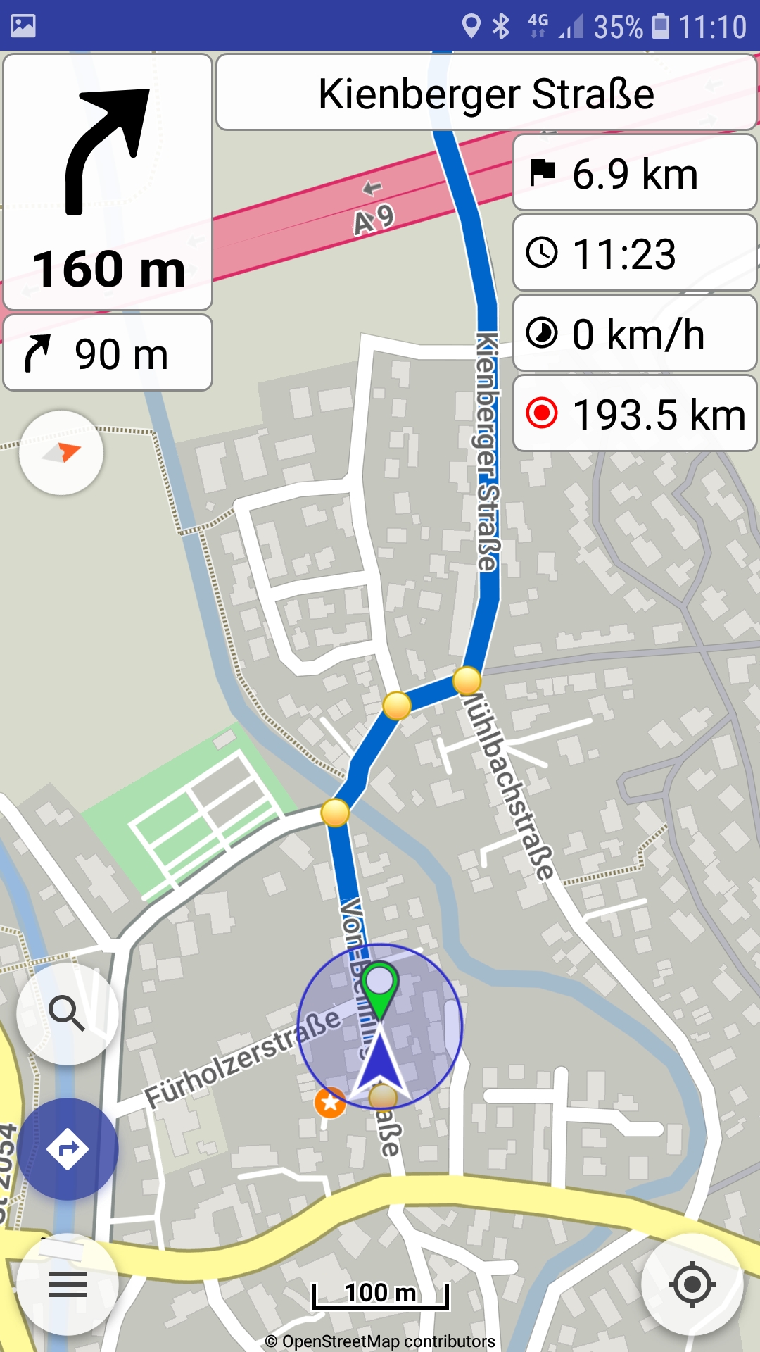

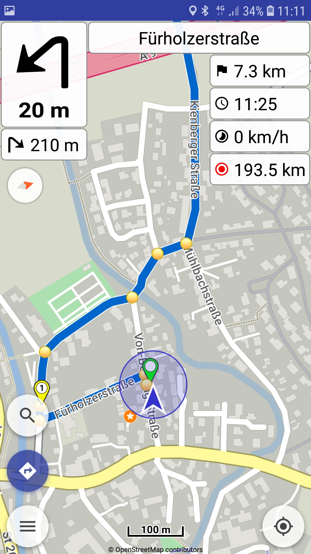

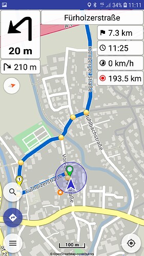

To demonstrate, I’ve stopped shortly before “Führholzerstraße”.
In the left (first) screenshot the next turn instruction is 160m away.
Kurviger could have used a route like e.g. in right (second) screenshot, but roadblock 100m doesn’t change route.
 ![Screenshot_20190824-111016_Kurviger%20Pro](https://forum.kurviger.com/uploads/default/original/2X/c/c7acef9d9388c1e0d82e2be306b1ddba02e01c0d.jpeg) ![Screenshot_20190824-111147_Kurviger%20Pro](https://forum.kurviger.com/uploads/default/original/2X/5/50632fe38ef4bf2de6bbc8abd4437cf8cd6cedd7.jpeg)
