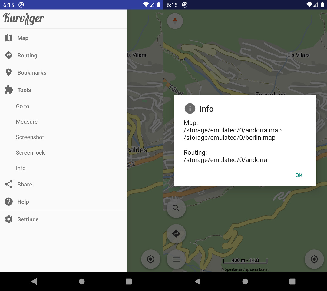

To avoid annoying startup messages for info that usually is needed on demand, a detailed info for the loaded data can appear (and be enriched in the future) via menu “Tools | Info”:
