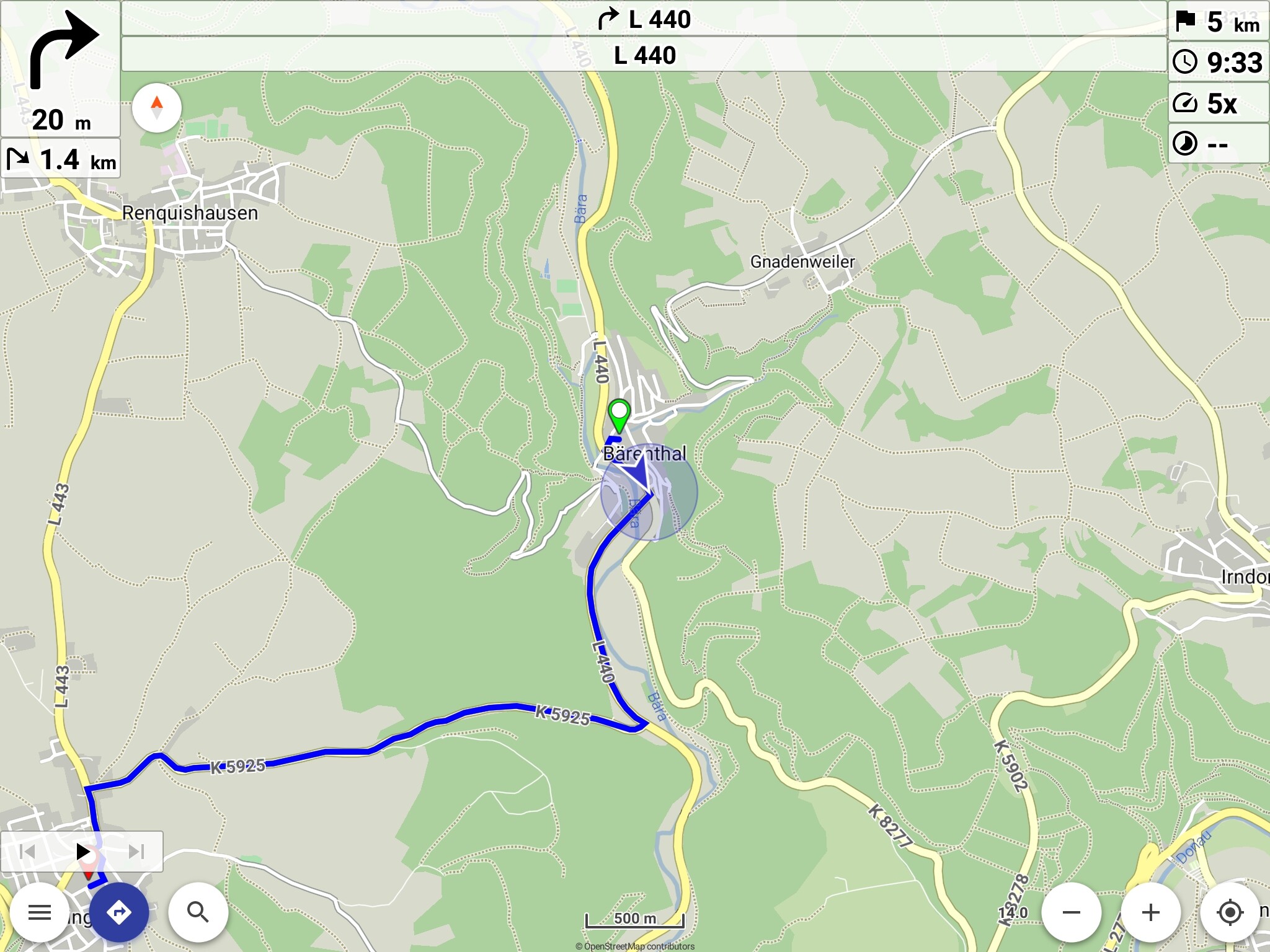

Just a hint / a question, definitely not urgent: If I understand right
Arrow position
and the answer
Implementation
the position marker might be placed a little bit more down in “2D, North up” view (center of visible map), especially with two text lines at top border.
If yes, should it work already in 2.0.7?
As far as I can see, the position marker is still centered on screen:
This was discussed in the internal closed test.
So most users cannot read that discussion. ![]()
There was no change.
The discussion was about the Y position shift lower in map rotation.
(outside map rotation, the map center is always used)

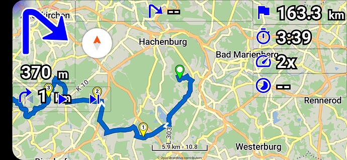

Hallo
Kurviger 2
Wie bekomme ich die Umrandung weg?Auch der Strassenname ist ausgeschaltet aber das Feld ist da.Ich sehe keine Tankstellen mehr.
It will be removed in next update.
It can be disabled in “Settings | Navigation | Turn instruction”.
(this is not “Street name” display)
They can be enabled with menu “Map | Map layers”.

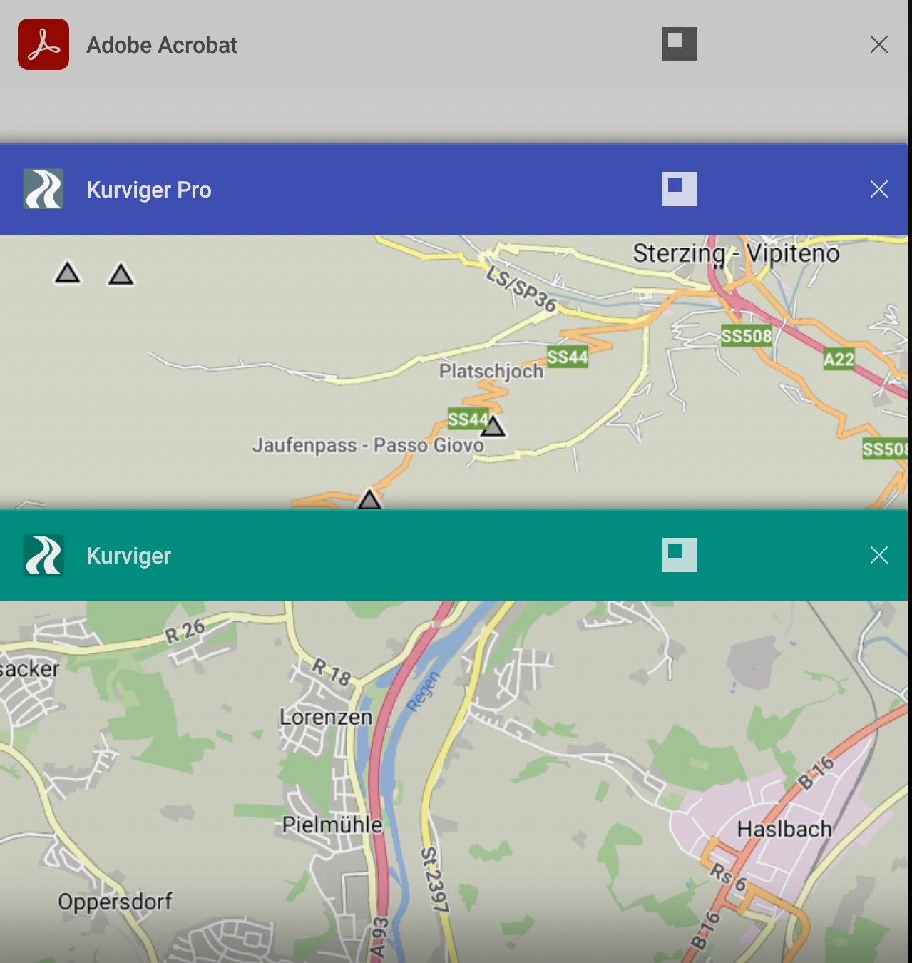

Icon background color of Kurviger 2.08 and Kurviger Pro now different, even on home screen ![]()
Reduces risk to mix them up a lot:
The previous combination was strange: gray + indigo colors.
For now I used teal colors (like already exist in app dialogs).
Should pressed buttons remain blue?
(blue buttons are more common)
Anyway it is not final…
If there is a better suggestion from Material collection:

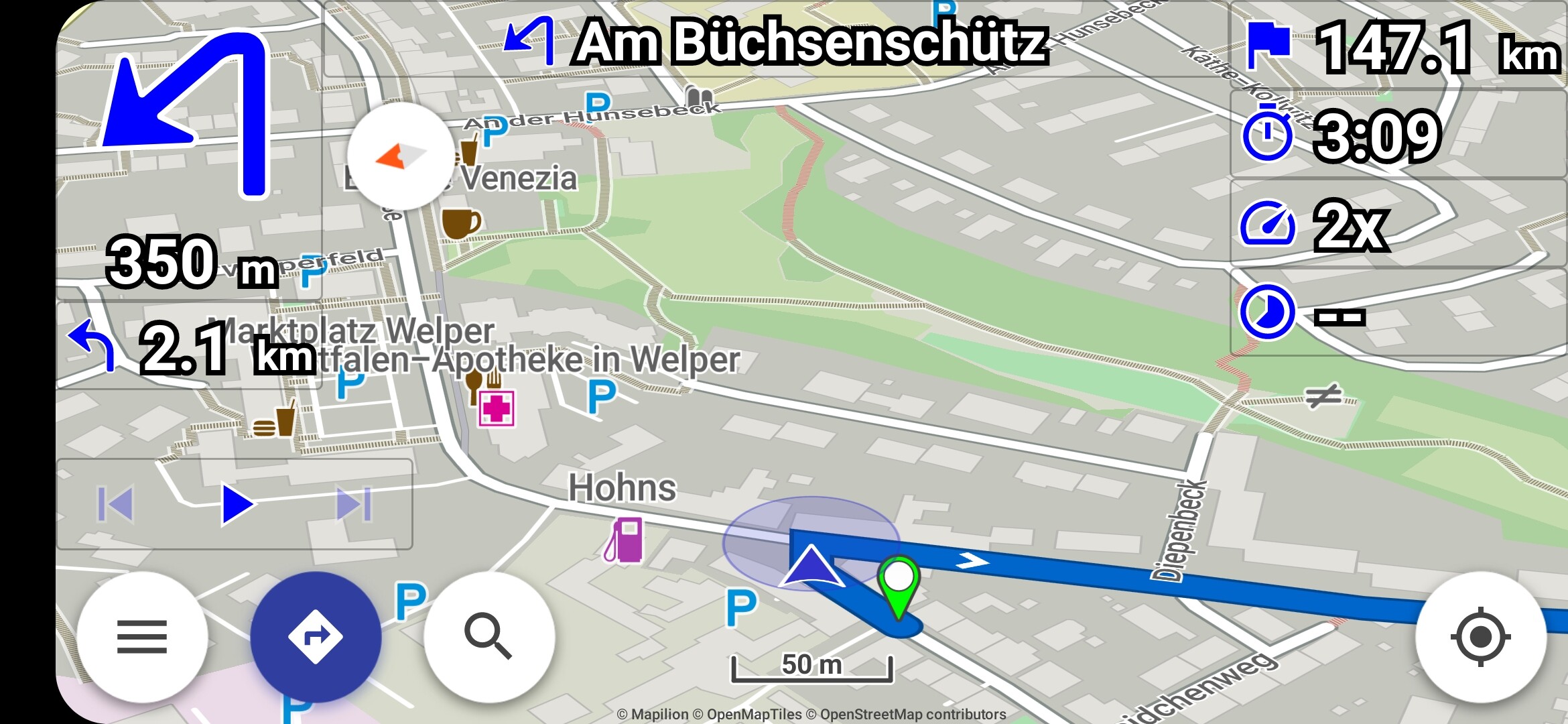

I also recognized the different icon color, that’s nice. Helps better identifiy the 1 Pro and 2.x.
I don’t know much about design. You can influence the colour of the arrow via the foreground colour. For me, it would be consistent if the colour of the text and the colour of the pressed button were adjusted to the same colour, because otherwise you might have two different shades of blue on the screen, which would look like a break in style.
But that is not really important to me. More important for me is that I can read the nav bar texts during navigation. It’s just a thought.
Don’t know if this is possible and if it is good looking: would it be technically easy to adjust the arrow and text filling with the foreground color options and the shaddow/border with the background color options? Maybe just for testing in 2.0.9 and if the majority of users says good, then keep, otherwise take back.
