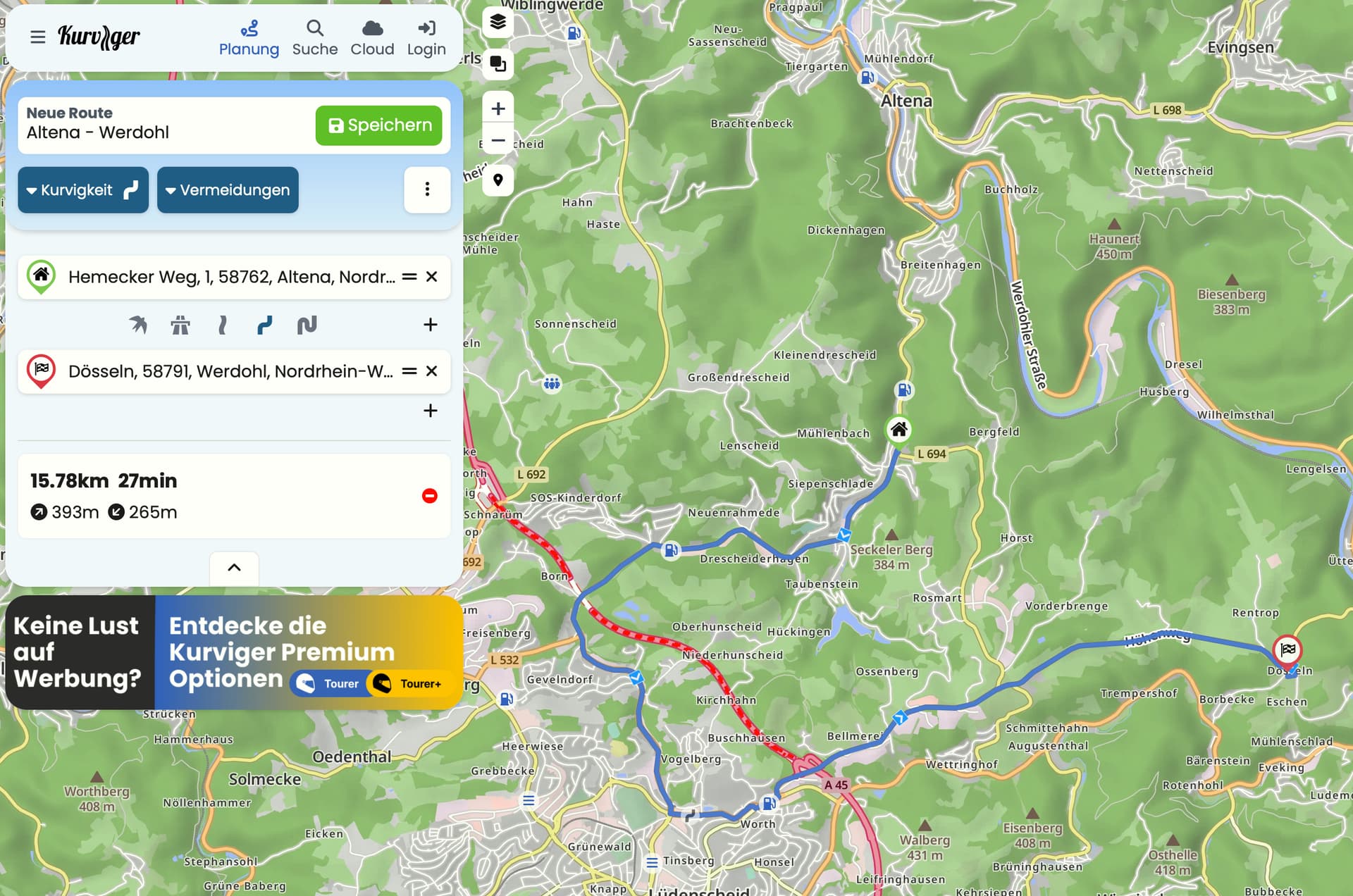

Hello!

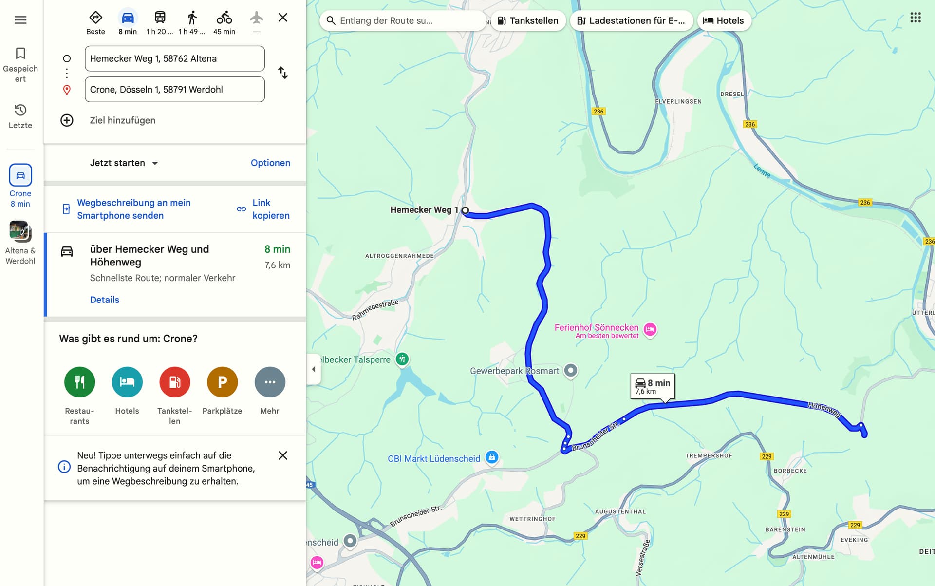

I would like to get the same route as Google gives me, but how?
How can I finde out what the problem is?
Start: Hemecker Weg 1, Altena, Deutschland
Ziel: Dösseln, Werdohl Deutschland

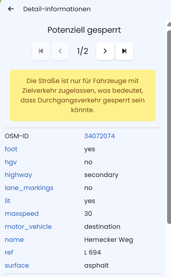

Part of the road is registered as blocked in OSM
You can see this from the red icon below your waypoint list and on the route, too.

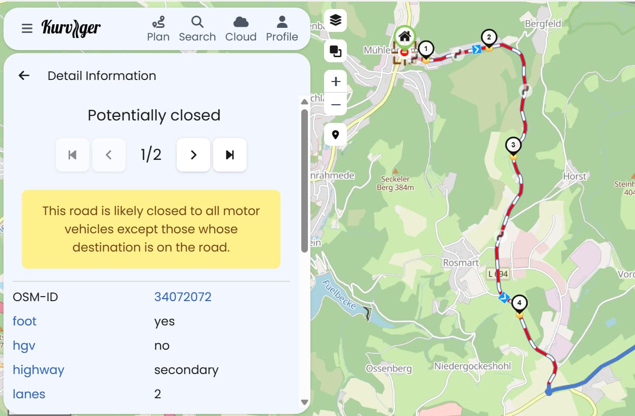

Just had a look at it in OSM, but I’m not really familiar with it – @Guenther, is this road tagged correctly? If it’s open to residents, it should be possible to route through it with Kurviger, shouldn’t it?"
If you have local knowledge or have been there to confirm that this road is open to all vehicles, you can correct the data in OSM.
Probably this tag has to be removed completely, if there are no restrictions:
Here is the link to the route with shaping points: https://kurv.gr/AdM9D

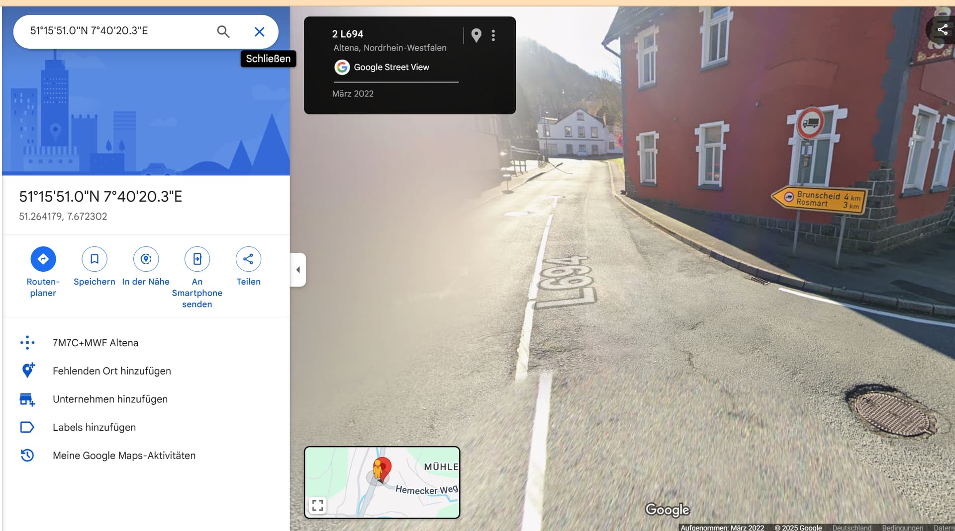

In Google Street View is only a prohibition for lorries.
In OSM it was tagged as designated, means only access for neighbouring traffic. I have opened the road for motorvehicles in OSM now, should become effective within two weeks latest.
