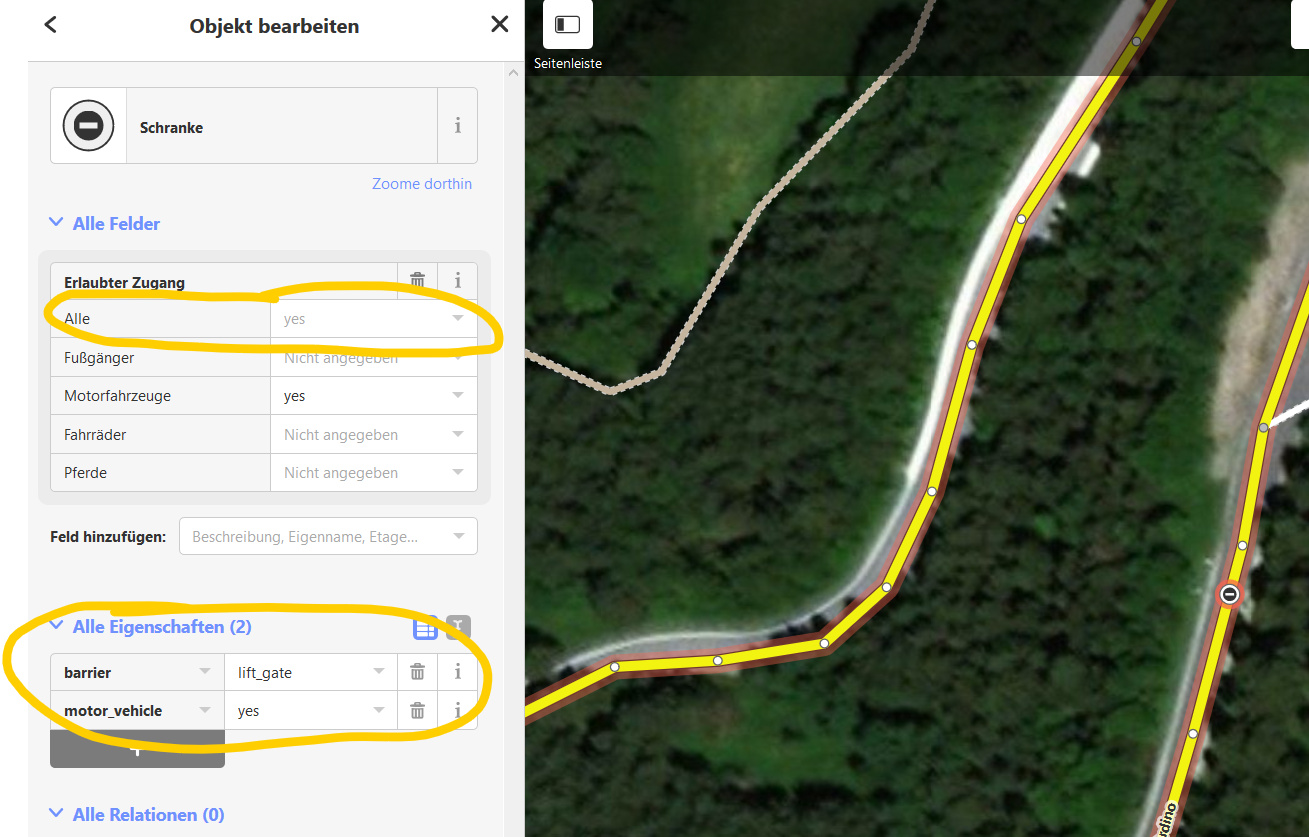

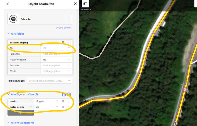

Hi Engenia,
ok, there are multiple things to say here, let’s go to them step by step
  1. As I myself had to learn the hard way: the slightly grayed out All: yes in the OSM GUI does not mean that it actually is set to true :frowning:
    The truth can only be seen at the bottom, under "All Properties
    So what we can see there is the motor_vehicle:yes that you added, but access itself is still set to… “no value” so I assume that’s why Kurviger does not route here
  2. Your change may very well have fixed this problem! :slight_smile: But all the servers and the caches in the background take a little bit of time to fetch this information. Kurviger usually shows the changes after 1-2 weeks, so check back in a week to see if it works. You may absolutely also set access:all if you like, if you know that that is true, e.g. if you have local knowledge
  3. Users in OSM don’t have to change the access values when another season comes. This is what conditional restrictions are for - which is a very cool topic that Kurviger now makes great use of! Again, if you know that this gate is closed seasonally, you can very easily edit OSM to show this. If you don’t feel comfortable with this feature you can let us know here, I’m sure we can get it to work together
