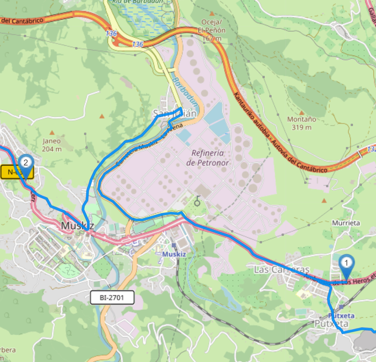

Sorry, but this is apparently a tough nut to crack. We’re still not there, yet!
If I choose from Bilbao to Santander w/ Highways OFF, I get this:
https://kurv.gr/j17Jv
Obviously, it does not take the N634, which goes in parallel to the Highway A8, but it takes me via a 2nd/3rd order roads.
If I try to set waypoints on the National Road N634 , which would be the route of choice from Bilbao to Santander, avoiding the Highway A8. Here the route goes over the parking lot of Petronor !!
https://kurv.gr/BUq2x
RGDS
hk
Thanks for the update, yes there seem to be a couple more issues. I will have a look how this can be solved.
