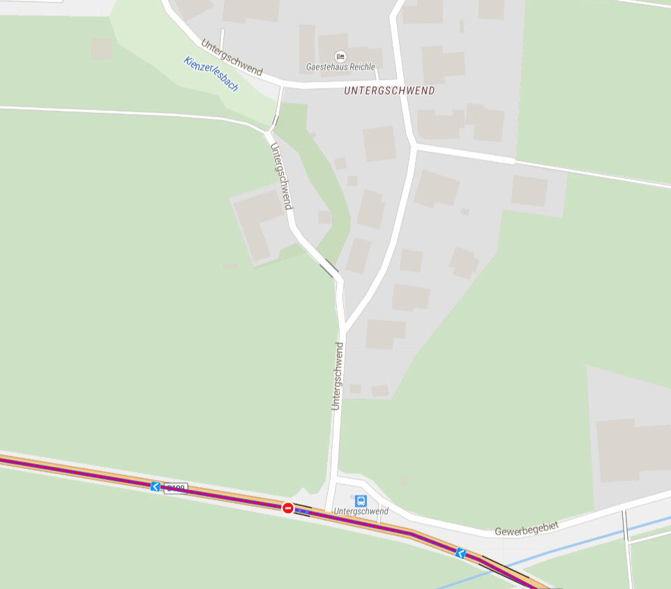

Kurviger shows a lot of potentially closed road intervals, if there are missing restriction definitions in OSM data.
Example:
Especially between waypoint #1 and destination (Hahntennjoch road).

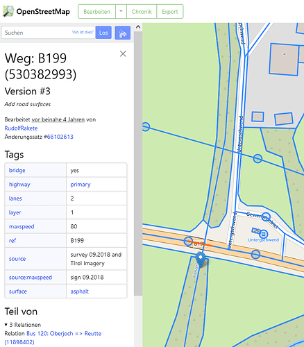

Those intervals are due to some road segments without restriction data, example:
One way to solve this is entering the missing restriction data in that intervals, of course - I plan to do it for Hahntennjoch road .
But nevertheless a question (I am lazy :wink: ): Would it be possible to omit such short segments in kurviger and summarize the restricted roads to one segment?
I have no good idea how to decide, if a segemnt is a “short” segment - perhaps a segment length threshold, or a beeline thresold between ent of previous closed segment and start of next closed segment.
Perhaps anyone has a better idea … what do you think ?

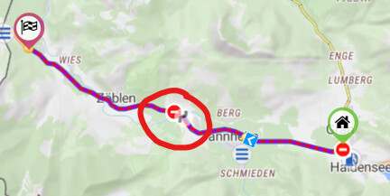

But checking the gaps in my routes I found a problem: In the route
https://kurv.gr/v9ndD
there is a gap in the middle:
But investigating the route segments on OSM it seems that all road segments have the tag
motorcycle:conditional = no @ (apr-oct AND >95db)
Can anybody explain to me why kurviger starts a new closed road segment there ?
Thanks in advance
Markus

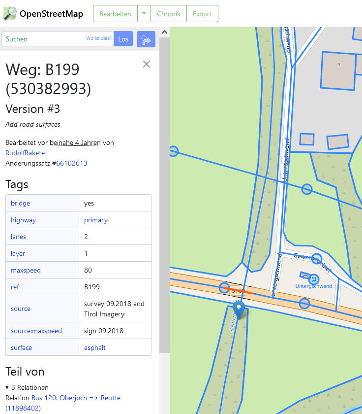

Perhaps, because there is a short segment with no closure remark (e.g. no entry at motorcycle:conditional as in the neighboured segments):
Hmmm - You are right: The tag “motorcycle:conditional = no @ (apr-oct AND >95db)” should be set - I just did it.
But that segment is some Kilometers away from the segment linked in the closed road information in Kurviger … :thinking:
We will see, if it changes.
I think I understood: The link in the closed road information in Kurviger does not necessaryly lead to the first closed road segment of a potentially closed route segment, but to any closed road segment of of a potentially closed route segment - perhaps this might be improved to make it easier to find the cause of gaps …
