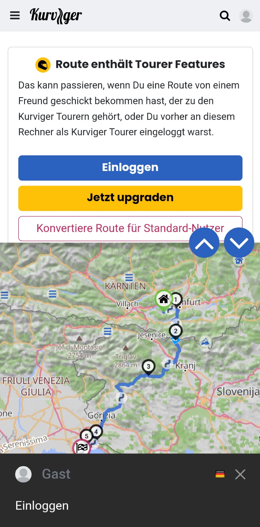

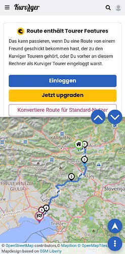

On my phone (Galaxy A52 4G, Android 13/One UI 5.1, WebView 115.0.5790.168) ALMOST ALWAYS the following message is shown shortly after opening the app:
To me this looks like the app doesn’t remember my Tourer+ login after being closed.
After a few seconds the message disappears and the app recognizes my Tourer+ status. But ONLY WHEN BEING ONLINE!
Without internet connection the above message stays active and I am NOT recognized as Tourer+!
I also do NOT log out manually at all from the app (why should I)…

Well, it doesn’t - tested again right now…
Message stays visible, clicking on the “anonymous user” icon tells me I’m a guest:
After activating my internet connection again and re-launching the app the message disappears after a few seconds and it recognizes my Tourer+ account.

I have tried to reproduce this case and I still can’t reproduce it. In your case the app does not seem to remember the login at all, so this is one step before the subscription check. You can see this in your screenshot because the app shows “Gast” and not your login.
