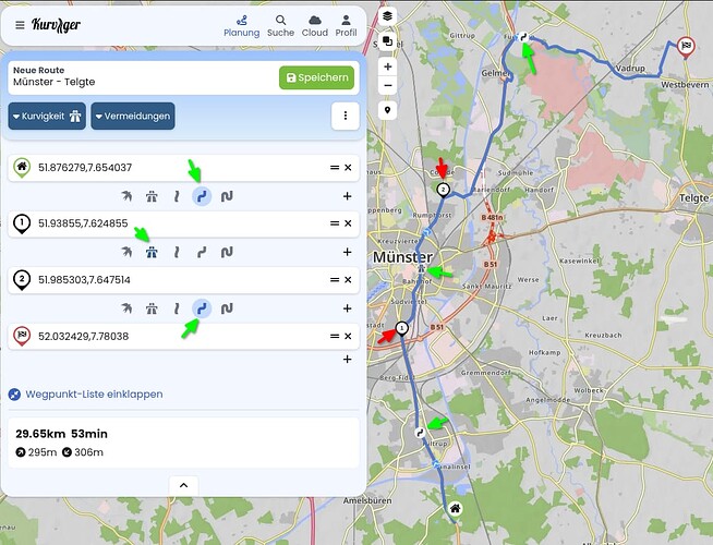

It is possible to set shaping points from the route and adjust the curvature between two points. ( of course also applies to start, end and waypoints ).
Avoidances, however, always apply to the global route.
So if you want to cross cities quickly, simply set a point at the entrance and exit of the city and set the curvature in between to fastest.
Red arrows → extra points
Green arrows → curve setting options
Example:

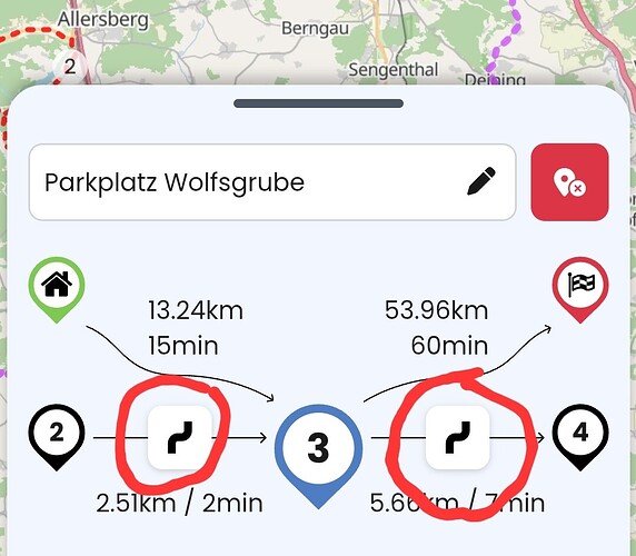

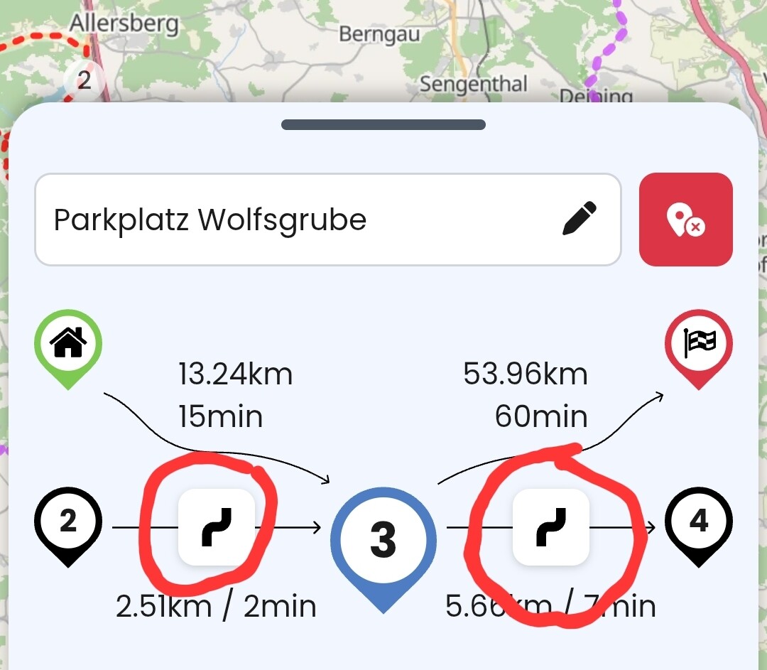

You can set different curvature for each route segment between two waypoints using this symbol:
Alternatively, you can place shaping points on the fast roads that you prefer. Be careful if you are placing shaping points on motorways with separation between two-way traffic - this can cause undesired results if you place the shaping point on the wrong direction.
