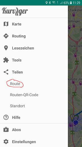

If you mean how to export / share a route in the app, please see the manual:
