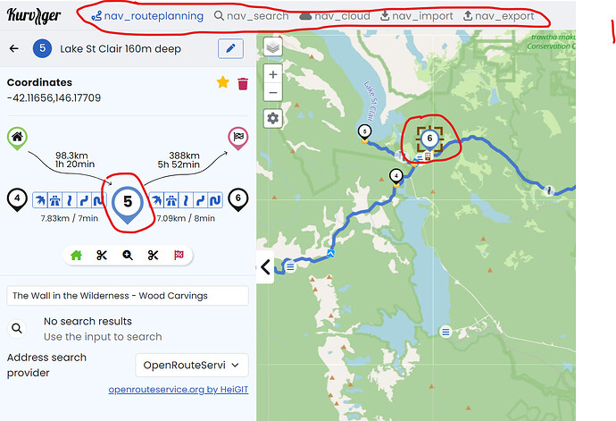

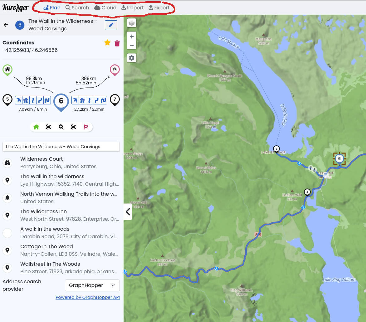

I attach a screen shot.
I have been getting unusual screen behaviour and display Chrome on Windows 11

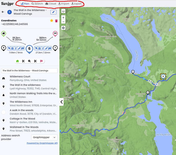

The headings are not normal.
When I click on the next Waypoint of Shaping point on my route the left panel of the screen does not advance to that point - circled
Your menu line on the top is looking strange.
Where do these “nav_” things come from?

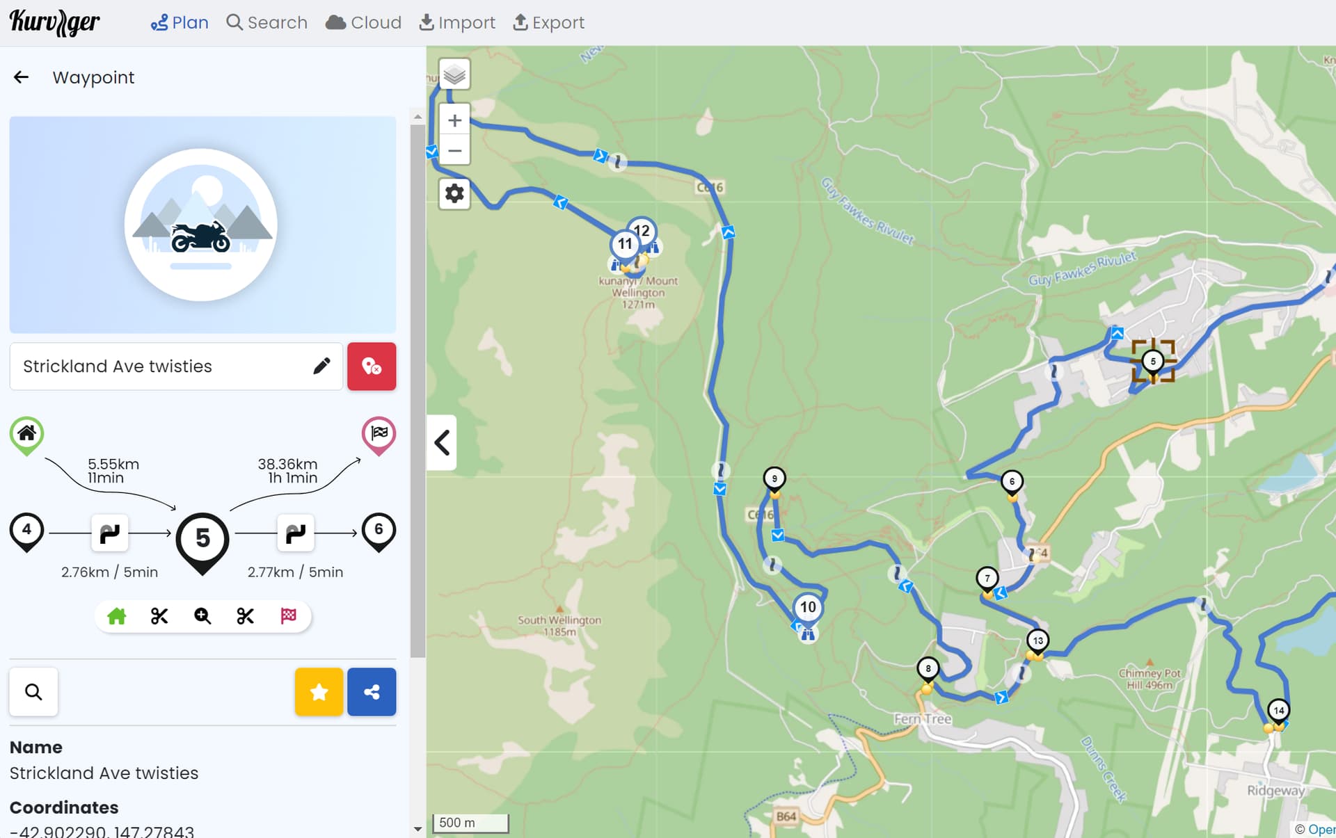

That’s how it looks om my browser (Chromium on Ubuntu)

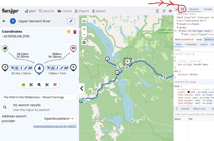

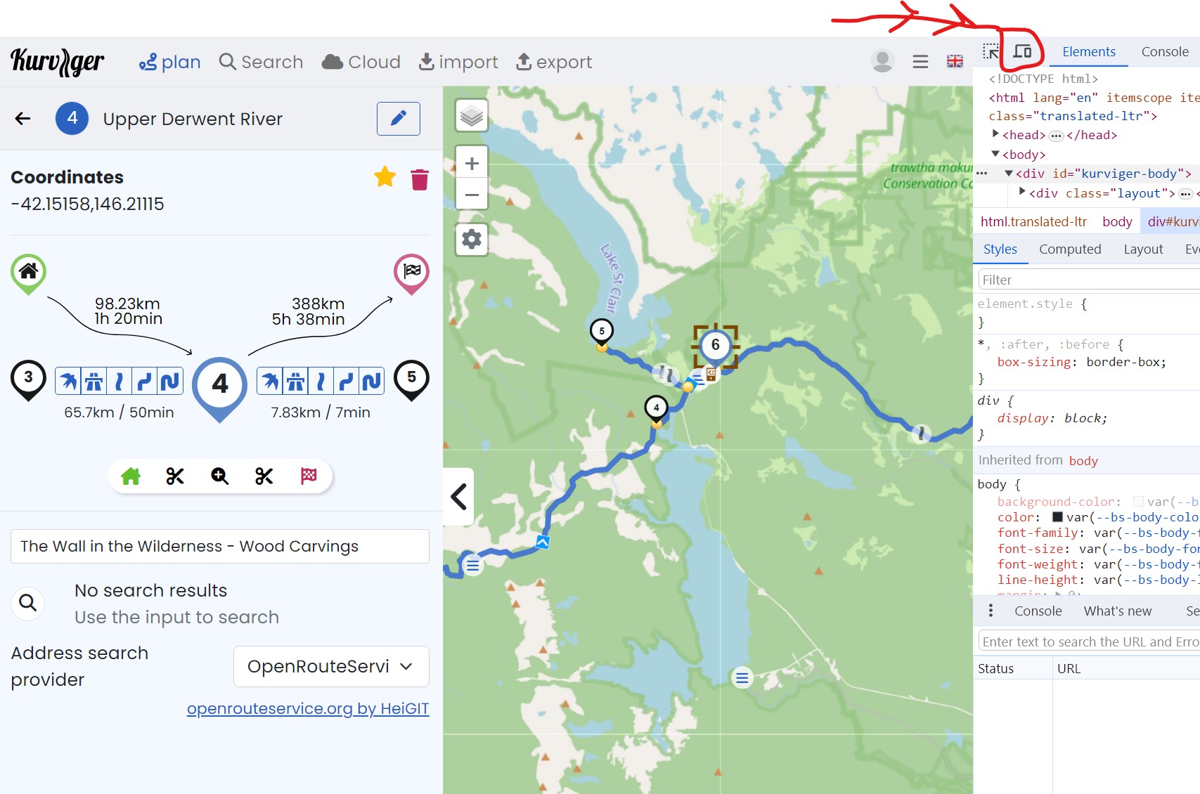

If I launch the developer tools and change Device from Desktop to Phone and back to Desktop the Menus revert to normal but the waypoint focus still does not change in the left panel.

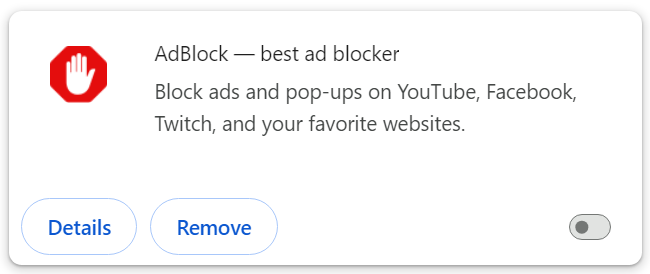

I tried various setting for AdBlock and at first it worked but then reverted to the strange behavior.
The top menu would show correctly but in 1 second it would change to the “bad” menu.
The Waypoint advance would work intermittently and then stop !!!
I also have MalwareBytes as a plug-in but experimenting with its settings did not provide a solution.
I will use in Incognito mode for a while.
You could try to disable/pause these extensions to see which one might be interfering here.
I am glad that we could find the issue for this :+1:
I disabled Ad Block and viewing has returned to normal.
I wonder what pieces of Code Ad Block doesn’t like ?

You can setup AdBlock to not run on Kurviger :slight_smile:. You could further experiment with the different settings. The more filter lists you have included the more can go wrong.

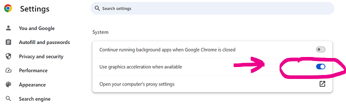

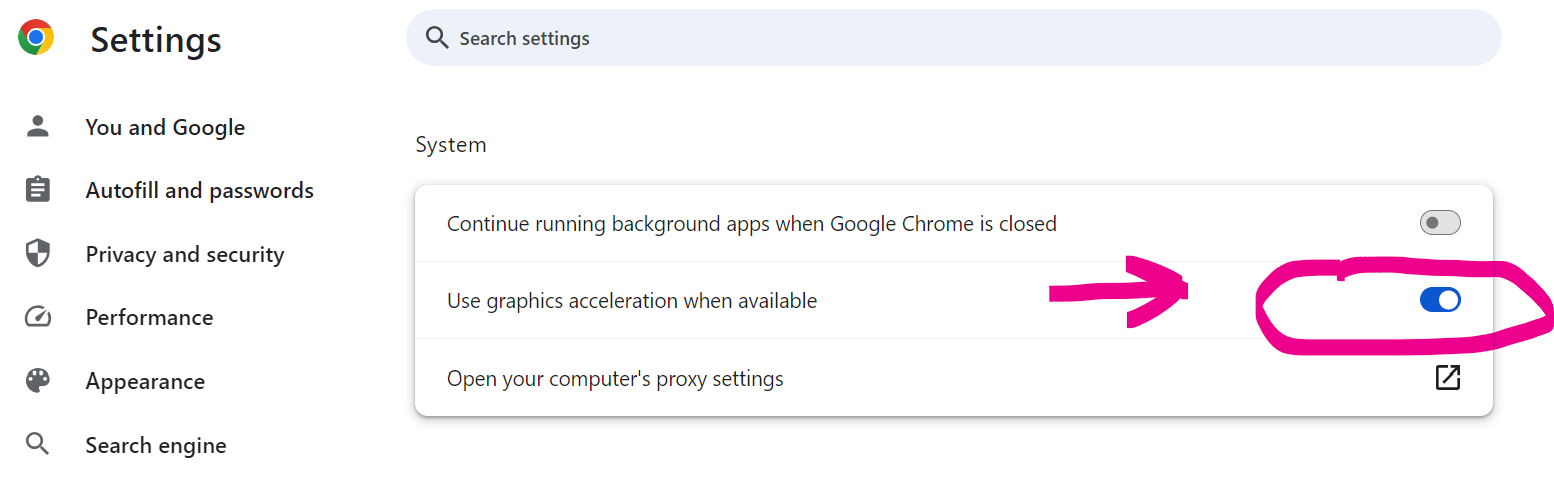

I’ve finally found the fix for the problem I’ve been having with strange heading and side panel Points not advancing. In Chrome Settings on Windows 11 I turned on “Use Graphics Acceleration when available”
No idea why
Thanks for keeping us updated. Ok this is very weird. I am happy that it works now :slight_smile:
