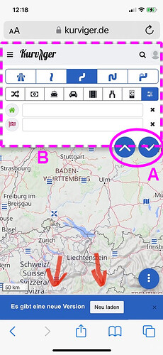

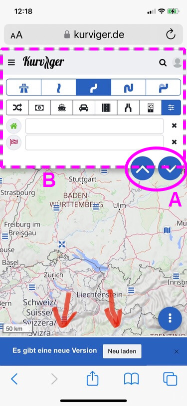

When there are visible one or two of the UP-/DOWN-Arrow-buttons (A) to open/close the sidebar (B) then currently it is not possible in the waypoint list to add an additional waypoint between existing waypoints.
For me this happens e.g. at the smartphone in portrait or when the browser is very narrow.

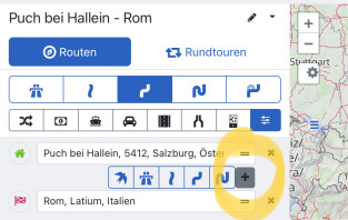

am ipad, ios 16.3.1. keine zwischenziele-+ bleibt dunkelgrau
I don’t know, why for the ipad, ios 16.3.1 the “+” in the toolbar is marked in darkgrey and without function.
