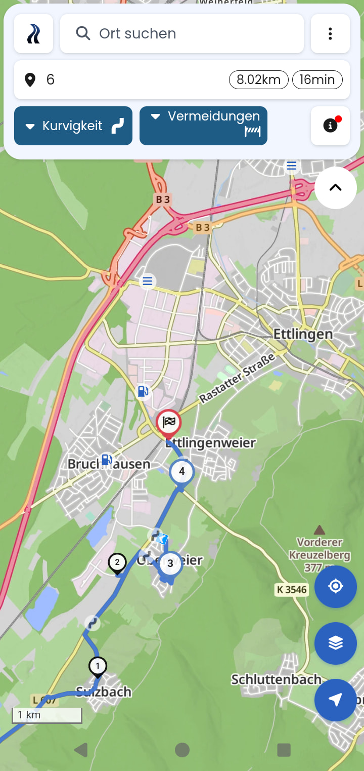

Kurviger uses 2 types of waypoints:
  • via point (blue mandatory). Use for places you want to visit.
  • shaping point (black may be skipped). Use to change the route to your wishes.
    Similar to drag and drop in Google Maps.
Kurviger should behave quite the same. The waypoint must not visited exactly.
SP - Shaping Point (black) - a SP should be skipped automatically, when it is behind you
VP - Viapoint (blue) - As it is a point you want to visit, Kurviger tries the best to guide you to this point.
To my experience a point is reached, especially waypoints, when your position is about 300 meters, less or more.
Proposal: As it is all theory, try to create a simple test route like this. Switch on recalculation(!) and drive just forward, and check what happens.
First part with black SP, one is set at about 1 km away from the route, one quite near.
Second with blue VP. One far away, one near.
The automatic recalculation shows you what new route would be calculated, when you press the recalculation button yourselve from your current position. To verify drive again with no recalculation; stop at some point and press button for recalculation.
