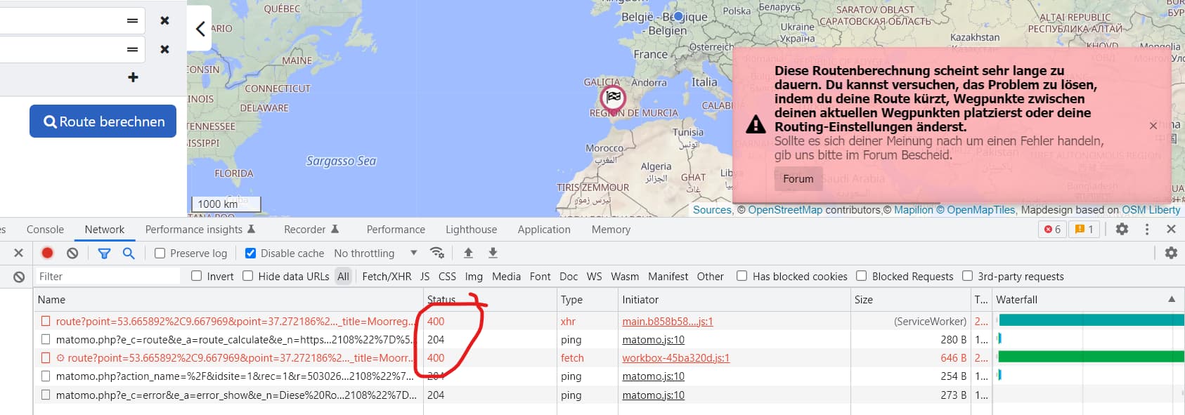

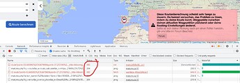

In browser on PC it is easy to check:
  • plan a long route with crazy setting https://kurv.gr/kkcqX
  • open debugger (chrome: shift-ctrl-I)
  • go to “Network” tab in debugger
  • press “Calculate Route”
After a short time you can see, that the server response 400 (bad request) is sent, the browser shows the known error message:

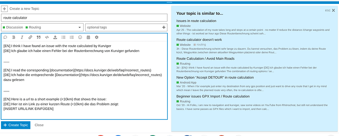

Thanks for the idea, we can think about this. The forum software also proposes similar topics when you create a new topic. Maybe we can improve this somehow?

If I click my “crazy route” link above and afterwards the “Forum” button in the red error window, a new tread in the forum is created - without a hint to similar threads.
Perhaps such a hint is given when clicking “Create tread” - I did not test that because I do not want to create a spam thread.
