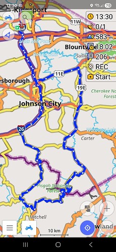

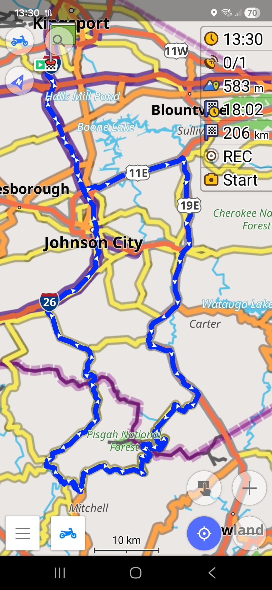

I’m using Kurviger. I only ended up using Rever or Google Maps after Kurviger added unwanted turns to my route. It’s almost as if it was dynamically changing my route for whatever reason, but I wasn’t deviating from my planned route. I know Google Maps is great for instantly recalculating routes if I deviate for some reason, but this was a static route I planned beforehand and then loaded up prior to my trip. I will try to attach the route file for you. One of the extra turns it directed me to was just after Shaping Point 22 (wanted me to turn left onto Bear Cage Road) and then one other, but I don’t recall that location. If you’d prefer it in .gpx format, let me know and I’ll add that.

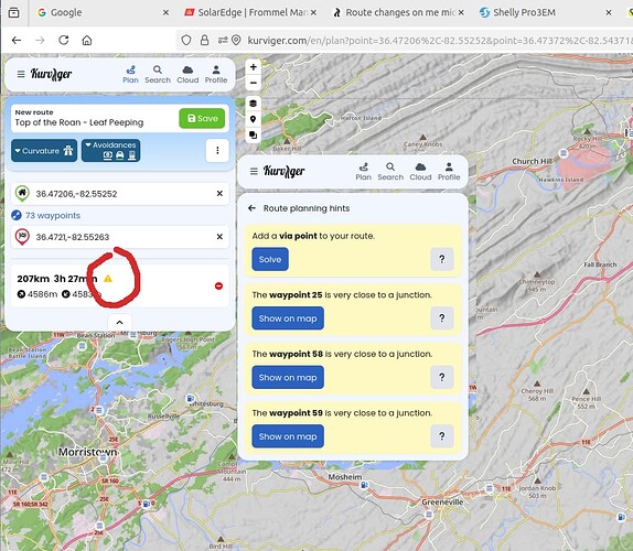

IMHO you have set way too many shaping-points, which are often placed unfavorable.
  • some of them are close to intersection
    Stay away from intersections and nearby roads!
  • some are close to each other
    They might interfere which each other.
General rule of thumb is ~ 10 WP / 100km.
In other words not more than 20 waypoints per 100 miles.
When you click on the yellow sign, Kurviger gives you a warning about the placement of some waypoints.

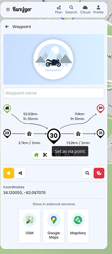

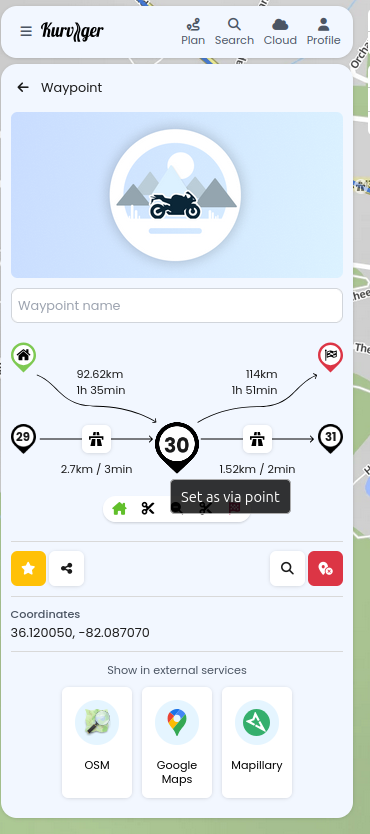

WP33:
If you want to stop there, it would be better to change shaping point 33 into a via point.
  • The routing system treats via points as mandatory.
  • Via points are announced in navigation.

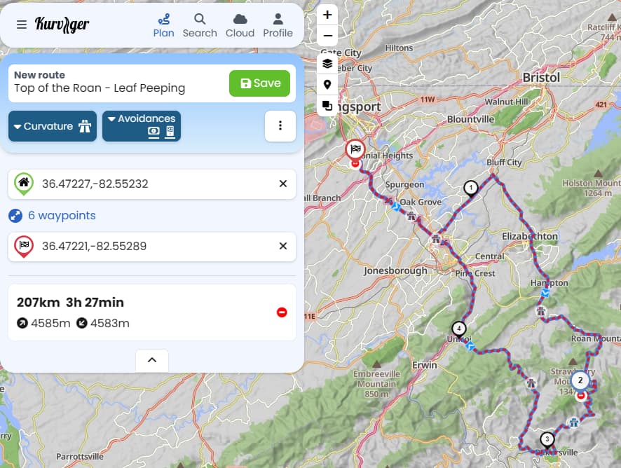

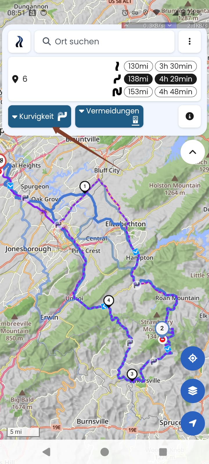

6?
4 - including the real via point from the original route
When I want to be sure, the route is quite strict, I start with only a few points, as these 6. I switch then between planned curviness and all to see where the route can break out. I set as many SP as required, until the route does not break out anymore.
I guess, the truth will be between these 6 and the 25 of mine. My lazy proposal was just the optimized import in Kurviger from gpx.
Thank you, everyone! I guess I’ll have to play with the curviness settings more as I plan. This particular route is pretty straight forward. I have over 100 routes mapped out in my area that are much more complex due to the roads, but this will help. I very much appreciate your help!
Curvines and avoidances. If you want to drive on a motorway, you should not activate the motorways in the avoidances. Otherwise you will need a lot of shaping points to force the route along them. Your route without avoiding motorways: https://kurv.gr/SdUBv
