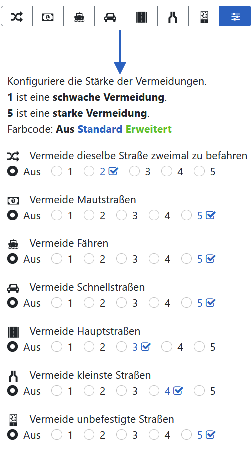

Just to be clear: the shown settings are Kurviger’s default values! :wink:
Yes, but they are all active, by default they are not active, meaning off. If you enable all avoidances, this might result in weird routes at times.
Ok, but how do I “reset” the values to its defaults then?
When clicking the icons (so that they become black/not active) and open the settings, all avoidances are shown as “off”!?

I assumed to deactivate them (black icon) means that all are “set to off” (0), and setting them to the blue colored values means “set them to defaults”. Which is wrong as it seems!?
So again: does the following setting mean “all is set to default”, or does it mean “all is set to off”?
grafik
What am I missing?
When there is no number at the icons it means, that for the icons the selection is “Off”.
When at an icon there is a number then this means that the avoidance is selected. The number shows the strength of the selected avoidance.
