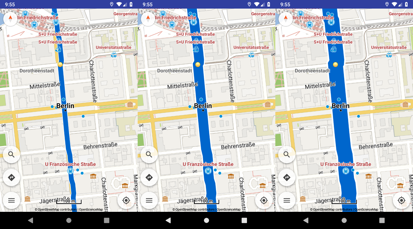

Here is how route appears on zoom 16 with width 100% vs 200% vs 300%:
looks good for me at 300% if I had this while driving, but I understand it is not possible because the AutoZoomLevel is limited at 18 and this looks on my device like mixture between 100 and 200 %, let’s say 150%.
What I don’t understand is why limit it? If it is optional, then everybody can set it at the own needs, the one at 100, the other at 150, me on 250 or higher… just let me try how it looks while I drive… :slight_smile:

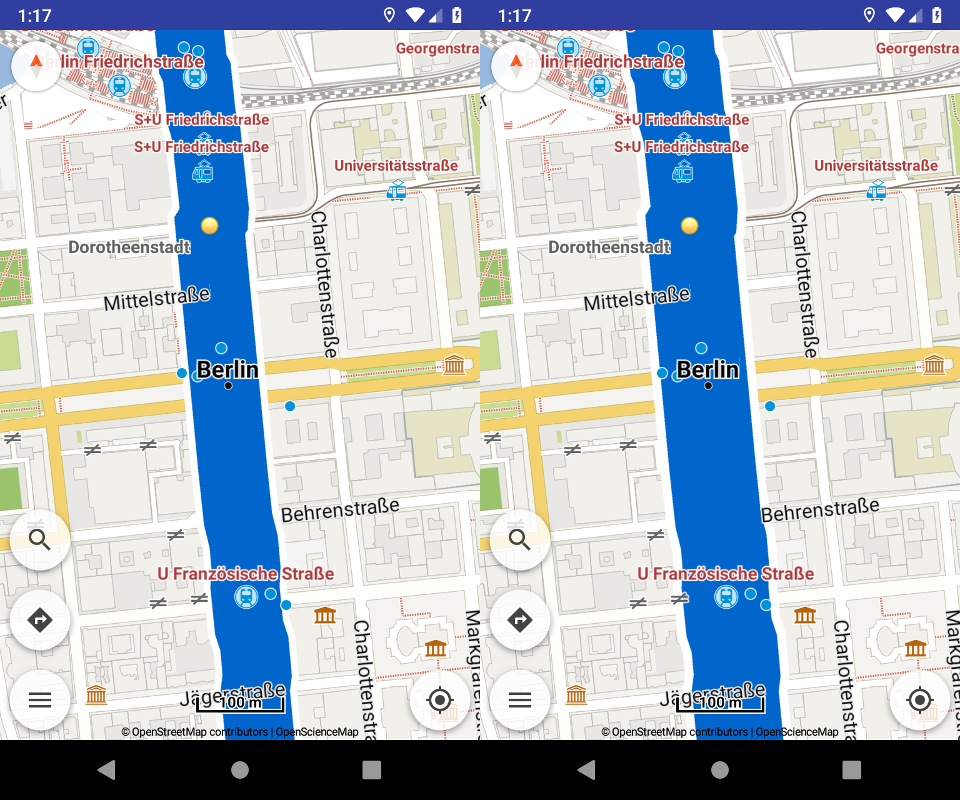

Here is how route appears on zoom 16 with width 400% vs 500%:
Such large widths have minimal use, since no curves can appear.
this is more than 1 kilometer… don’t know how it is in the US (:wink:not to mentioned big cities like Berlin :smile:), but here (Hunsrück, Vogesen, Black Forrest) can be more than 50 curves on this distance and additionally you are using 960800, I use 22001080 pixels… 400% would be good at this resolution I think.
Those are just scaled down large images.
ok “give gotten” (translated 1:1 from german), nevertheless let’s compromise to 400% (it’s just a figure on a scale bar) :flushed:
