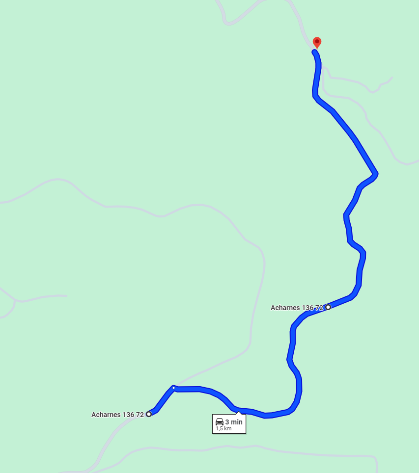

Google Maps routes this way:
So if you want to “force” Kurviger to route along there, this is only possible with Beeline

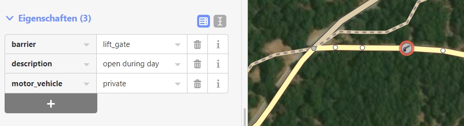

@greekmountains is this really a private way as indicated in OSM? It is not in Street View, so maybe it is for private use only.
Because there are more lift gates, like this one further down the road: Node: 6876055725 | OpenStreetMap
