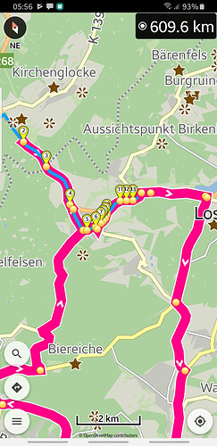

There is a strange error in routing. I am using version 1.11 with Google location on on an Android 9 (API 28), samsung SM-G955F.
The automatic recalculation is active. I just entered a destination from actual position and I didn’t drive as planned and often changed the direction so that recalculation was used. The software created automatically additional waypoints and I coulnd’t delete them with the skip waypoints functions. It just didn’t delete any waypoint of the additional created ones. You see the many waypoints set within a small distance, I didn’t create them. They were created by Kurviger while driving and recalculating. I have used the skip waypoint function many times in order to delete them again, but it looks as if it created waypoints instead of deleting them.
 ![grafik](https://forum.kurviger.com/uploads/default/original/2X/a/af621555d59f6b2f8ab00e2ac1a9a0b823d31a45.jpeg)

_To everyone like we have mentioned already many times and exists in reports template:
Please provide route link examples when make reports and also detailed instructions where exit / enter or make any route actions. Or else it’s impossible for anyone to actually invest time to understand just the images / text (though they’re needed too) and check any reports._

Skip next waypoint should do what its name declares, skip the one (next) waypoint ahead of user location.
Rerouting may create one extra waypoint _while navigating_ and have enabled “Nearest point on route” in settings or when _begin navigation_ away and select “Start” in rerouting dialog.
If be on a road where route goes forward / backward, then strange things can happen, specially if GPS sensor declares that vehicle snaps in the opposite direction.
That’s a fundamental issue that all navigators have and obviously is more prominent in non usual round trips, since most people tend to use more the common AB routing.

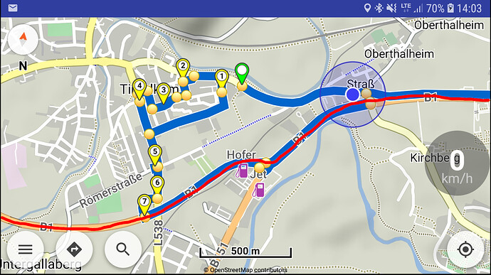

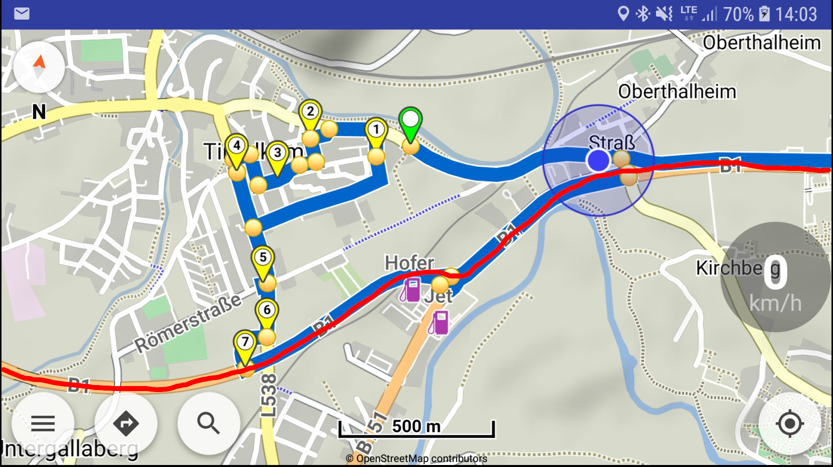

Ok, that would be the behavior I would have expected, but my experience also was a different:
I was driving this route [https://kurv.gr/ZehtE](https://kurv.gr/ZehtE)
Then I left it here:
 ![image](https://forum.kurviger.com/uploads/default/original/2X/7/7128a5bc1dbc4de73ecf8064753943beb4b05a84.jpeg)
The app started to create waypoints. Even when I was near the original route again, the automaticaly generated waypoints weren’t deleted any more. The app continued to navigate back to exactly the position, where I left the original route for the first time:
 ![image](https://forum.kurviger.com/uploads/default/original/2X/7/73bf24fb6ab6fa33e0fb2a3d331bcb377388abf4.jpeg)
The red line is the original route.
“Nächster Routenpunkt” was enabled
That’s not the behaviour expected.

Thanks for the example.
> [@grua](#):
Have explained above about new waypoints in rerouting, as depend on [rerouting options](https://forum.kurviger.com/t/rerouting-options/1934).
_If after rerouting location remains away from route, then new rerouting can happen again._
> [@grua](#):
There isn’t any original route after a rerouting, only the new calculated route.
And obviously cannot delete any waypoints automatically, users can do that.
> [@grua](#):
The app tries to navigate always to the route (via [orientation arrow](https://forum.kurviger.com/t/beeline-like-orientation-arrow/694)) based on [rerouting options](https://forum.kurviger.com/t/rerouting-options/1934).
Can change the rerouting option if want a different navigation behavior or use [manual rerouting](https://docs.kurviger.de/app/faq/navigate_with_manual_rerouting).
Like the “Next unvisited waypoint” rerouting option which is the recommended default anyway.

sorry, didn’t have time any more to follow the discussion and also can’t upload the link anymore, but obviously I am not alone with this problem. My problem occured with setting “Next unvisited waypoint” which is my default.
It could be that the internet connection was very poor and the app permanently recalculated while I tried to use the function “skip next waypoint”. Potentially this deletion of next waypoint is not working while recalculation? It maybe requires a new calculated route before next waypoint can be skipped? My intuitive behaviour would be that the next waypoint is deleted when I use this function, then the recalculation starts again. For sure I have used the skip next waypoint function more times than the number of waypoints had been automatically created so I guess the deletion doesn’t work in this case.

> [@Tom](#):
@grua had “Nearest point on route” option selected, which [adds a waypoint](https://forum.kurviger.com/t/skip-waypoints-not-working-and-strange-automatic-set-of-waypoints/2434/9) on rerouting:
> [@grua](#):
> I also think "Nearest point on route” was enabled.
> [@Tom](#):
“Next unvisited waypoint” cannot add new waypoints.
It uses user location as start and all existing unvisited waypoints in new route calculation.
> [@Tom](#):
There is always an active route on navigation.
“Skip next waypoint” currently uses internet, as does a new route calculation (with one less waypoint).

> [@devemux86](#):
ok then this is the explanation why the waypoints didn’t disappear
How do you then explain the many waypoints in a small distance on my screenshot above? For sure I didn’t create them and for sure I had “next unvisited waypoint” active since I don’t like the automatic deletion of waypoints.
<div class="post-metadata">
**Post date:** [November 3, 2019, 1:15pm UTC](https://forum.kurviger.com/t/skip-waypoints-not-working-and-strange-automatic-set-of-waypoints/2434/15 "2019-11-03T13:15:36Z")
</div>
> [@Tom](#):
Cannot know what happened there, everyone can only estimate. 🙂
