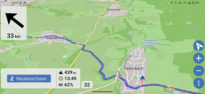

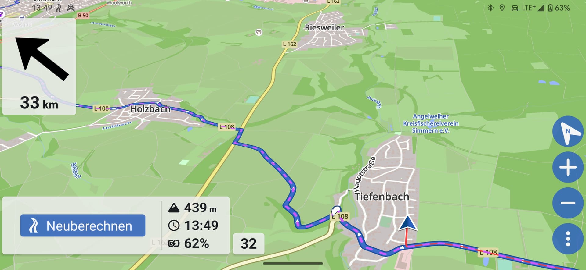

Wenn man die geplante Route verlässt, verschwindet auch die Geschwindigkeitsbegrenzungsanzeige. Immer. Siehe Screenshot im og Post
Das Thema müsste passen. Wenn Du off-route bist, hast Du keine Route. Ohne Route keine Geschwindigkeit.

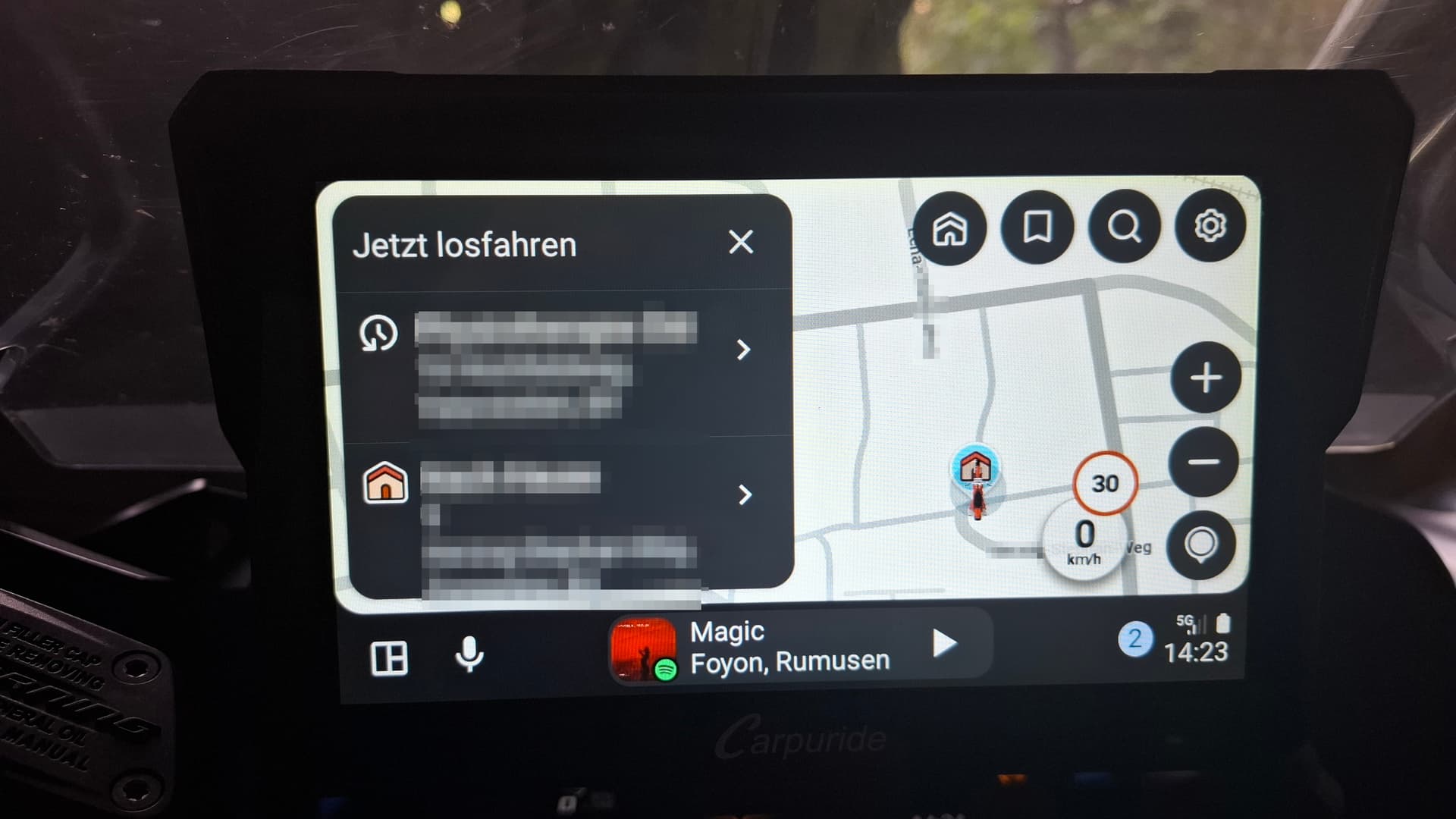

Zumindest hat Waze diese Anzeige immer drin. Auch ohne Route.
Hier stehe ich einfach nur in meinem Schuppen und Waze läuft auf dem Carpuride ohne Route.

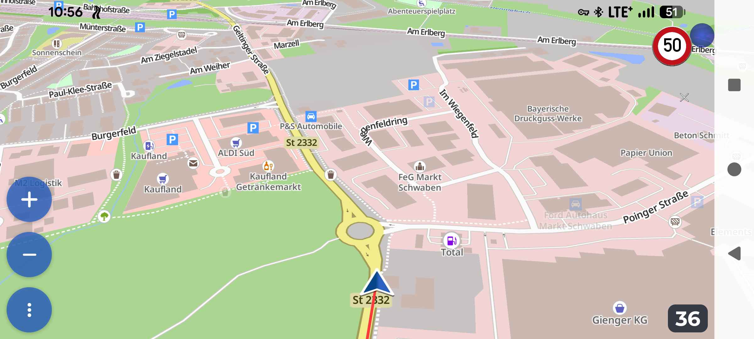

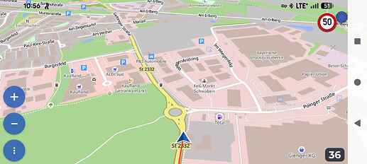

For more than 5 years, I’ve been able to view the speedlimit regardless the used app, even when I’m off the planned route and without needing an internet connection (and without dancing on the table). Here as an example a screenshot of the Kurviger app in Follow Mode:

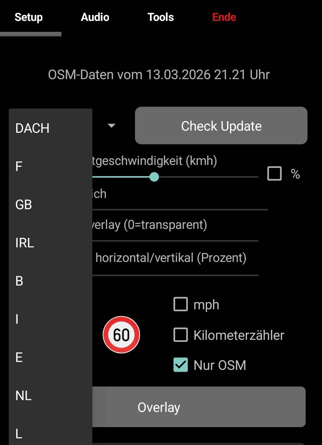

The size and position of image as overlay can be customized. All speedlimit data is extracted from OSM and stored on the smartphone (~378 MB for DACH). However, it is limited to some European countries:
Tempo Master is no longer available in the Google Play Store, but can be downloaded here: https://tempomaster.apkcafe.de/. There are also a variety of screenshots, and further information is available on the homepage of Tempo Master.
