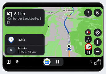

  • Problem: icons on the map (fuel, lodging, etc.) are too small to see clearly on the Android Auto screen
  • Problem: when you select specific POI categories to show, they aren’t displayed larger/more prominently than the rest on the Android Auto map
    Wish: show selected categories larger
Problem: there are many unnecessary icons on the map (e.g. all property gates/fences), cluttering the Android Auto view
Wish: better filtering of irrelevant icons

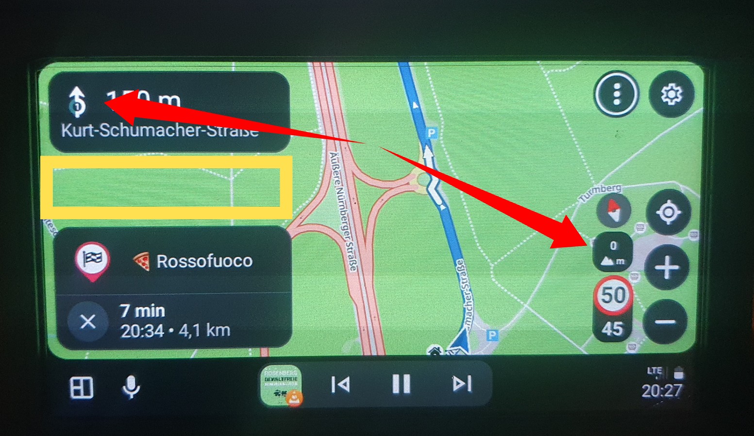

  • Problem: on the phone, both the next via point and the final destination are shown, but on Android Auto you only see the next via point — so you don’t know the total remaining trip duration
    Wish: also show the final destination (and total trip duration) on Android Auto, matching the phone view

Cluttering was not the right word. What I wanted to say is that there are a lot of tiny icons. And they are difficult to distinguish. Not if the device is in front of your nose on the couch, but during a ride when the AA device is an armlength away.

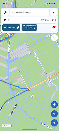

But let me show you what I mean.
In the screenshot a tiny segment of a route.
You see three gates and one restaurant. Here on the screenshot and holding the phone in front of my nose the icons are recognizable. But when on the AA screen an arm length away I can only see there ar icons, hardly what they are.
So it would be great if next to selecting what poi’s you want to see on the map the items you select, like restaurants, hotels and fuel stations would be shown twice as big as now.. So they are well recognizable during the ride.
I only referred to the gates as an example. If you can’t filter them out, fine with me but the important poi’s need to better visible.

One more example
12 gates in this small section. Sometimes I’m driving sections in Nl and there is a farmers gate every 10mtr or so. I gues.the amature osm editors are very busy here​:wink:
Bit again it is not so much about the gates. It is about not being able to see selected poi’s properly.

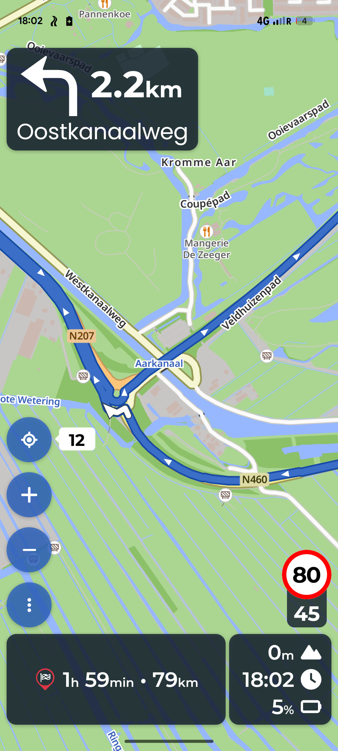

  • navigation: the exit number inside the roundabout sign is super-super small. Sometimes I even have to lean forward and read the number from the screen. I mean the number that appears inside the arrow, like 1,2,3 and so. This is so annyoing and sometimes I missed my exit of course due to the unreadable number.

I understand that you think the number is small. The question is how to display it more effectively, because if you simply want to make the number larger, the icon and the box need to be larger as well.
That said, it’s also only meant to provide additional guidance. The exit is already indicated visually and announced audibly. :thinking:

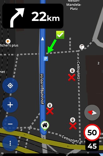

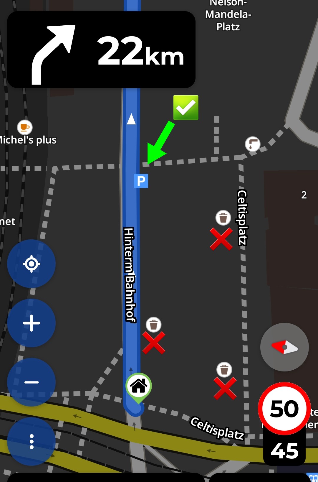

@Miki1 does not “think it is small”, the exit numbers are small. Half the size of the next smallest thing which ist the altitude (which is also challenging to read). TBH, they are so small, that I did not realize there is a number there until someone complained about how small they are and later read in release notes.
That would not be a problem since the box width will not grow and the yellow rectangle is irrelevant for the navigation anyway.
But there is another possibility - make a better icon. The arrowhead is huge. A bit smaller arrow, a bit larger circle and a bit thinner line - a bigger number will fit.

But what is better? I don’t think your suggestion is the perfect solution either because with this version, the arrow is less prominent, so it becomes a question of what should be more visible: the arrow or the number.
For me, the arrow is more important. Map data isn’t always 100% reliable, and especially at roundabouts, the exit count can vary depending on how additional roads are mapped.

Why??.. Even though my AA device has a 7" screen kurviger lacks visibility and accessibility of, let’s call it, secondary info.
You have added gas stations as kurviger poi, but they are almost invisible to me But you can select them and add them to the route as you go. So that is the required functionality, but visibility is almost null.
Other important categories like hotels, restaurants are only available as icon from the osm source, also almost invisible due to the microscopic icon size and not accessable as data at al.
