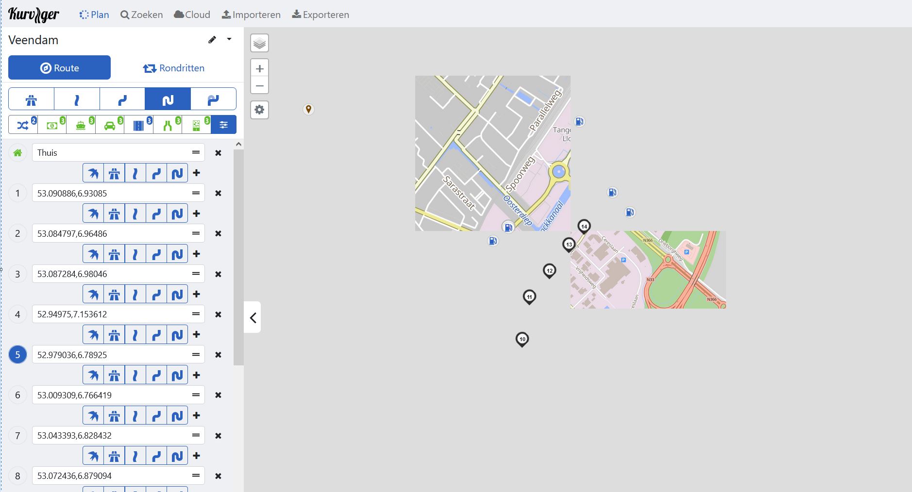

Updating map while zooming very slow
When zooming in or out the updating of the map is very slow. When zooming out, gray area’s are showed, I have inculded a screenshot.
When zooming in, the maps gets blur.
Sometimes I have to wait for over half a minute before the map is shown correctly.

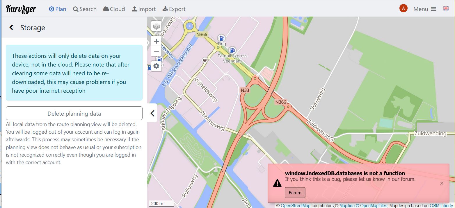

When tying the feature I get the following error.
Clearing the cache in firefox using this procedure https://support.mozilla.org/en-US/kb/how-clear-firefox-cache and restarting firefox after does not solve the problem.

You seem to have set up your Firefox to “Strict Privacy”? I can see if we can work around that error in the future.
My privacy settings are set to “standaard”
Ah I see, we have updated the delete cache feature, this should work now in Firefox browsers as well. Please make sure to load the new version before using the feature :slight_smile:.
The delete cache function works now and it solved te problem with slow updating of the map.

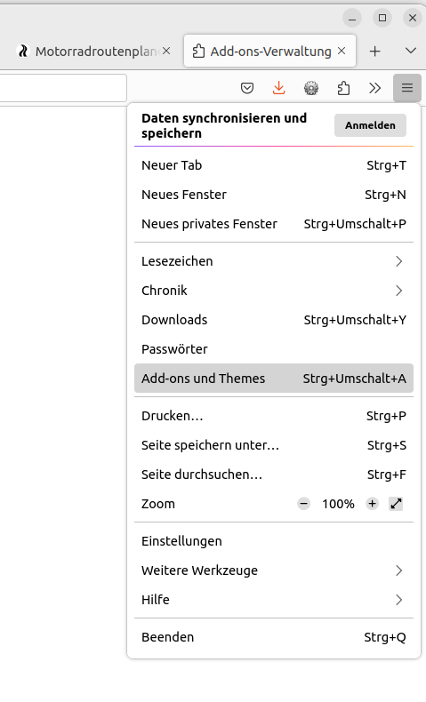

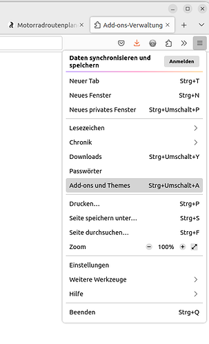

Was passiert wenn Du Kurviger mit “Neues privates Fenster [Strg+Umschalt+P]” öffnest?
Hast Du irgendwelche “privacy” Add-ons installiert?
ich habe keine add-ons installiert und alles abgeschaltet,was eventuell für eine Verzögerung in Frage kommt.
