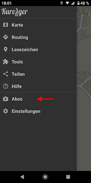

Eigentlich nicht zu übersehen:
 ![2022-03-05 18.01.07](https://forum.kurviger.com/uploads/default/original/2X/2/2a30c361e4fba5e3ed5e0d9a78ec2e3ab41a1c28.png)
Und kokettiere nicht mit Deinem Alter … 😇

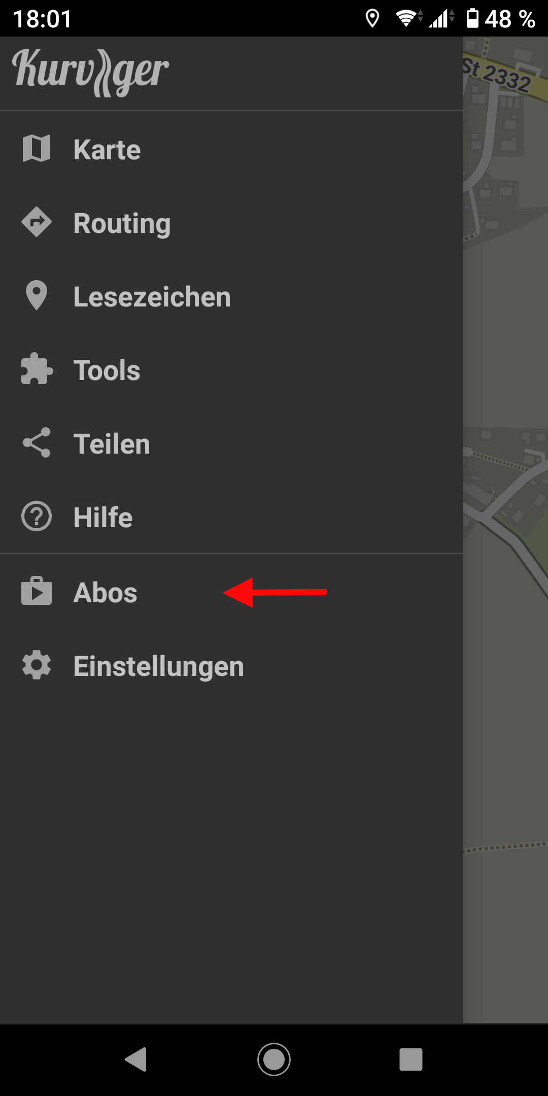

Da hatte ich schon geschaut, und vermutet es würden nur bereits abgeschlossene Abo`s angezeigt.
Internetverbindung habe ich per WLAN, funktioniert auch weil das Installieren geht auch.
GOOGLE Play Fehler ??
[![](https://i49.servimg.com/u/f49/20/21/81/69/screen10.png)](https://servimg.com/view/20218169/133)
<div class="post-metadata">
**Post date:** [March 5, 2022, 7:00pm UTC](https://forum.kurviger.com/t/wo-ist-der-abo-button/7638/5 "2022-03-05T19:00:54Z")
</div>
Google Play (with an active Google Account) gets locally the subscriptions from Google servers.
Then apps ask Google Play for the available subscriptions to display them.
(these external processes require an active internet connection)
Your screen shows that Google Play subscriptions do not work properly on your device.
What device and Android?
Is it a custom Android rom?
How did you install the app?

- Device HUAWEI SCL-L21 Y6
- Android 5.1.1
- _@ devemux86 Is it a custom Android rom?_ No changes on the Mobile, set it back to factory settings before
- Installed the APP from my Google Play Account.
(If I use another Mobile (Android 11) and same account it works.

> [@Kallewirschtl](#):
> - Android 5.1.1
This is a very old Android.
If device manufacturer does not update Android
or Google does not update Google Play app and [Google Play services](https://play.google.com/store/apps/details?id=com.google.android.gms),
then maybe that Google Play cannot connect and find any subscriptions.
Probably because its Google Play app / Google Play services are updated.

Thank you,
I Updated everything which was possible.
because of the set back to factory settings it took a while to get all the updates.
Now it works.
