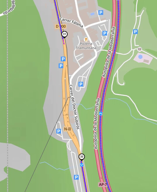

Hello,
I’m trying to connect two crossing points 300 m apart in Le Perthus, at the French-Spanish border and in the direction of Spain towards France (no problem in the direction of France towards Spain). But Kurviger is doing a 20 km bypass for “Potentially closed due to border control.”
Can you resolve this issue?
Many thanks for your help
Address of crossing point No. 30 :
N-2, 17709 La Jonquera, Girona, Espagne

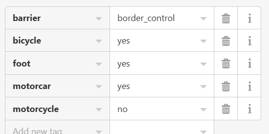

I guess I found the route part. Must be something different, perhaps OSM. When start and end is reversed, it works. Not checked in detail.
Use the beeline to connect the two points until the problem is solved…
Someone put some questionable constraints - in one direction the border can not be crossed by the motorcycle - that does not sound right. Anyone here with local knowledge?
At the border control there was a motorcycle=no tag.
I changed that as it is unplausible.
On Mapillary, you can see a “normal” border control. I didn’t see any signs that prohibited motorcycles.
Let us see if Kurviger will route there in 2-3 days.
It works now.
@linux-user the “tunnel” should be removed as well, right? Otherwise one could say that every covered gas station is a tunnel, which is not the case.
