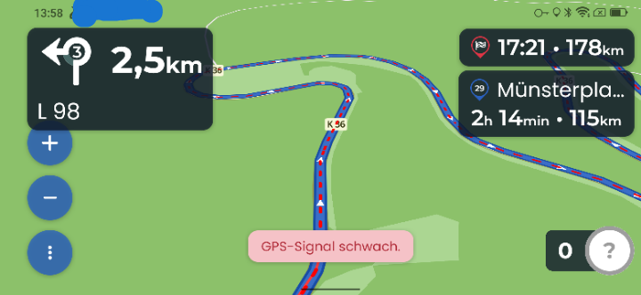

Weak GPS signal
For quite some time now, I very frequently get the message that the GPS signal is weak. The GPS signal is always strong enough for navigation to work completely without issues. Other apps do not have any signal problems. The message is displayed throughout the entire trip. Sometimes it disappears briefly in between.
I noticed that this issue already occurred in Android 3.6.1, and it is still not resolved with Android 3.6.6. It is quite possible that I’ve had it since 3.6.1; I didn’t write down when it first happened.
It’s annoying that it is displayed right over your own position. When navigating through a series of curves, you can no longer see where you are.
Suggestion: The message could be displayed somewhere at the edge of the screen or disappear again after a while. Or make it possible to disable it.
Thanks for reporting, we’ll take a look at that!
Thanks for reporting, I actually assumed this problem no longer existed. We’ll have to take another look at that.
Do you have a bit more info about the device you are using, etc. (e.g., the debug info from the Kurviger settings) and your setup—is your smartphone connected via hotspot? Do you have anything special installed or running in the background? Have you hidden any icons in your status bar?

I only use my phone as a sat nav, hence the hotspot connection. Naturally, I have various other apps on it. Which ones are considered “suspicious”?
Thanks for the info.
All apps that run actively in the background. Off the top of my head, I’d say any apps related to location or, for example, privacy / security — basically any apps that could alter your location. I specifically asked because in the screenshot above, the status bar is partially covered, as if something extra were running there.
A lot is going on. I don’t want to post it here. Can I share it another way?

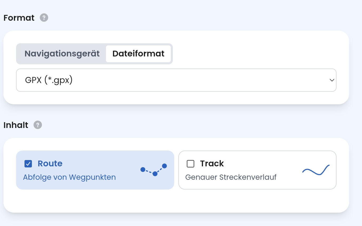

Does it work without “Garmin Waypoints”, for example, or does any GPX file work, meaning via the GPX file format?
Ok great, then it’s probably not a general issue :slight_smile:

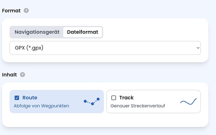

I think we’re on the track of the problem. I imported a route that worked previously into the Tread app using these settings.

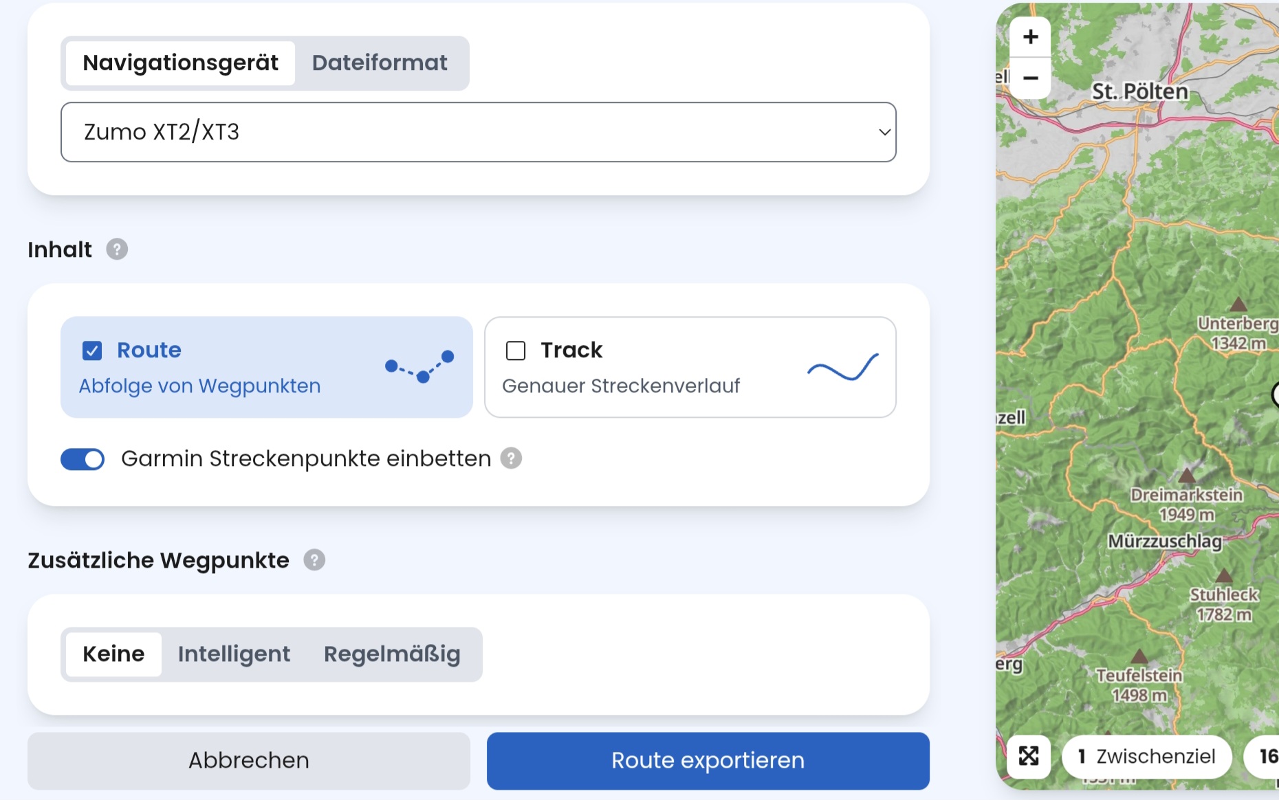

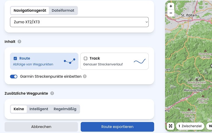

Route calculation works again. Then I exported the same route with the recommended settings from Kurviger (Zumo XT2/XT3, embed Garmin via-points), and imported it into the Tread app — route calculation not possible.
If I interpret this correctly, then my problem has nothing to do with my Tread app (up-to-dateness, settings), but rather with the fact that the exported file format or metadata cannot be properly interpreted by the Tread app, right?

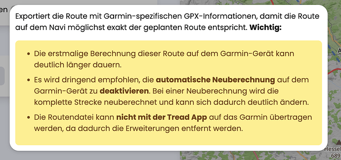

That’s a possibility, yes. The Tread app has discarded via-points anyway so far, if I recall correctly, so it’s not a big deal if you leave them out for the Tread app.
If you want to use the advantage of via-points, you would have to transfer the file without Explore (there are quite a few videos by Rhönschrat about that).
Thanks for the tip, I’ll check it out, and above all, a BIG thanks for your support! It would still be cool if it worked again with the recommended settings, though…
However, I would like to point out that we also explicitly recommend not using the Tread app with waypoints :wink:
So, anyone who wants the closest possible match between the planned route and Garmin should avoid the Tread app. But the transfer should, of course, still work with the Tread app.
