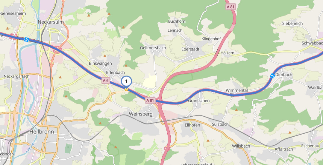

What would need to be changed in OSM here (Kurviger – Motorcycle Route Planner & Navigation) so that Kurviger says “keep right for A6”:
Today I accidentally drove straight onto the A81 because there was no announcement.

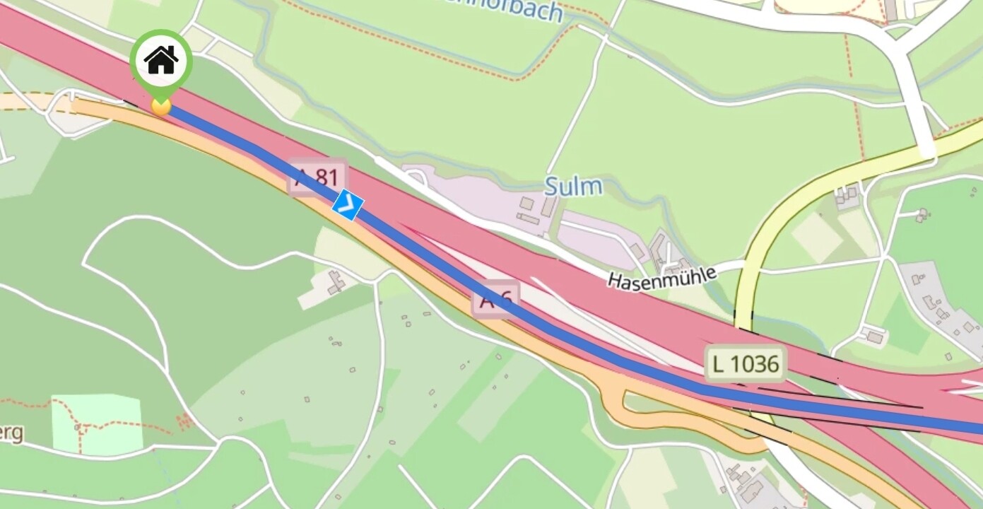

We have a potential fix in mind here, but it’s going to be a bigger task. Given the options currently available to us, this is a really tricky spot. The left lane is a motorway_link to another highway, while the right lane is a motorway onto the same highway (A6). Therefore, it looks like following the road layout, which you generally don’t want announced constantly.
That is indeed a somewhat unusual highway interchange, where you have to turn in order to keep going straight on the same highway — where you actually change highways if you just drive straight ahead.
You were lucky that the next exit was close by, I hope you used it!
The difficulty isn’t just the motorway intersection itself, but also that Kurviger is completely silent for over 200km on that stretch of road. That really catches you completely “off-guard” (caught in the fast lane). I didn’t expect the next turn instruction for another 140km or so, and visually it’s very hard to tell on the map that you have to turn off somewhere, because the route just continues in the plausible direction. My first reaction wasn’t to change lanes, but rather - “Ah, another one of those ‘weird detours’…”

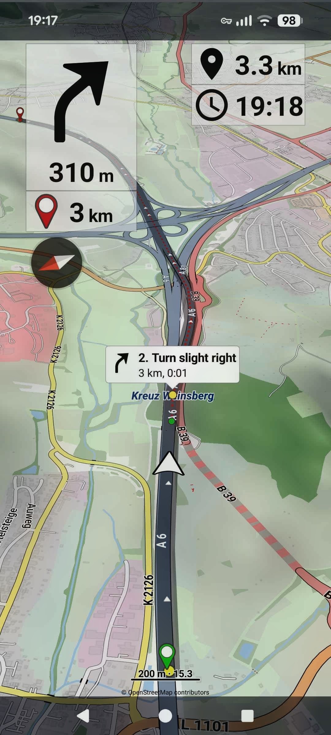

But BRouter somehow manages it… ![]()
Still, hey - that’s just another edge case - who drives on the A6 voluntarily? ![]()
Giving an announcement at every turn is easy (and annoying
). So you have to find the middle ground here: what gets announced and what doesn’t. I haven’t looked into how BRouter does this in detail yet.
However, I still see a concept for future improvements on our end, but as I said, that’s a bigger topic.
I don’t want that either. I really appreciate that Kurviger doesn’t chatter too much. Maybe that’s only relevant for highway interchanges — then it won’t be too annoying.
