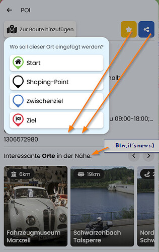

If I got you right you want 4 interactive buttons (Start, Shaping, Intermediate, End) between the ‘Add to route’ and ‘Favourites’ button? Like this:
If so, I would say there is no more need to have the ‘Add to route’ button. Let’s wait for some more feedback on your proposal.
I fully understand this wish, but I see this as a possible improvement for power users. Having only the icons, it does not explain anything for a new or an average user.
From my experience, when recommending Kurviger, a lot of questions are coming after they made their first route. Most of them do not even recognize the star as a button to add a favorite. One friend even has chosen another software (less powerful, less functions) as it was more self explanatory for her. I think none of them will become a power user.
With this experience, I would rather go the other way to simplify stuff by always adding a text label to be self-explanatory, even if it means, I have additional clicks or I have to scroll a little bit more.
Edit
Or as compromise it could be like in the app, when adding a waypoint; displaying each function as an Icon with text label. I would also prefer to dissolve the marked additional functions in favour of icons.

Yes exactly. We actually used to have the buttons 4 buttons there instead of the add to route some time ago.
We changed that to “Add to route” to make clear what will happen if you click the button.
If there is just a button labeled start, it is not clear what this button would do.
Does it add the point as start? Does it replace the start? Will only the start waypoint open?
If we make the buttons for POIs that large, we loose too much display area. For POIs the content of the POI is the first thing you need to know (like name, opening hours, or some other info). And only if that makes sense for you, you would want to add this point to the route.
With all that said, I do understand that in some cases it would be nice to avoid having to do another click to add a point to the route, but I am not sure if just adding more button to the POI view will actually help the view.
