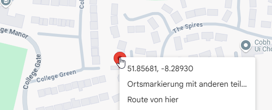

I solve such problems in the following way: In the PC browser, I click with the right mouse button on the position on the google maps map, and in the window that opens, I click on the coordinates in the top line. This copies them to the clipboard. You can paste these into the Kurviger search field and insert the position found as a shaping point or intermediate destination.

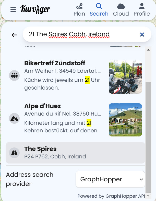

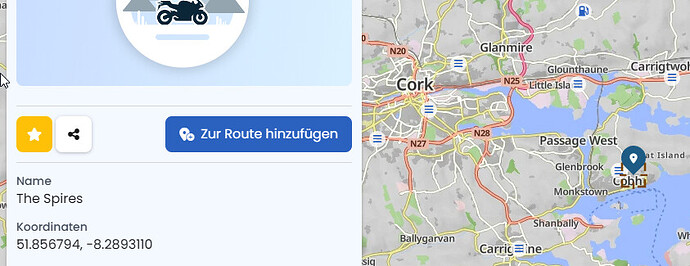

Out of the three places above, (I think) I managed to find one using Kurviger:

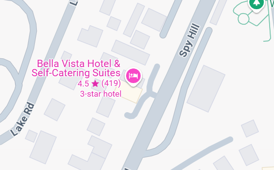

My conclusion is - you cannot find these places as they have not been mapped in the OpenStreetMaps. Apparently, the public good like OSM is not very popular in Ireland, at least not in this region.
If you compare the areas from
Google Maps:
and
OpenStreetMaps:
you will notice that parts of the streets in front of the hotel are missing and there is no indication that there is a hotel there. If you take an even closer look - you will see that many buildings in the area do not even have house numbers.
So, although I personally think that Kurviger search function has much room for improvement, in this specific case it appears that the underlying data is missing.
I do it with this address:
right click on google maps

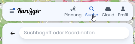

open the search field in Kurviger:

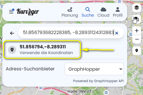

Insert coordinates with CTRL-V
click on the entry below
the point is marked and you can insert it as a waypoint
