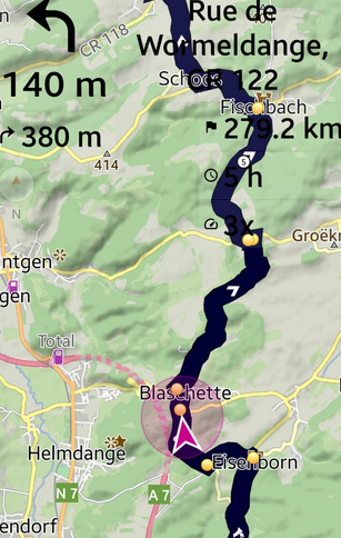

The overview is not useful to me since I mostly plan day trips of more than 300km, up to 500km and when then the overview mode is used, everything is so small that it is not useful any more to have a tour overview where the position follows the GPS position (follow mode).
I would prefer more configurable in detail. Either by setting in section steps for example showing only the next 5km, 10km, 20km, 50km, 75km, 100km sections starting with the actual GPS position or something like show a percentage of the route overview.
Theoretically it could also be speed based: more zoomed in at higher speed and more zoom out at lower speed. Similar to the Min/Max Auto Zoom step and Zoom step outside of the route a boundary “from… to” kilometer could limit the max overview zoom level.

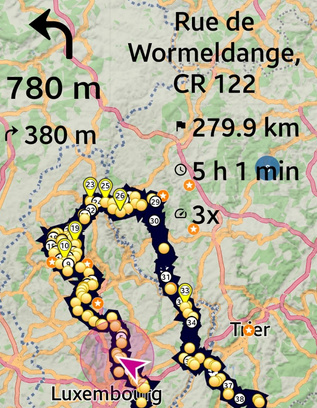

But what I see is the complete route (at the moment I use the simulation mode)
and when I manually zoom, this zoom hold only for some seconds and then goes back into showing the full route
My intuitive way would be holding the overview mode until I set back to normal 2D or 3D mode again and also keep the manually set zoom and not set back after a few seconds like it is done in 2D and 3D follow mode.
