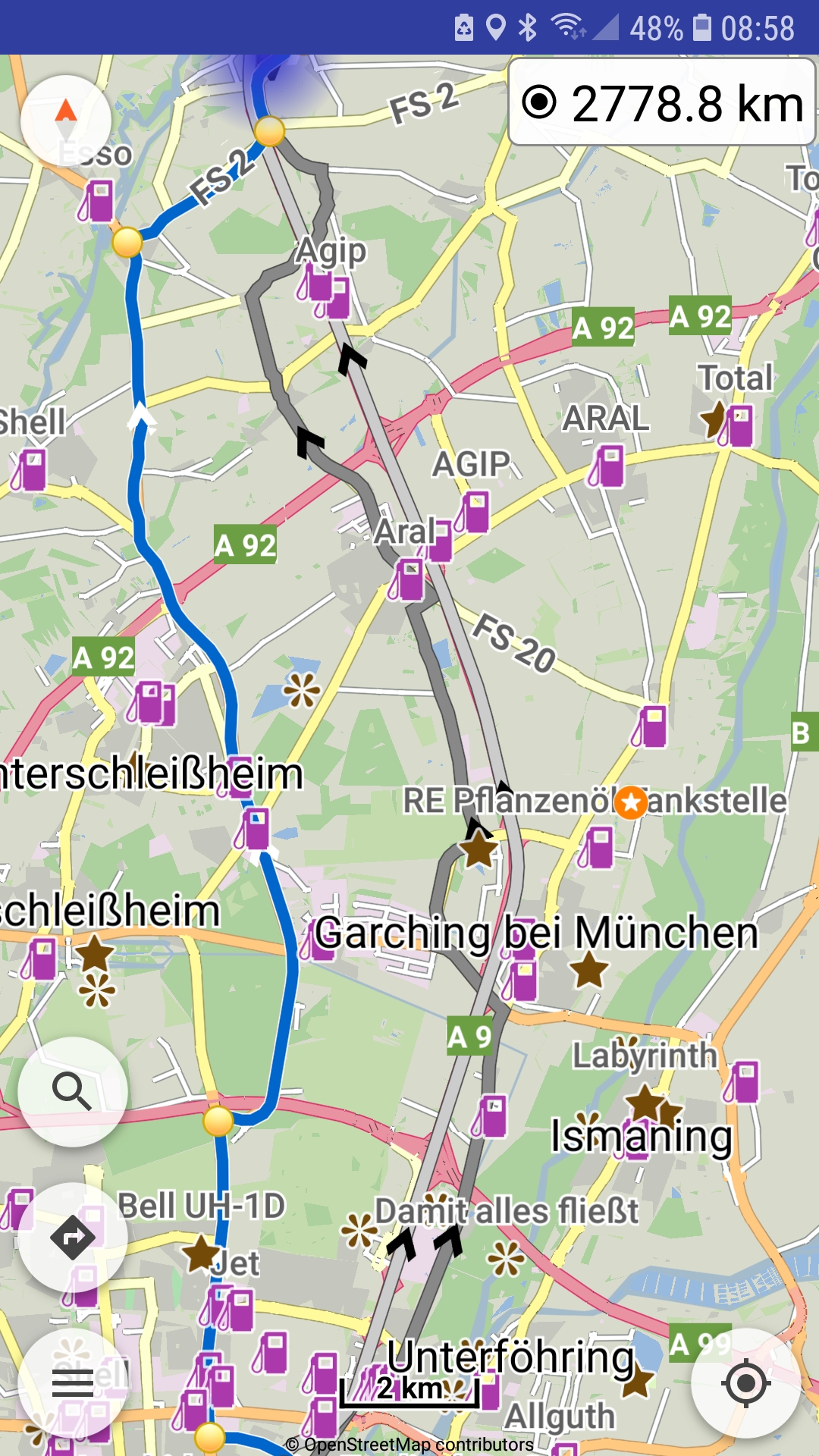

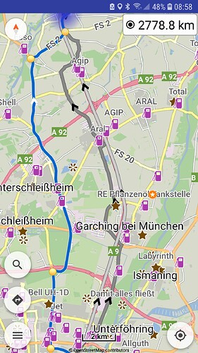

I think, the situation was something like this:
https://kurv.gr/yzNnE - All curvy routes
  • I was on the “A9” (=Motorway) when rerouting was triggered
  • The “selected” route was “extra curvy
  • But the first played voice instruction (after rerouting) seems to belong to the “fast and curvy” variant on the “A9”
Does this make sense?
Manfred
Thanks for the detailed report and the route example!
Where exactly the rerouting happened?
Is the new calculated route available?
Are you sure that the “After instruction points” option triggers that, if have it off are instructions correct?
Where exactly was that?
What was the wrong instruction and what the correct one?
Where exactly?
No, only the active route (blue in image) participates in navigation.

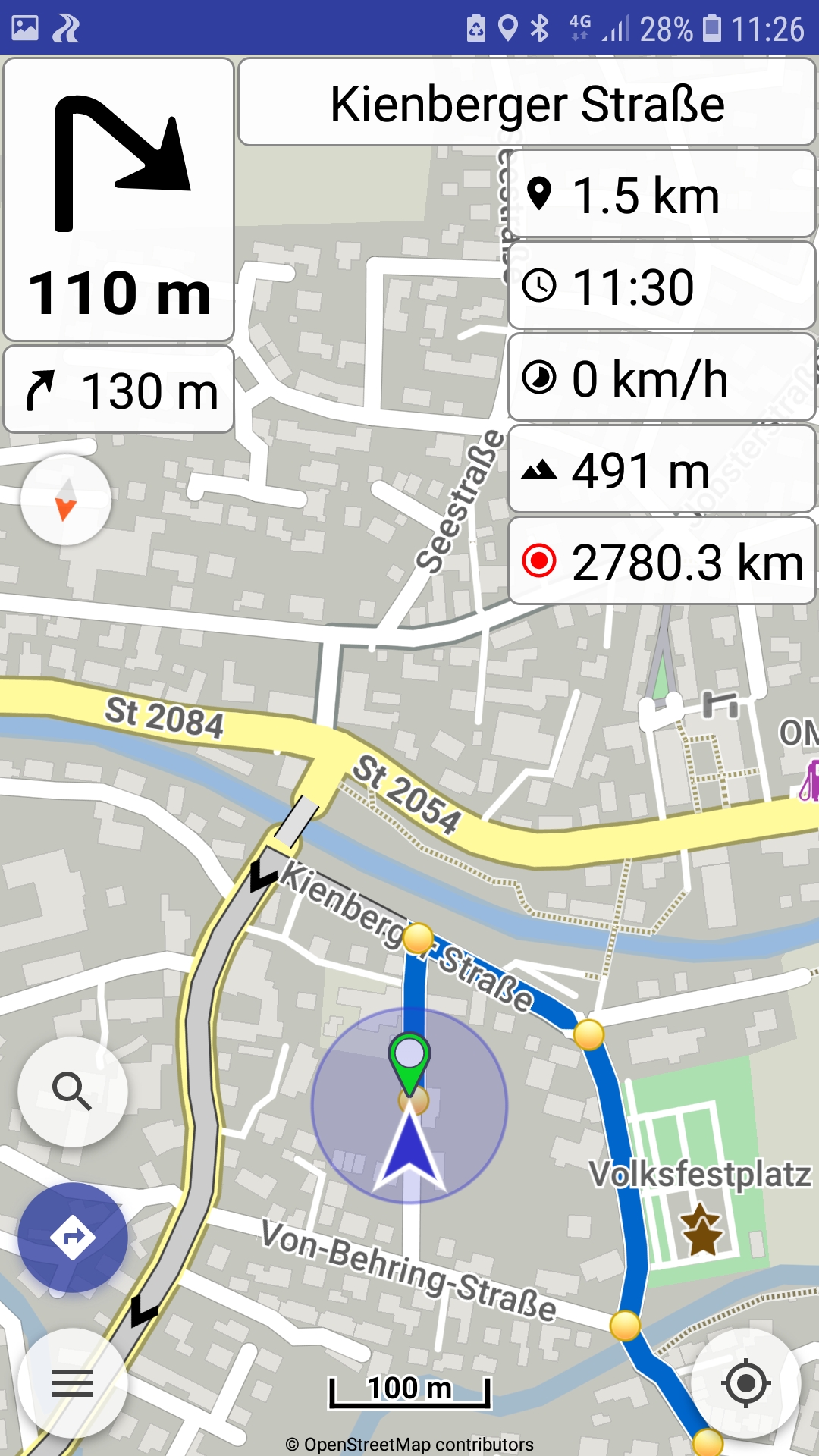

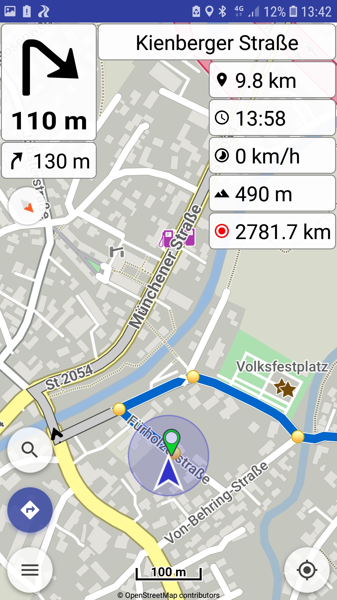

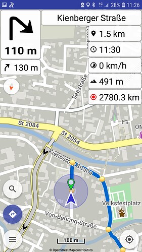

I’ve done a test with this route
Settings:
Voice instructions frequency: “After instruction points”, “1Km”, “300m”
After rerouting (right picture) I got the following voice instructions:
  • in 110m turn left
    then in 110m turn left.
  • in 110m turn right
    then in 130m turn right.

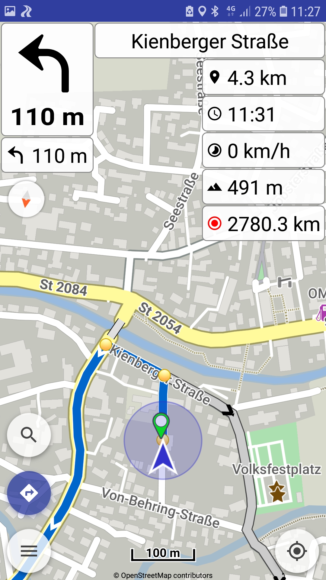

And now watch my third picture! :astonished:
There we have the “in 110m turn left”
To me this looks that the issue is related to “Routing | Options | All curvy routes” in some way.

In your 1st image, out of the 3 available “All curvy routes” had selected to navigate probably on some other than the first “Fast and curvy route”?
Then could be a timing issue, where after rerouting the instruction came immediately from the first of the 3 new routes and soon after the curvy or extra curvy was properly activated with the correct instruction.
Does that make sense?
If that is the case, I can improve the workflow.

I can reproduce the above situation (I’ve just repeated it to be sure):
Routing | option | extra curvy:
    then in 130m slightly turn right.
Routing | option | All curvy routes
  • in 110m turn left
Nothing else has changed

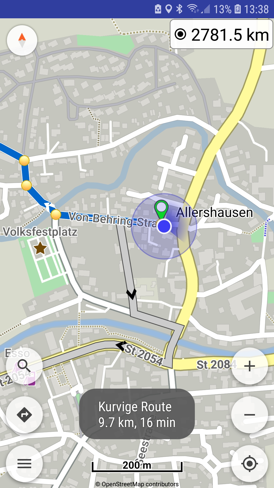

Onother test with this “curvy route”
This would be the “fast and curvy” variant at point rerouting is triggered (the grey one in the screenshots).
“curvy” is selected:
Now the rerouting:
Voice instructions:
  1. in 110m turn left
    then in 110m turn right
  2. in 110m turn sharp right
    then in 130m turn slightly right.
The first voice instruction does correspond to “fast and curvy”
The second does correspond to “curvy”
Manfred
