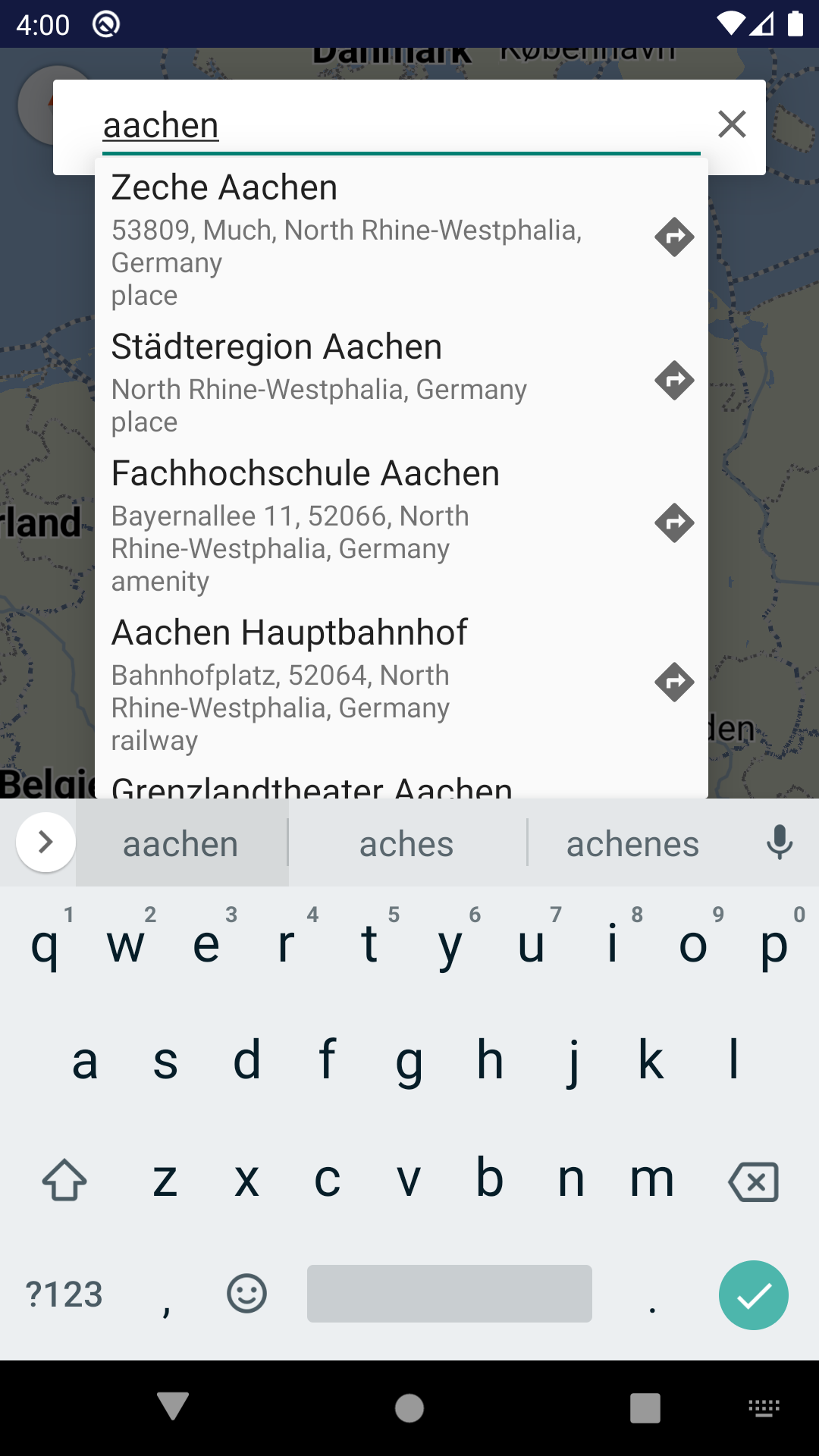

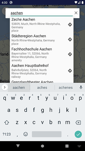

With enabled internet, it returns various results (sorted depending map position):

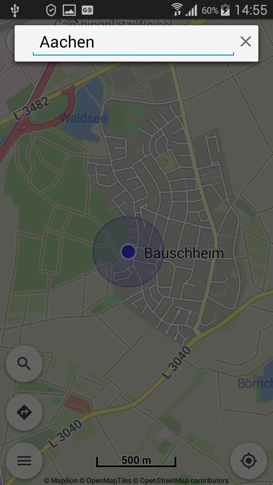

Exactly this is, what I would expect. But it is not working… See screenshot please.
Maybe interesting topic… Your input “aachen” is underlined… At my phone it is not.

My phone is a Samsung Galaxy S4Mini.

It is Android 4.4.4.
No supported by GraphHopper anymore?
It seems that some recent protocol change in GraphHopper search server, made it not working on such old Android versions.
We need to search what can be done…
Thank very much for supporting my issue. Hopefully you can find a way to make it work.
Support for some TLS versions on older Android is complicated. TLSv1 was always supported, while TLSv1.1 and TLSv1.2 from Android 4.1. But despite being supported, TLSv1.1 and TLSv1.2 are not enabled by default until Android 5!
(details in SSLSocket documentation)
Even if we enable manually those TLS versions on older Android (and we already do it), there is no guarantee that it will work with all websites which update their protocols (like GraphHopper), depending also on OEM modifications.
Fortunately Kurviger server still works. :slightly_smiling_face:
In any case Android 4.x is very old. It’s a miracle we still support it, as we will not be able to avoid increasing min requirement to at least Android 5.
