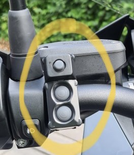

Device have 2 Button an one Joystick.
C and B works already but not with the buttons which I prefer.

Joystick:
KEYCODE Arrows Up, Down, Left, Right
Push on center = KEYCODE_ENTER
Button A:
short press = KEYCODE_A
long press = KEYCODE_B
Button B:
short press = KEYCODE_ESCAPE
long press = KEYCODE_C
All this KEYCODES are 1:1 from device without mapping from Ci Service or DMD2!

To get this events, I connected device via bluetooth and used the android app HardwareKeybordCheck. It shows nicely the output.
