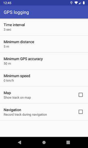

Automations usually need simple options. Like select to record track during navigation, with pause / resume, etc.
A proposed configuration for the GPS logging inside Kurviger, with each option being adjustable and having sane defaults, could be:

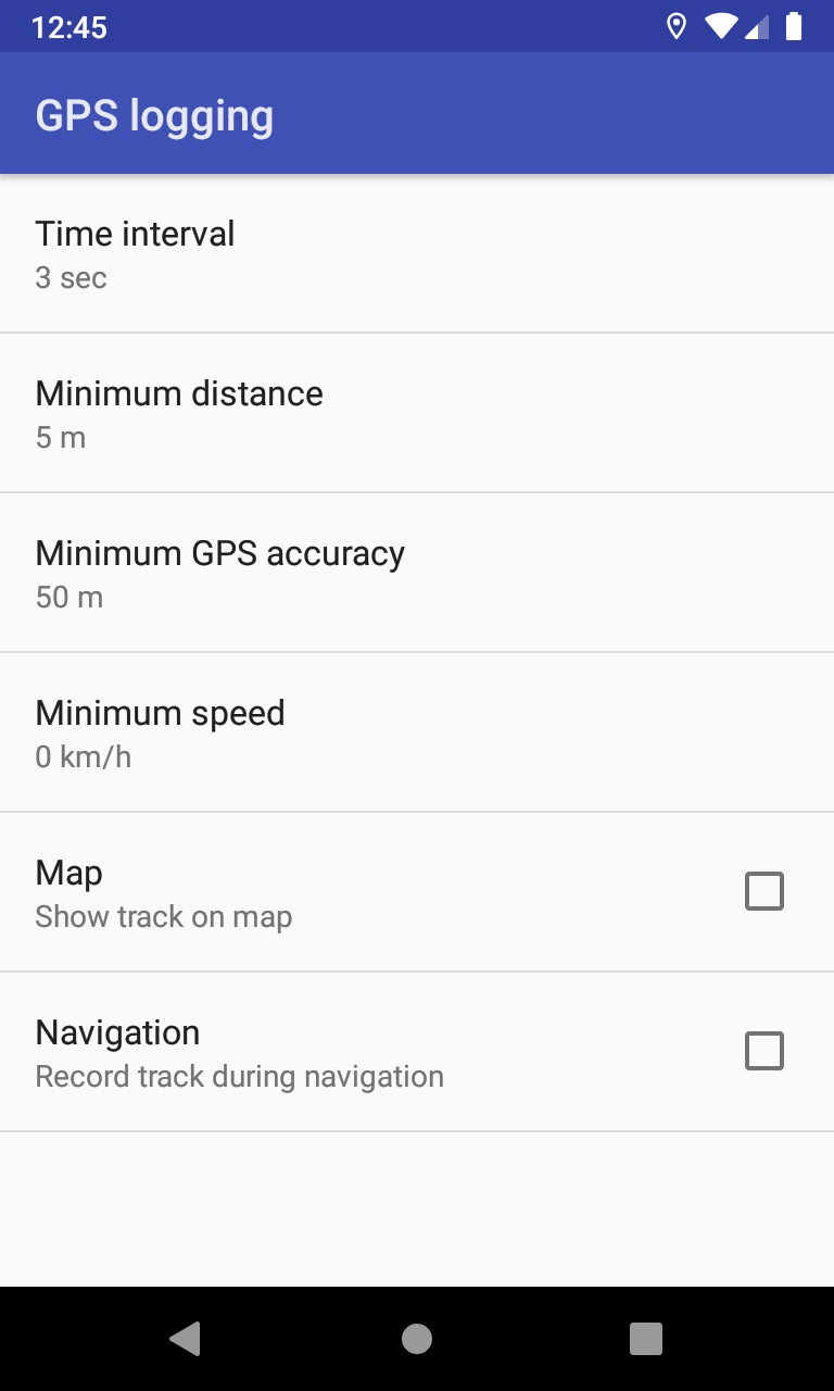

I absolutely agree with that. As simple as possible and without the need to start tracking manually.
Looks very promising! ![]()
I’m only missing an option how (and where) to automatically save track logs (e.g. once per day into Kurvigers standard export folder).
App can always know last logged track (like routing), until explicitly save it and prepare a new logging.
Do you find that workflow useful?
Also what about the various options limits / defaults?
Great. That is better than “one file per day”
What does Maximum accuracy mean?
More technical and refers to GPS accuracy, that usually the recorded locations have.
So can select how to filter the locations and keep only the ones with good accuracy.
And the speed is more a low-pass filter, if want to keep locations with movement, though distance filter can help here too.

For comparison I just checked a few of the tracks in my library.
My Garmin (Zumo 220) tracks have a trackpoint every 1-15 secconds with a distance of 0-450m between them (in fact I don’t quite understand their tracking algorithms). A tour with a length of 250km would lead to a track which has about 4000 trackpoints.
My GPS Logger tracks have a trackpoint every 11 seconds (sometimes, but seldom up to 20), with a distance of 70-450m between them. A tour of about 250km length has somewhat about 1200 trackpoints. By the way: my GPS Logger ist set to a minimum accuracy of 40m.
My GPS Logger tracks therefore have significantly less trackpoints, but this really seems to be enough for archiving and documenting droven tours.
So I think your default options are suitable. Maybe the time interval could be longer (e.g. 10 seconds) without loosing track quality but having smaller log files.

Typical motorcycle speed is 3m/s to 30m/s. (~ 10km/h - 100km/h)
So every 3s means 1 trackpoint every 10m - 100m.
Seams reasonable, but even 10s is fine.

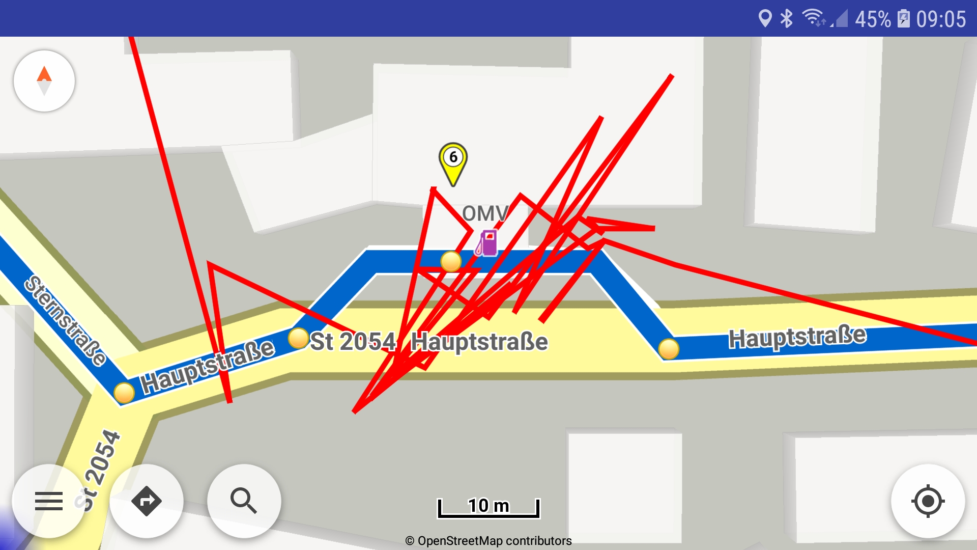

To prevent logging multiple points while standing at the same place.
I would increase it to at least 10m
Here is a real world logging of a stop at a gas station.
To prevent logging of obviously incorrect values.
Seams reasonable.

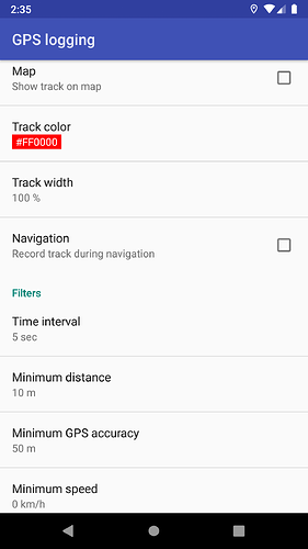

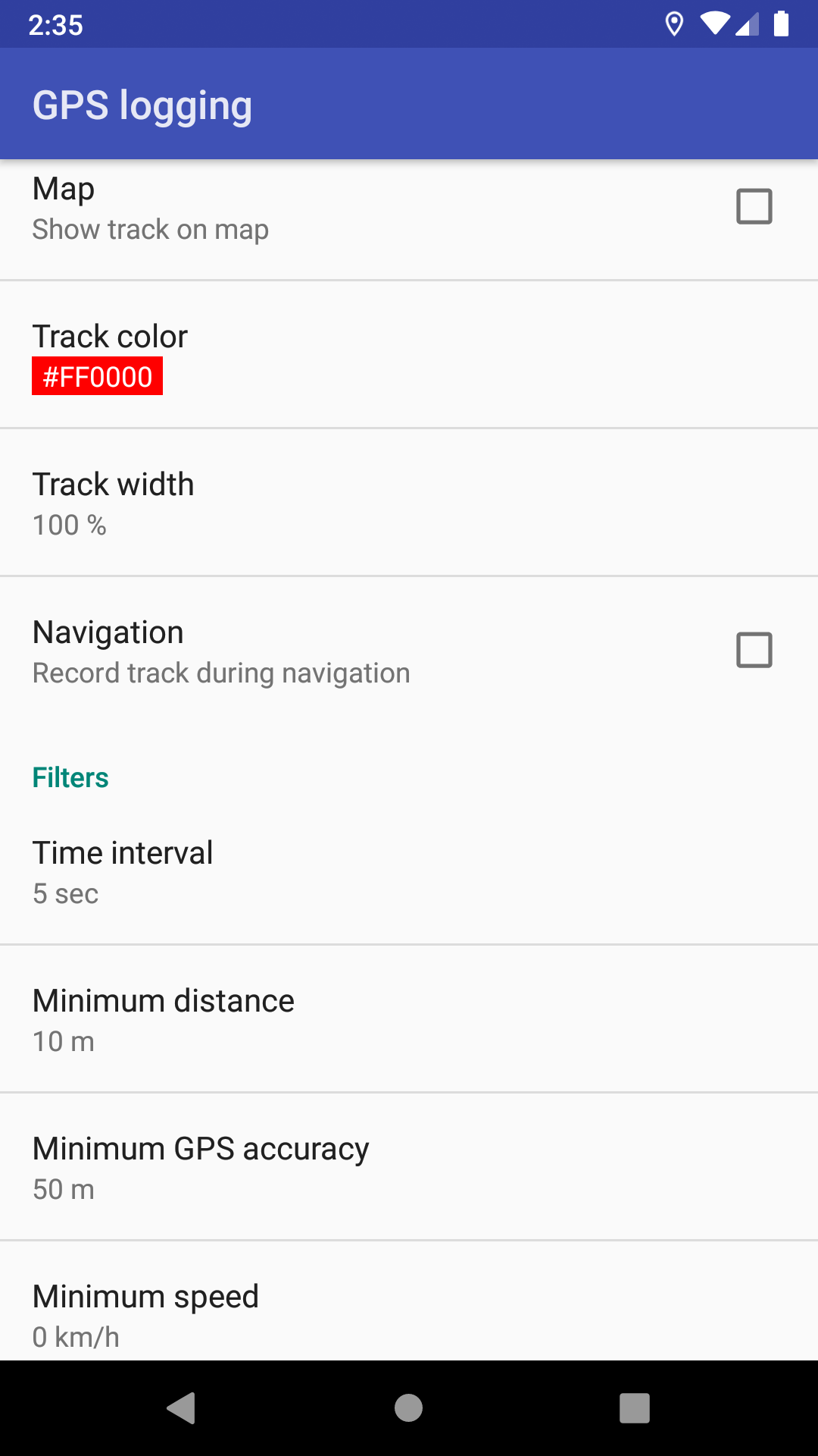

GPS logging settings with defaults:
Look perfect. Even with luxury options like color and track width! ![]()
I’m really looking forward to this future version.
Implemented in Kurviger 1.9.3.
