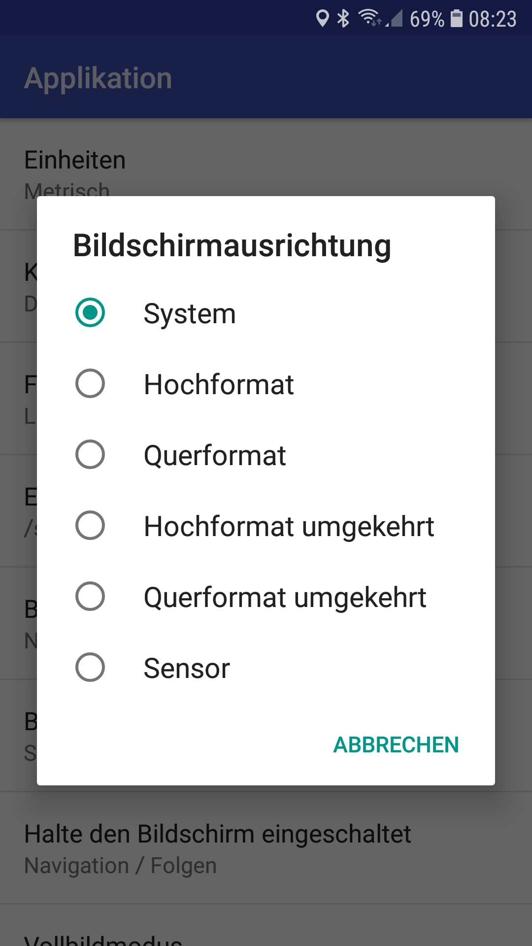

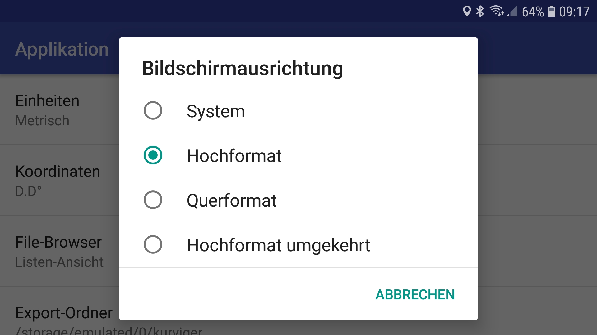

  • There is the “Settings | Application | Screen orientation” where
    you can select which screen orientation you want to be applied.
    (like before)
  • There is the “Settings | Application | Screen orientation mode”
    where you can select at which mode the orientation is applied.
    (Navigation / Follow is already default)

Well, the functionality is ok.
But I doubt that people would understand, that this setting is actually correct:
At least I needed your explanation above too understand.
There is nothing to understand, just select the preferred screen orientation like before.
Things are simple, screen orientation is not a boolean, but has 6 options.
So its application has 3 states and all these can be combined separately.
Jetzt habe ich die Funktionsweise verstanden. :sweat_smile: ich muss die Bildschirmausrichtung vorwählen zb Querformat und diese wird dann im Navigation/Folgen gesperrt. :smiley: ich denke das könnte zu Verwirrungen führen. :thinking:
Now I understand how it works. :sweat_smile: I have to select the screen orientation zb landscape and this is then locked in the navigation/follow me. :smiley: I think this could lead to confusion. :thinking:
Why, what have you done so far?
Only screen orientation need to be changed (like before).

Bisher war meine Einstellung System bzw. Sensor, damit funktioniert aber die Sperrung nicht. Vielleicht sollten diese Beiden entfernt werden? :thinking:
Up to now my setting was System or Sensor, but the lock does not work with that. Perhaps these two should be removed? :thinking:
So you use Android system settings and not select a lock.
How do you expect to work, unless select an orientation?
“Sensor” tries to override system limits (by OEMs).
(for details check the related feature topic)
“System” is default and does not cause any trouble.
(like most users expect the app to work)
