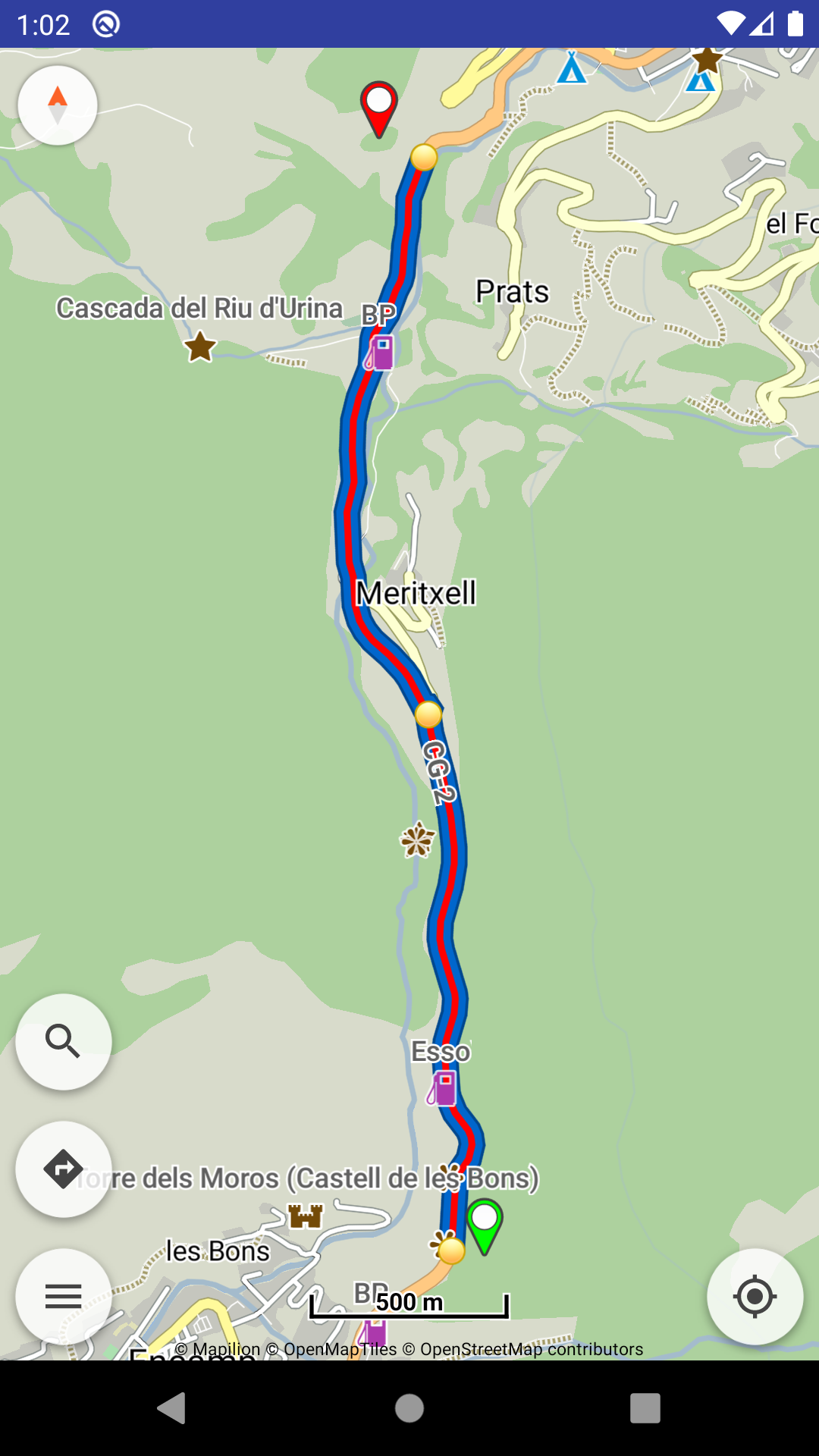

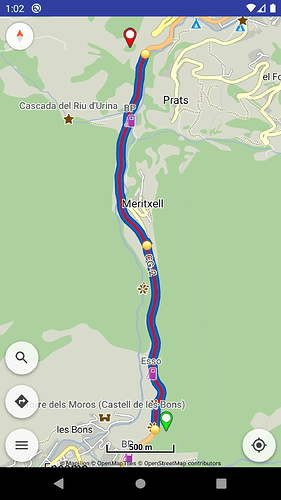

In next version you can open kurviger files with all modes:
  • Overlay
  • Routing
  • Overlay + Routing

Another useful workflow is to import a kurviger route as “Overlay + Routing”.
And make changes on the route, while keep the overlay on map as a guide.
