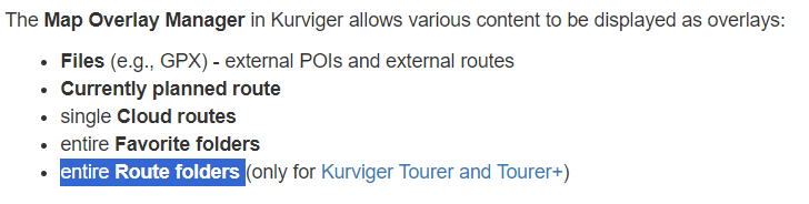

This is already possible. Map Overlay Manager [Kurviger Knowledgebase]
But not for tracks:
Ah, ok - I have possibly misunderstood. Not Kurviger-Cloud-folders, but folders from file-system. Thanks for your note.
